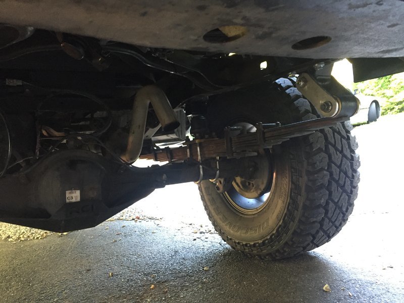

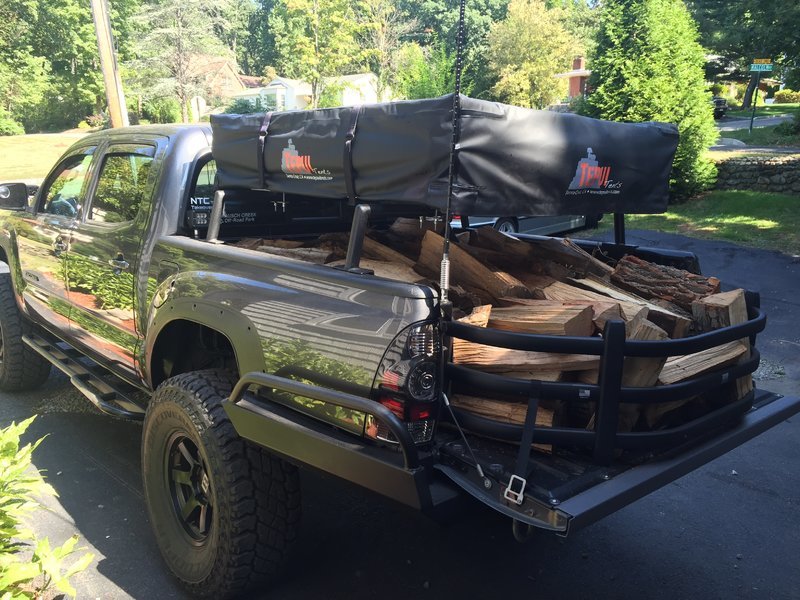

    45* setting with Dakars and a good amount of weight in the bed. Just for reference.
    The Ruggedized RTT weighs in at 180 lbs. the wood is 90% cured oak.

    Thanks for the pics, that's solid for a considerable amount of weight
