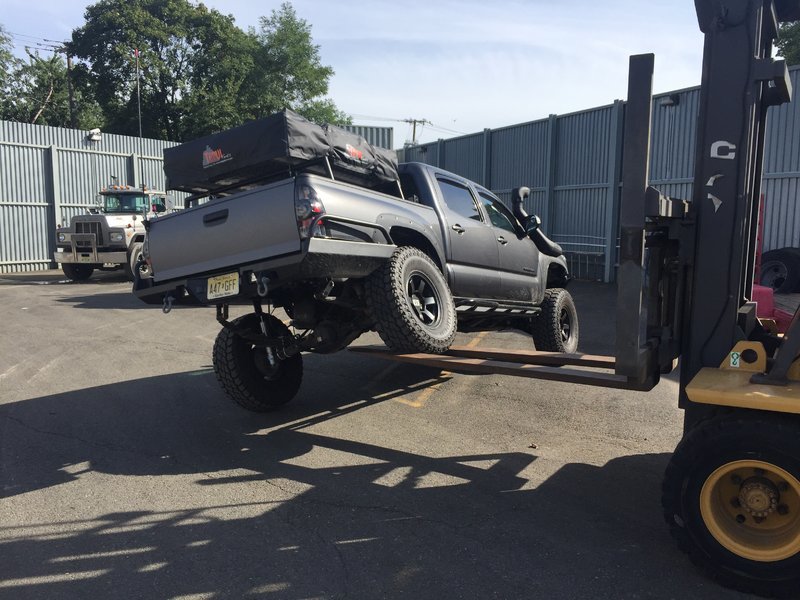

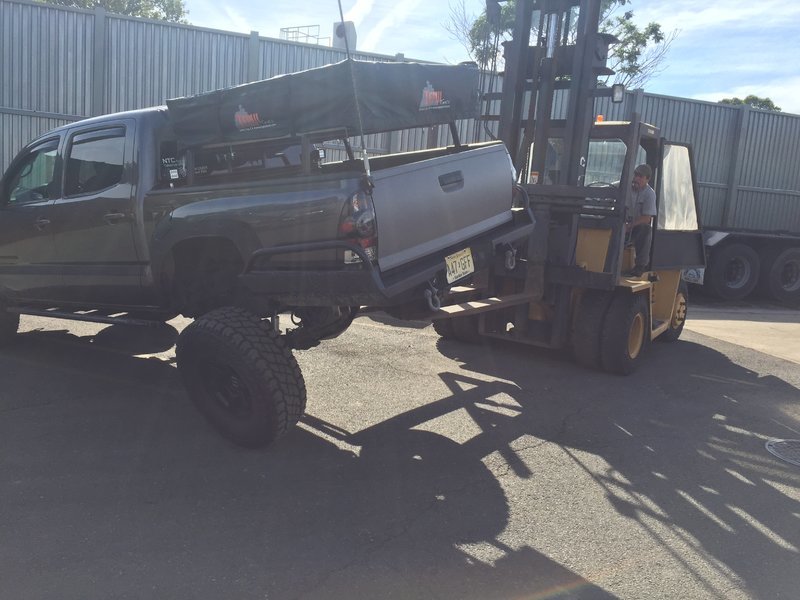

    Did a little more forklift flexing, and measuring yesterday. Then, after talking with Eric on the phone, decided to remove the bump extensions.

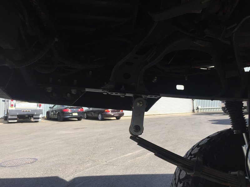

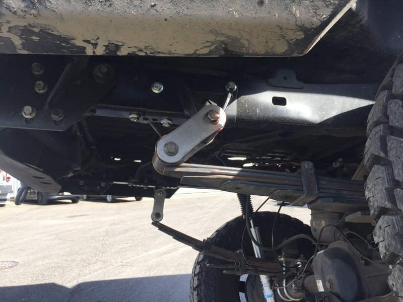

    I just had my first customer with extra capacity Alcans and they seemed to work out with same shackle angle as AllPro's
    The first pic here is of the Alcans and 4" stainless shackles showing a solid 30 degrees in rearmost position, so the middle position would set angle to ~45 degrees, so you would use the factory rivet holes for 30 and 45deg.

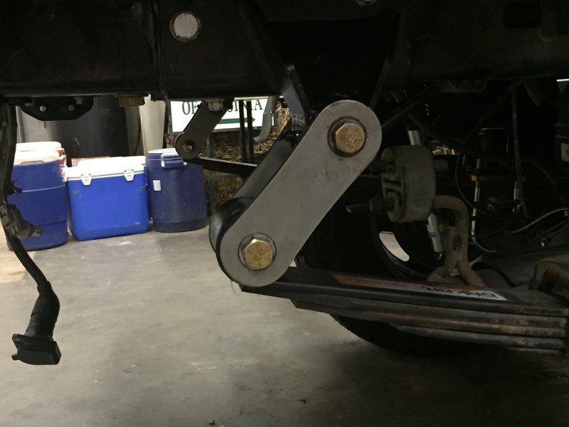

    Cory wanted another 1" of lift, so he is the first to install my 6" plain steel shackles, the second picture
