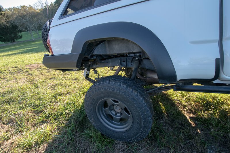

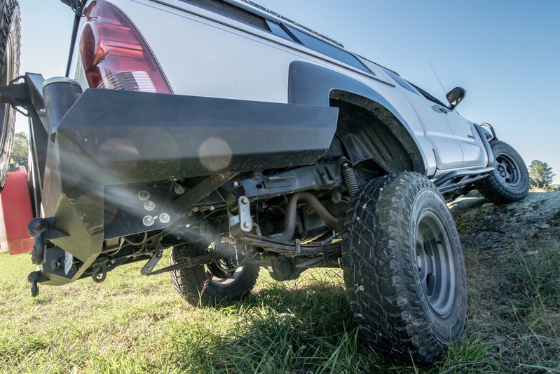

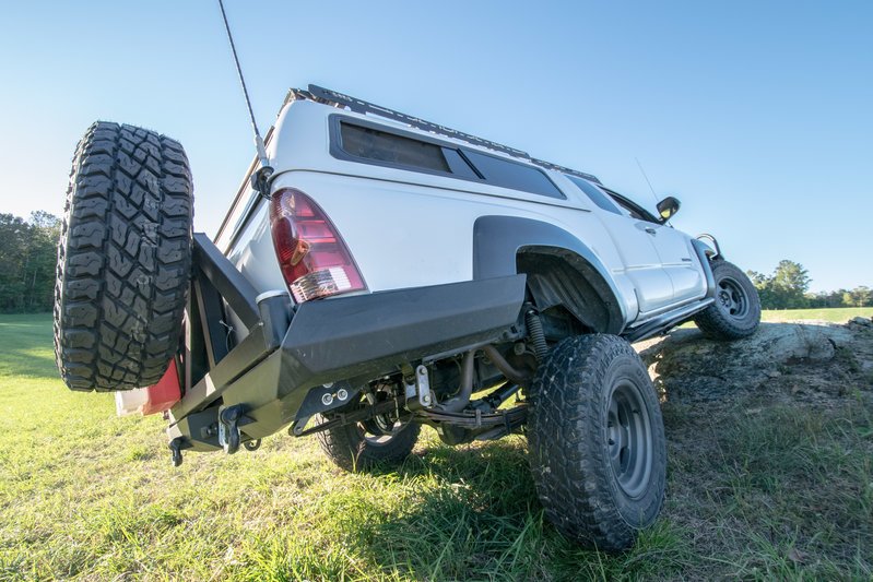

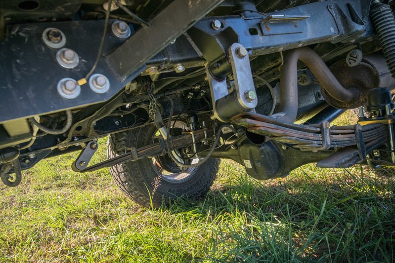

    This kit with a shock relocate has some serious droop! Bout an inch of downtravel left, tire still on the ground
    5" up travel, 7" downtravel. Thanks @ARCHIVE, loving it :yes:
