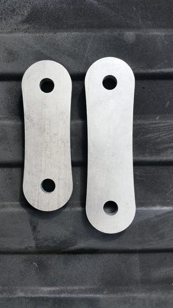

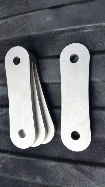

    So 5" stainless shackles are now available as an option when purchasing the shackle flip kit for $20 more, or separate from kit as well.
    That's 3 shackle options to choose from: 4" SS, 5" SS, and 6" plain H shackles
    The longer shackles will help expand the range of motion with this kit.
