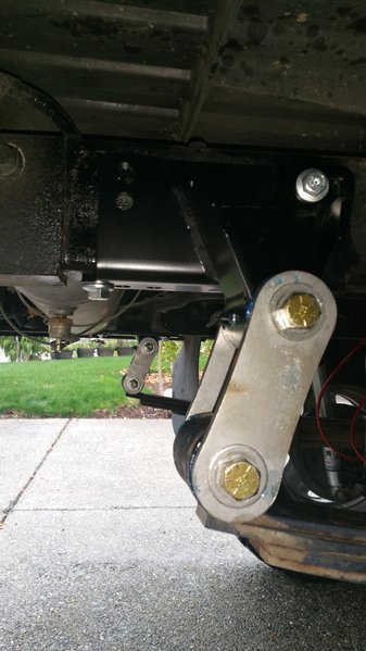

    So my shackle is inverting at full droop. OME Dakars. Would my best bet be to move the bracket forward and dril alll new holes?

    Yes. Drill forward 3/4" to 1" and you'll benefit a lot. It will sacrifice some lift, but will optimize your use from the shackle kit.

    The truck looks great, and your shackle going past vertical isn't a terrible situation, but drilling the new holes for 45 degrees does seem to be working out well for Dakars

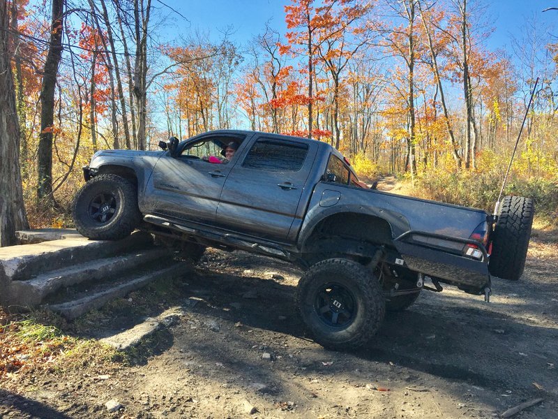

    Just a little droop pic with a little in reserve.
