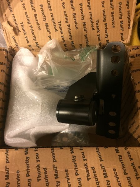

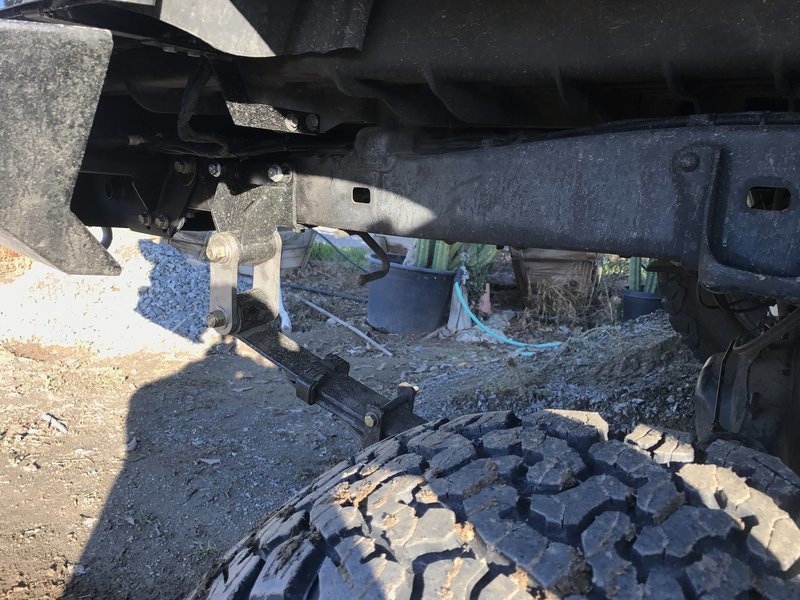

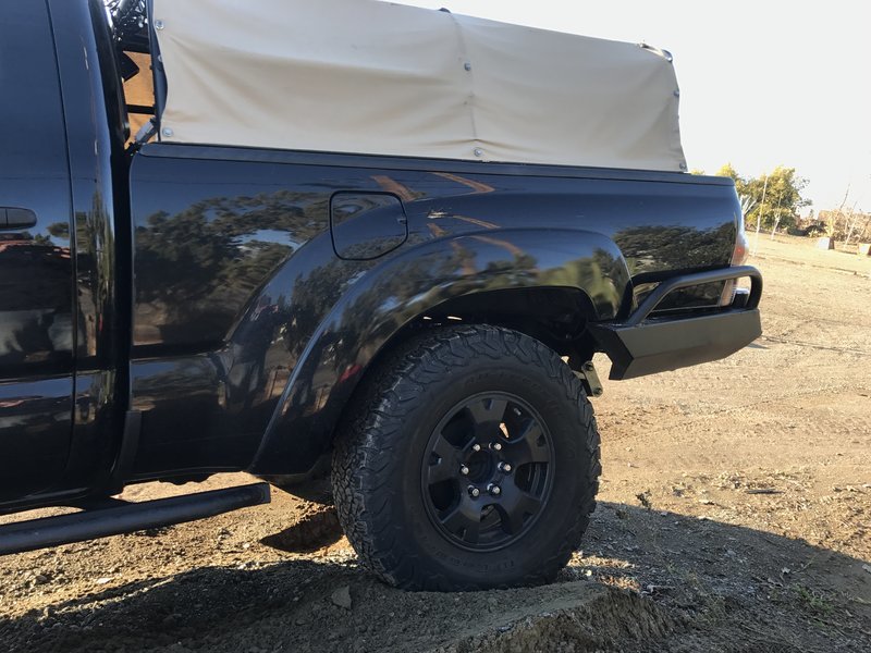

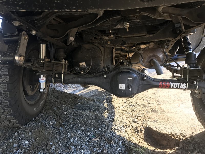

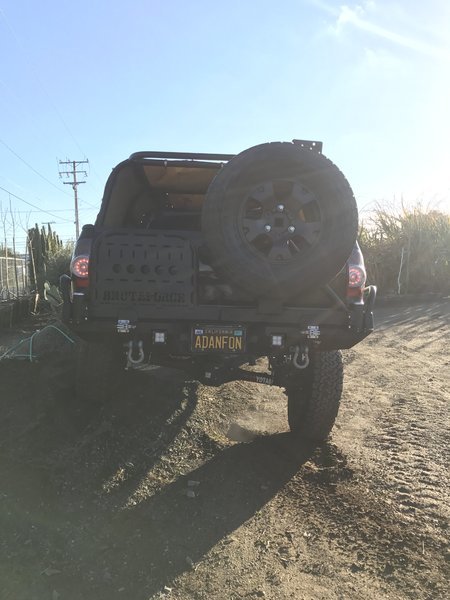

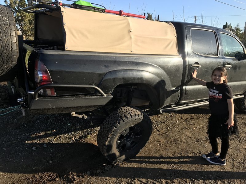

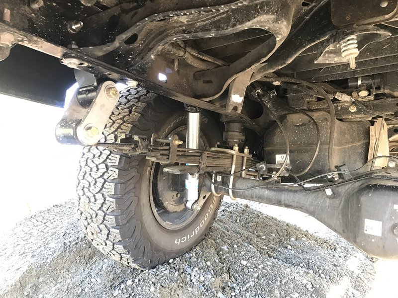

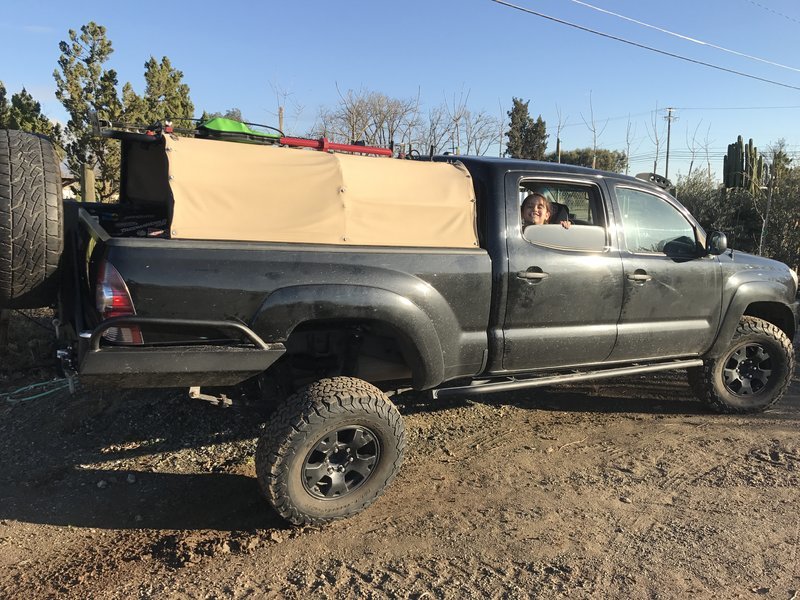

    Eric's customer service is top notch! He answered all my questions prior to purchasing the kit. So I got all the correct parts I needed, to make the install relatively painless. I installed the longer brake lines a few weeks ago, and the other night a buddy and I tackled the install the night before I installed my high clearance. Install took a few hours, about 3.5, and the hardest part was the rivets and lack of space. After the install I realized my shackle angle wasn't correct and messaged Eric for his advice. Within an hour he responded and mind you this was about 10:30 pst, I believe he's in New York!? I was shocked, but he informed me, that in fact, my hanger was in the wrong location. So the next day I moved it and drilled the required hole at work, and in retrospect I should of done it at work. It's a lot easier drilling the hole and moving the hanger while standing than laying in the garage in the winter and 9 pm. Anyway super happy with the kit! Now some flexing pics! Haven't taken pics of the shackle angle while not flexing as I'm waiting for my jerry can holder for my swing out.
