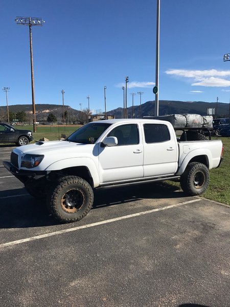

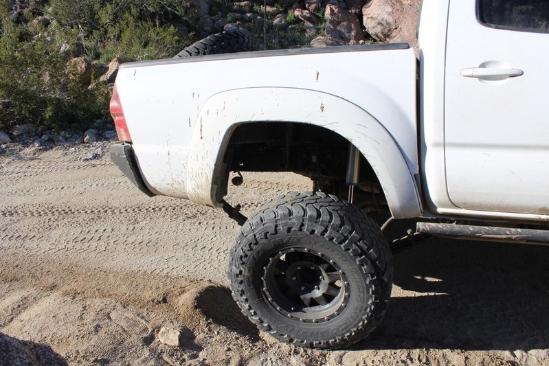

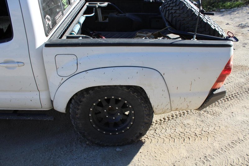

    My customer Alex @twf007 has been very helpful in getting some testing and miles on the Archive shackle flip, Archive SUA conversion kit and Deaver U539/540's.
    http://archivegarage.com/products/deaver-u539540-pair
    The combination is working very well for him, he is very pleased with the setup in all respects.
    Alex, an engineering student, installed 2.5 × 16" King smooth body remote reservoir shocks with his own bed cage. It appears he is pulling about 13"-14" travel, slightly limited by his stock rear fenders, which Alex is going to trim up soon.
    He's got the truck fitted with the RT tent and will be enjoying and wheeling in Moab, and I look forward to getting a report on how it all works in that environment.

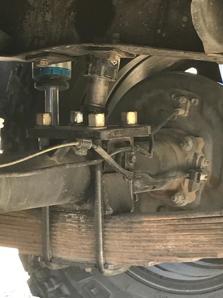

    That's from a designer ---> Archive :thumbsup:
    Off the shelf Deaver U539/540 springs which install in stock hangers.
    Archive Shackle flip w/5" shackles. It does require drilling new holes to move brackets forward. But I have instructions and holes in brackets that help facilitate
    Archive SUA conv. kit: perch, plates, ubolts

    The U bolts are trimmed and I also supply top-lock grade C (8 equiv.) stover nuts.
    I know Alex has 1.25" spacers
    You would need a wheel with 3-3.5" backspacing without a spacer
