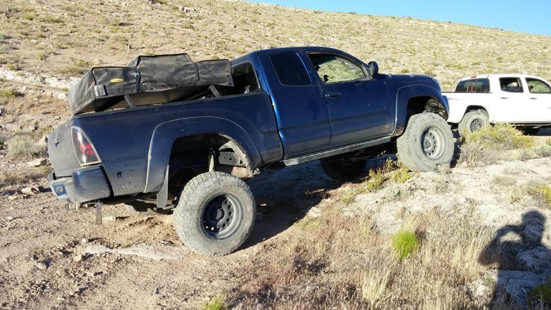

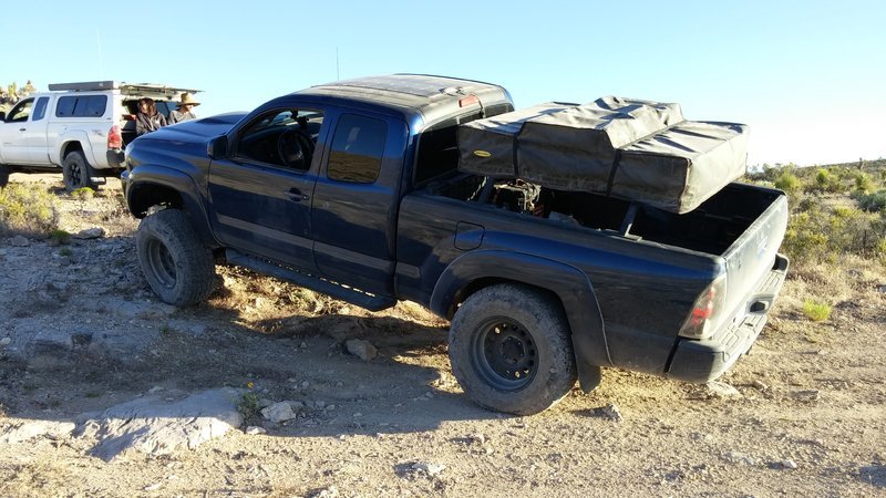

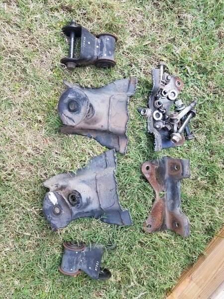

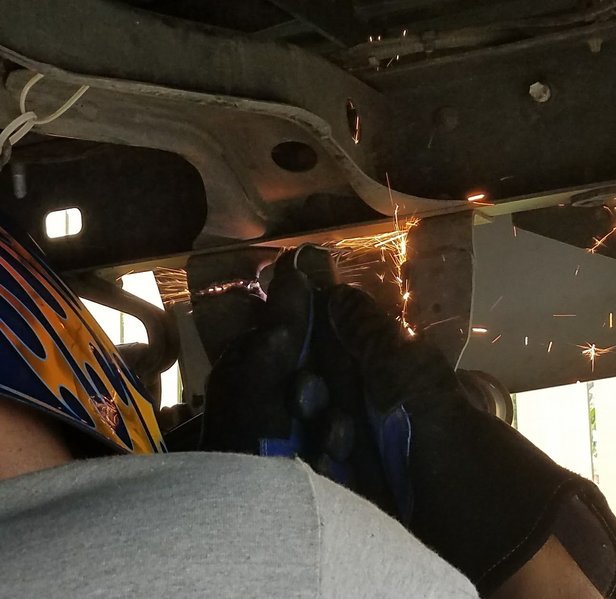

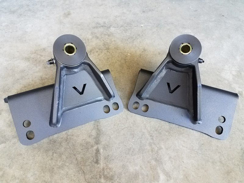

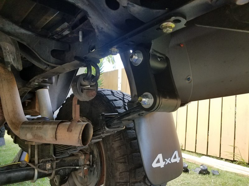

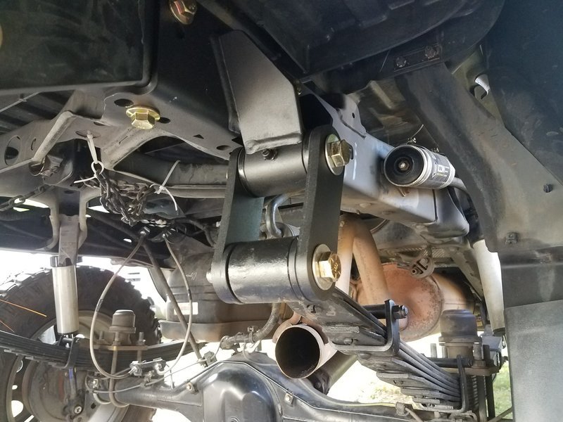

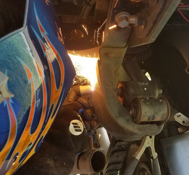

    Chopped off the stock shackles and installed the Archive Garage shackle kit 4". Nice to have friends with a plasma cutter cause it was hella easier to get the damn rivets out after dicing off the stock shackles. I like the look and I got about an inch of height with the combined All-Pro standard springs and Archive kit. About 3/4" higher in the rear of the front right now. Perfect...
    Here's a few pics of the carnage and install:
    The Archive Shackles 4" (I painted them black even though they now come zinc coated) Love the greasable bushings:cool:
    My buddy Luka plasma cutting off the old brackets prior to rivet removal. I highly recommend this before trying to get a grinder in there as there's almost no space to maneuver.
    Here's a view of the installed bracket with the new All-Pro leafs...
    The carnage...:rofl:
    Vanguard, seoulja99, Dogg23 and 7 others like this.

    Looks awesome.
    I just plasma out the rivets. Saves some time and now I have two sets of stock hangers.

    That method was discussed during the install, but I was concerned about the misalignment of the hole by blasting through with the plasma.
