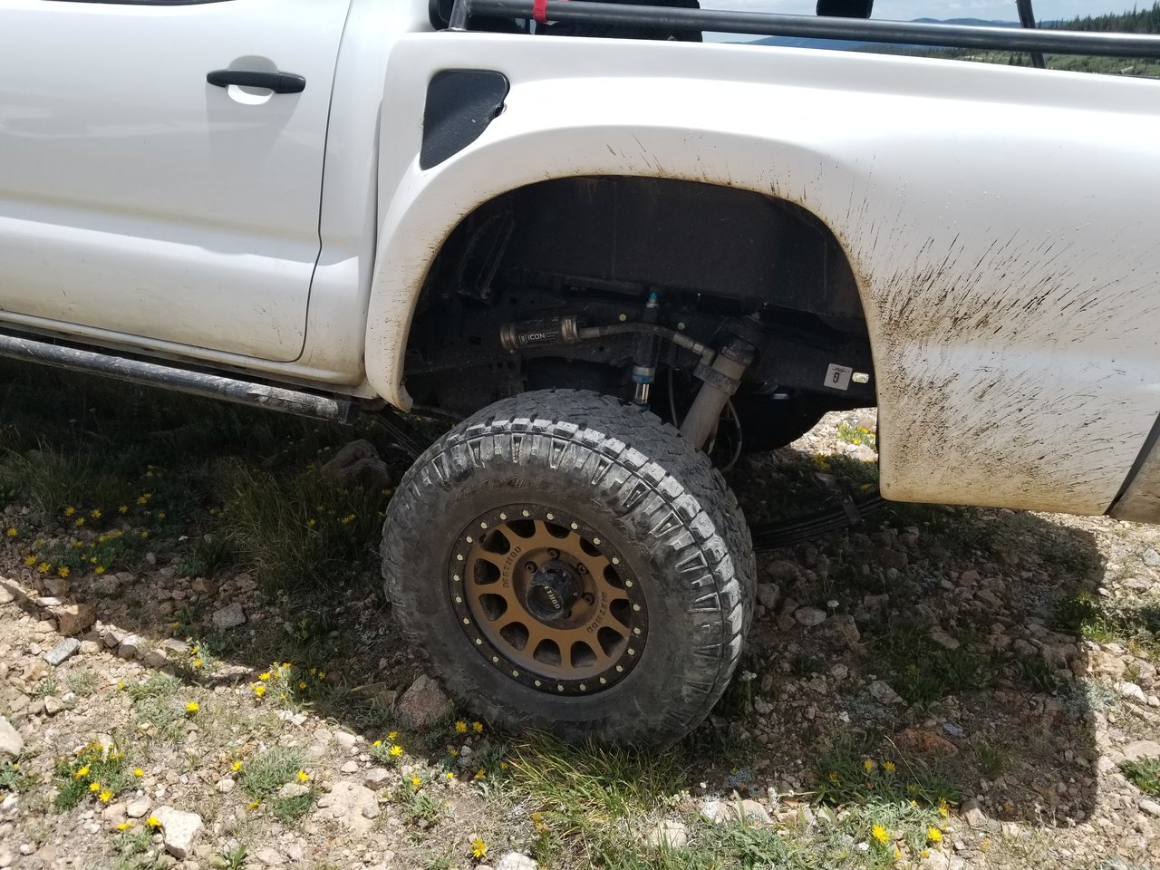

    Ill have a full build thread coming soon but Im running the flip with the SUA and Deaver springs. So far I'm very happy with the set up. There was a little learning curve with the hanger placement after install but the customer service from AG was AMAZING. He called me on a Sunday morning and helped us work through some issues. Here are some pics of it flexing a little while out on Tuesday. Right now the limiting factor is the shocks as I wait for my 16's to arrive. Its hard to see but the shackle on the extended side is about a 75-80* angle and on the flexed side at about a 35*, a little more than an inch from hitting the bump stop still.

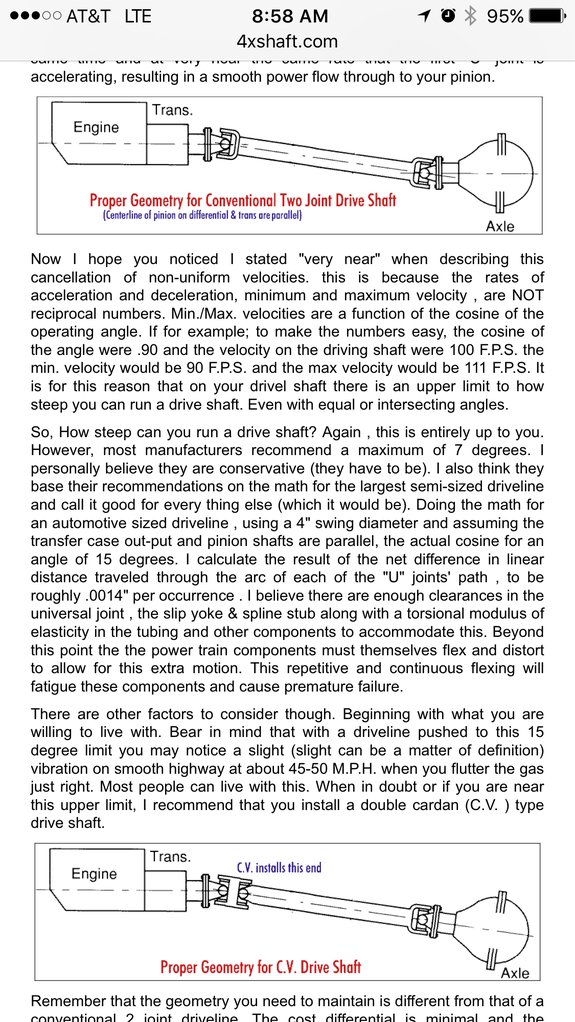

    Would anyone happen to know how many degrees I could expect the pinion to rotate up with this kit and dakars? Probably a very specific question but I have a one piece driveshaft with a cv joint in the front and so i need it set up like the second picture and it is currently set up like the first picture

    I have not measured on a vehicle, but figuring with help of a drawing, the kit with 4" shackles would add an estimated 3 degrees of pinion angle.
    With somewhere over a hundred kits out there now, I've not had a single complaint of driveshaft vibration.

    Thanks man. I will probably be in touch soon. I already have a 3* shim in the leaf pack but it's not enough. Also this gives me a good excuse to build the rear better. The way my driveshaft is set up even with stock suspension it would have bad vibes. The cv shaft is great but it has to be set up properly.

    Good to know on the CV equipped driveshaft, thanks for posting the difference

    Yea this picture helped out a lot. A standard one piece the transmission and the pinion must be parallel. With the cv the driveshaft and pinion must be in line. IMG_4769.jpg

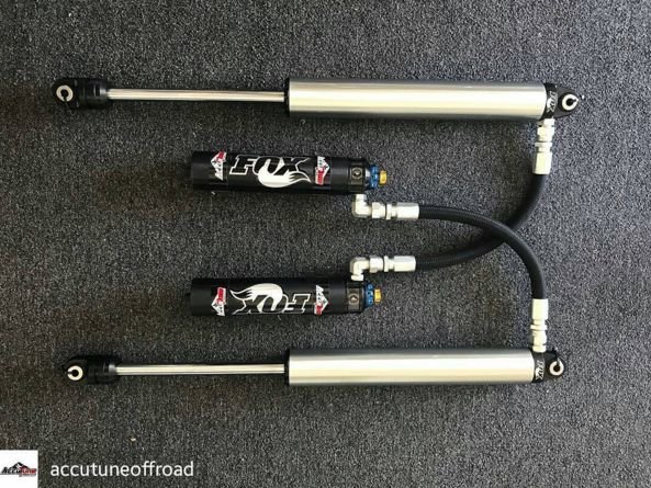

    If anyone needs shocks for their relocation, or front coilovers, or rebuild and tuning, please contact Ryan or Andrew at AccuTune Offroad in Carson City California at 424-377-0808.
    Ryan has experience as a shock engineer, and real world tuning experience, just check his Instagram account @accutuneoffroad
    I am working with Ryan on Fox shocks set up for this relocation. He may offer King as well.
    He currently has 2.5"x14" and 2.5"x12" Fox Factory series with DSC in stock, custom valved to your set up, and you don't have to wait 4-6 weeks.
    He also has 2.0"x14" in stock, and can ship them with 1.5" rodends, custom valved to your set up.
