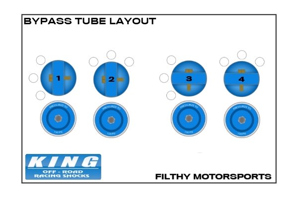

    If you buy your bypasses with the tubes laid out correctly for the rear of a Tacoma the clearance difference would be neglagable between the shock and the tires. The only place you'd have to look into would be the clearance around the upper shock mounts which I'm sure Eric could answer.

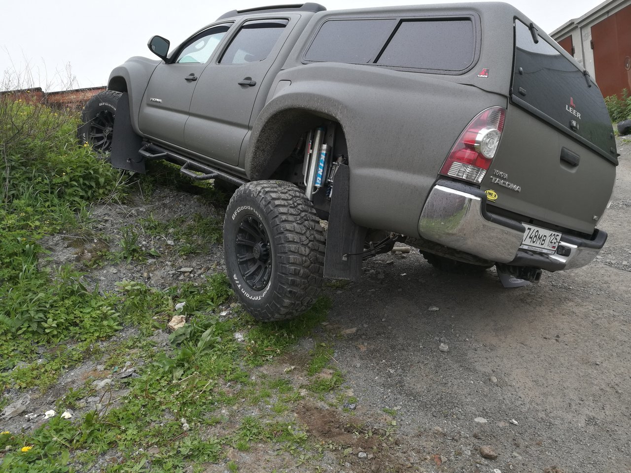

    Yeah one has the King 2.5" x 14" twin tube bypass with tubes facing forward toward engine. REQUIRES REMOTE RESI, pic was prototype tower with smaller rear rib.
    Owner: Mikhail from Russia

    You'll want king bypass layout 2. I always use those on under the bed shock hoops. Last truck I did didn't require wheel spacers but it was more of a desert truck. Extreme flexing would require use of a 1.2" spacers. Wheels were 17 with a backspace of 4.5

    Careful saying layout 2, Downsouthmotorsports.com has a different layout number from King standard, and possibly Filthy Motorsports, which totally irritates me, its also might be different with 2-tube and 3-tube, so for me it's just:
    "Tubes forward towards engine" for the newbs
