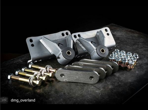

    Great picture by my customer Will, Instagram: @DMG_overland aka @willstricklinphotography
