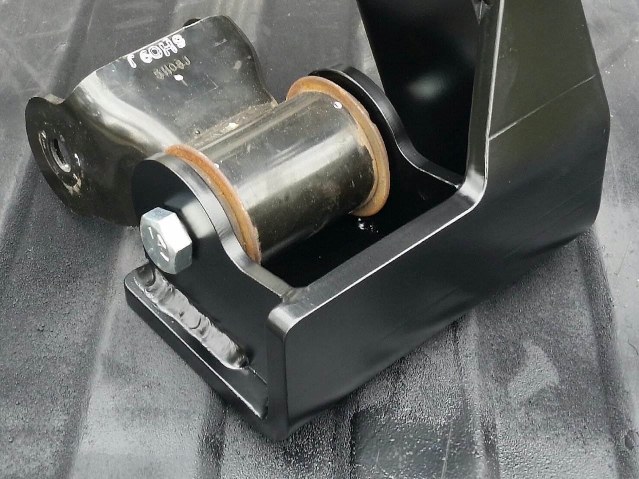

    This pic shows the new hangers with stock shackles almost fully laid down in full droop scenario. If you need more information, go to my website and call me Monday

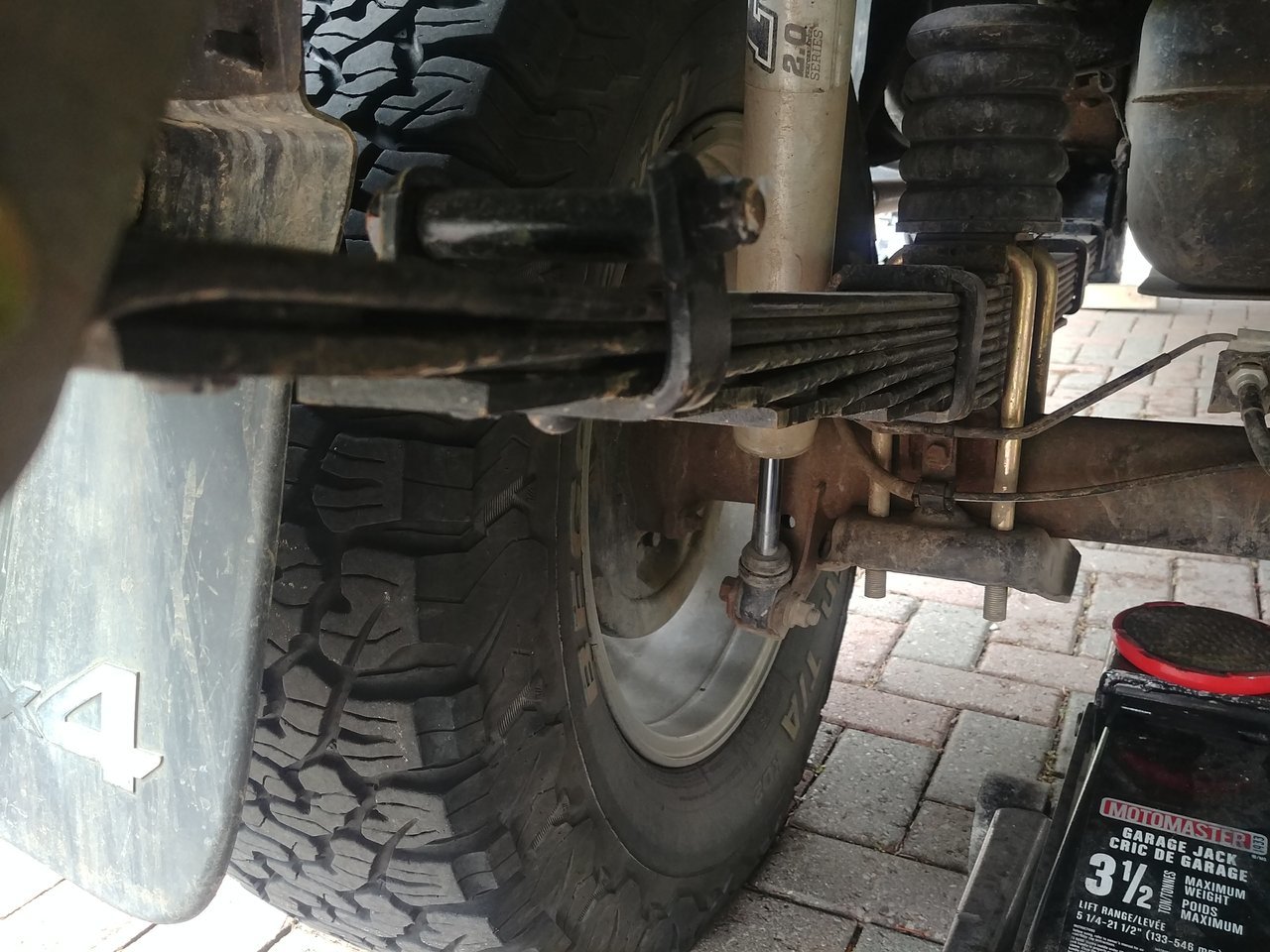

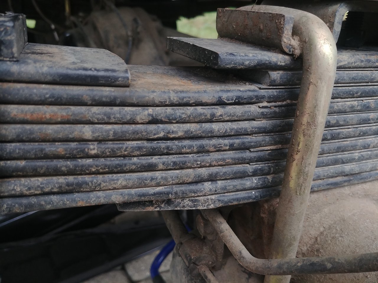

    May have been a shitty leaf but I snapped a brand new allpro expo this weekend. I think it was the length of the shackle. (5")

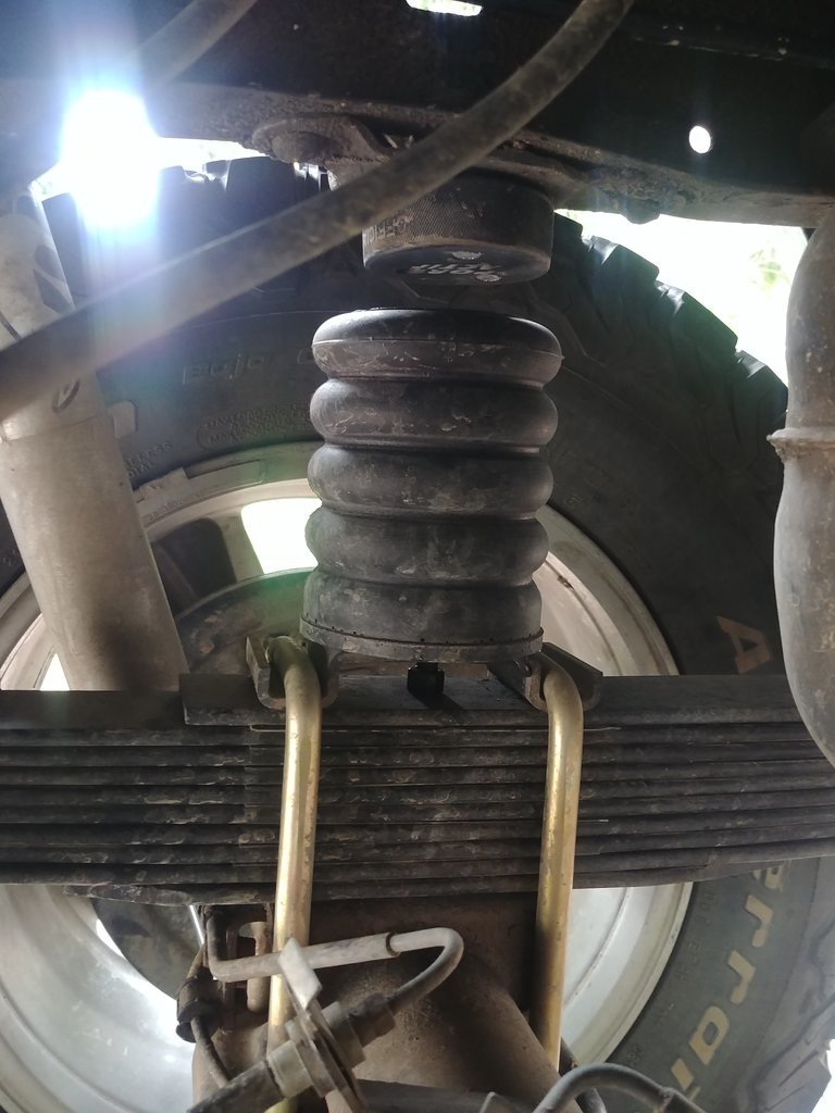

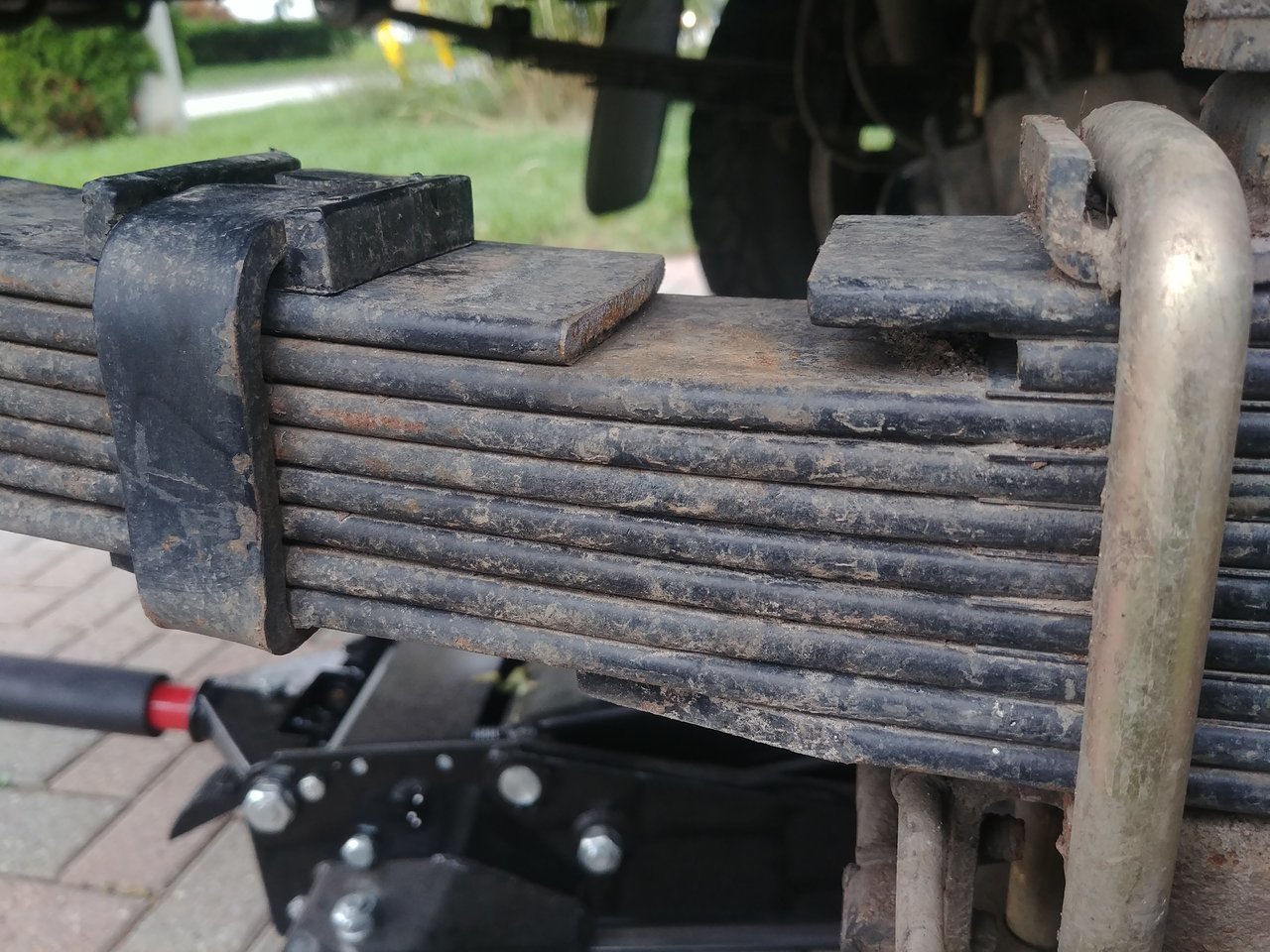

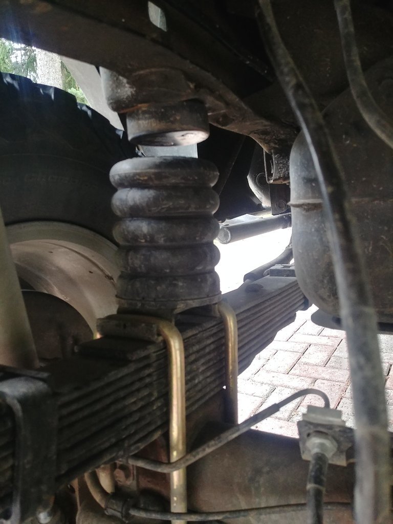

    Until I can hear from someone with the 5" shackle and allpro expos I'll be running the 4" shackle. Under compression and weight the leafs look stretched. Main leaf snapped from tension.
    In no way trying to shit on your product @ARCHIVE. Just sharing my experience.

    They compress to 3" at 1500lbs. Tundra sumo springs.

    What am l doing wrong then. Shackle is set in the foremost position. Axle is able to uptravel 3.5 - 4".

    He already has his "bumps" spaced down with hockey puck, I think he has done everything right. One thing to note is, the spring would have to go negative if he had stock bumps, just like the stock spring, even with stock hanger. With the Sumo springs, I doubt in unloaded condition, it would go very negative even with the shackle flip
    It doesn't matter what spring over pack you have, the main leaf always goes the same negative amount between the manufacturers.
    Yes he changed the hanger to flip, but he spaced his bumps to account for it
