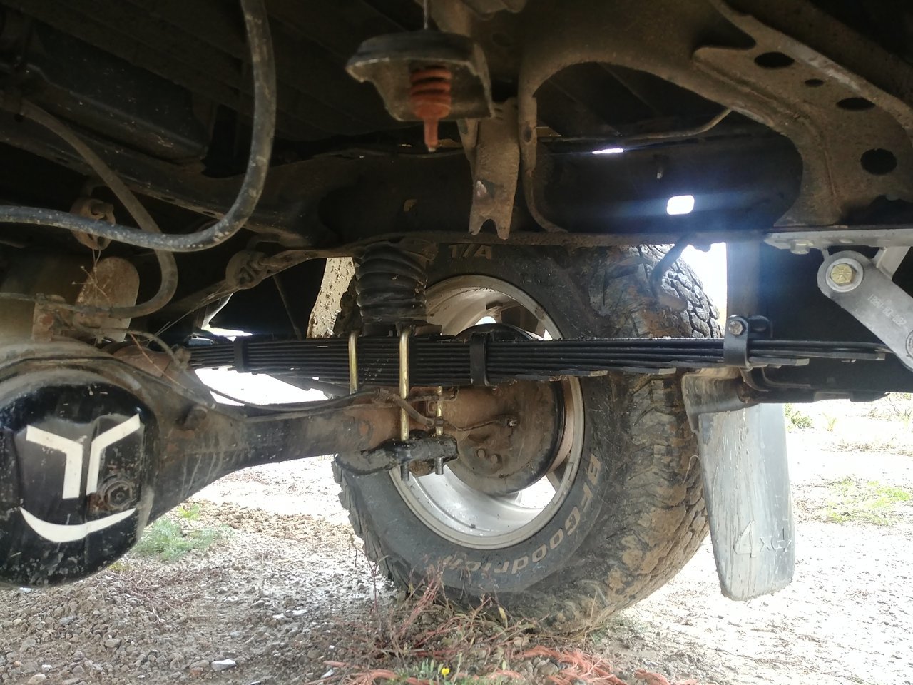

    The break happened with about 300lbs in the back going down a rocky area while wheeling. I thought I had taken every precaution. Never imagined a fucking leaf would snap.

    So my question is again, what is wrong with my setup that is causing the leaf to flatten/have so much negative travel?

    Do any of the spring mfgs say, "Space you bumps so it won't go negative"? I doubt it, they are all designed to go negative, that is just a fact of the spring over on The 2nd and 3rd gens. Try it on your new springs Joe, same thing.
    My opinion is the All Pro springs are compromised quality, that is based on my customers reports and a reliable source of further information.
    ALL PRO are imported from China.
    Also, every spring mfg can and has had failures, its part of modding trucks, so people should expect it, even the stock Toyota springs were breaking on stock commuter trucks!

    I don't like pointing out negative aspects of other suppliers, but All Pro made their own bed, how do they build springs so affordably, I think we all know.
    So the situation is @Thyces broke a brand new spring at a point of high stress at U-bolt. My opinion is it would have broken regardless of stock hanger or shackle flip. I do acknowledge the shackle flip puts some extra force on the springs and if you don't space the bumps it causes more negative arch.

    That's what I mean.... I'm leaning to a shitty leaf + stress from the flip as the culprit. I hope this doesn't happen again as this was the second 6.5 hour drive to a location to not be able to wheel.

    I'm thinking now.... This pic is stationary. If on the rocks that bumpstop slipped, it would allow for way too much negative arch.

    So I'll have to imagine it was that the leafs had a defect which may or may not have been amplified by the flip + longer shackle.
