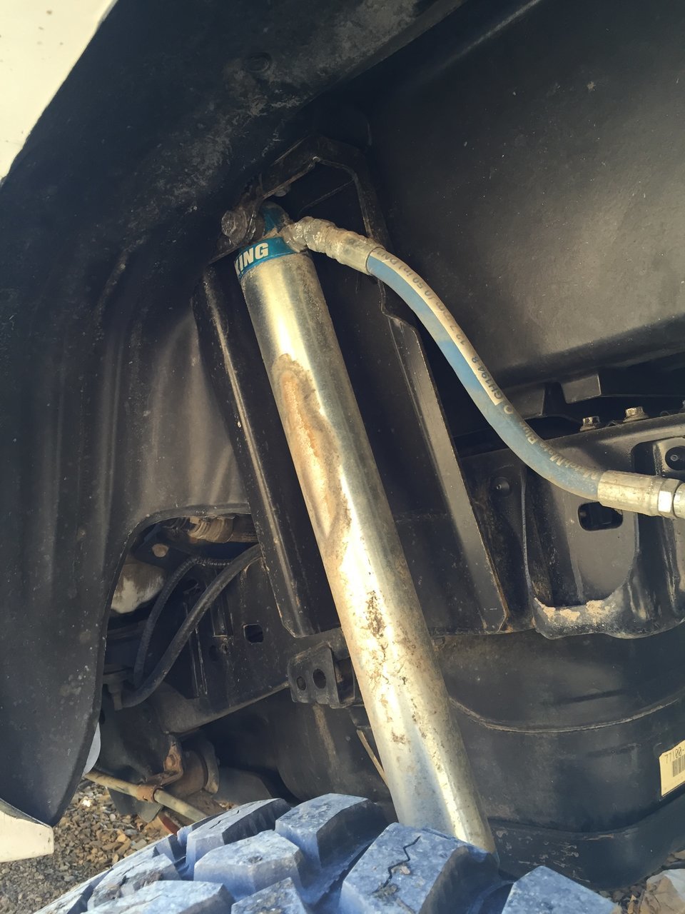

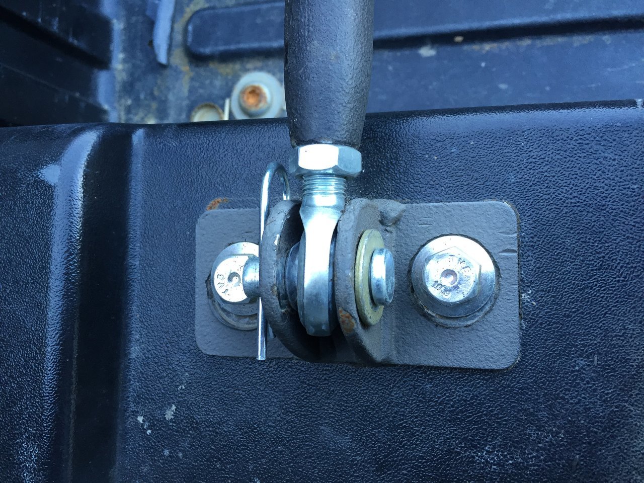

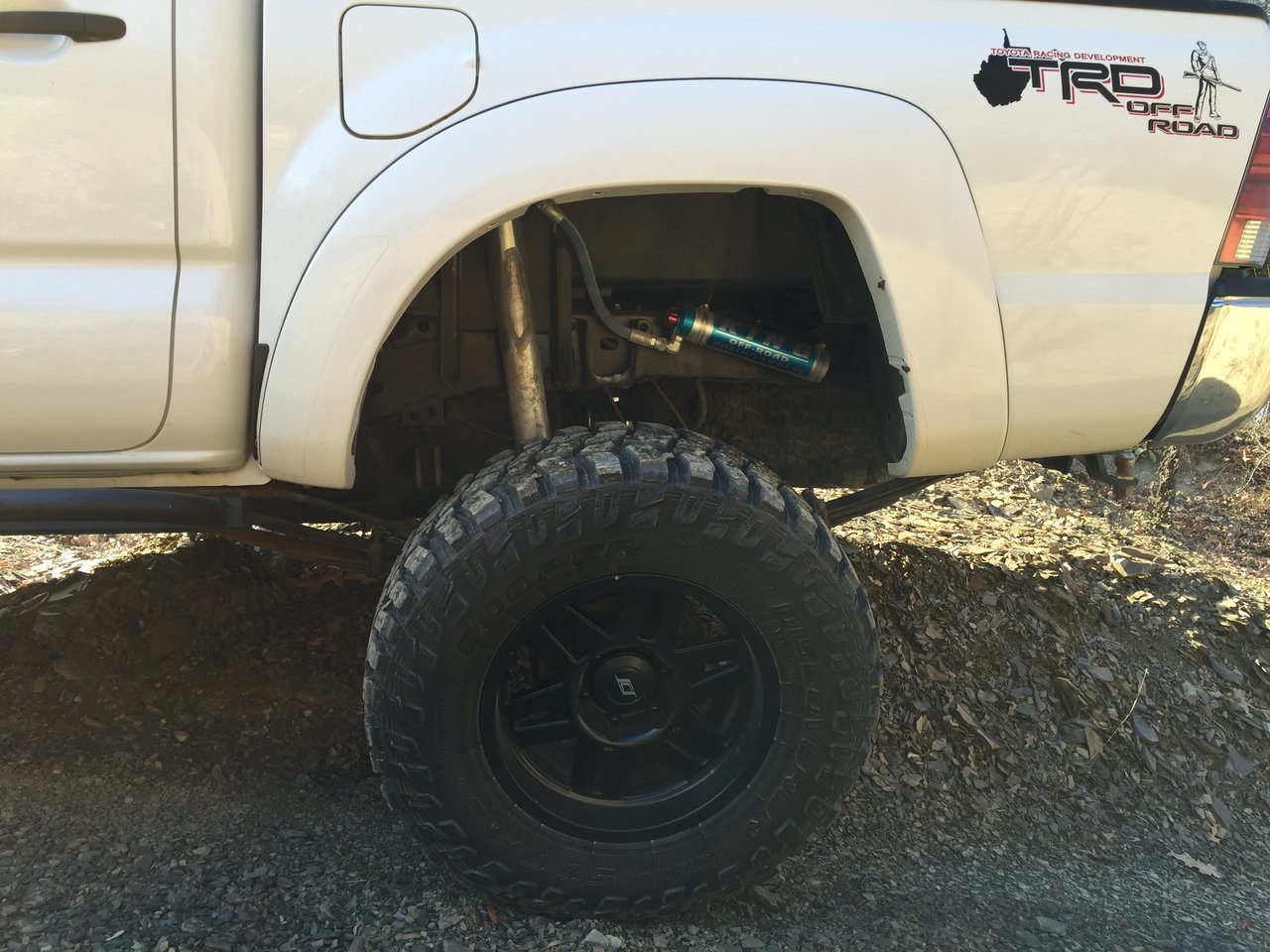

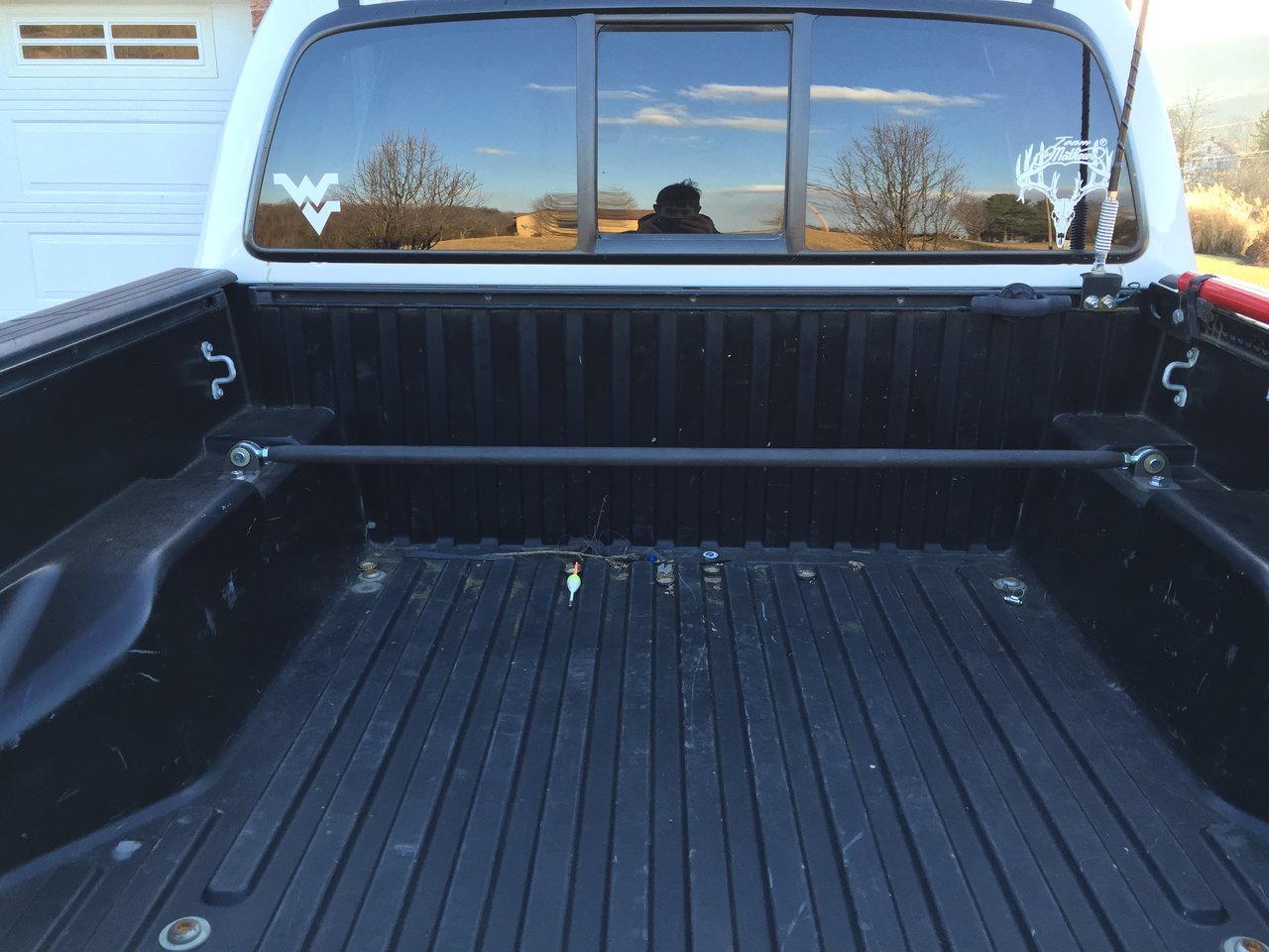

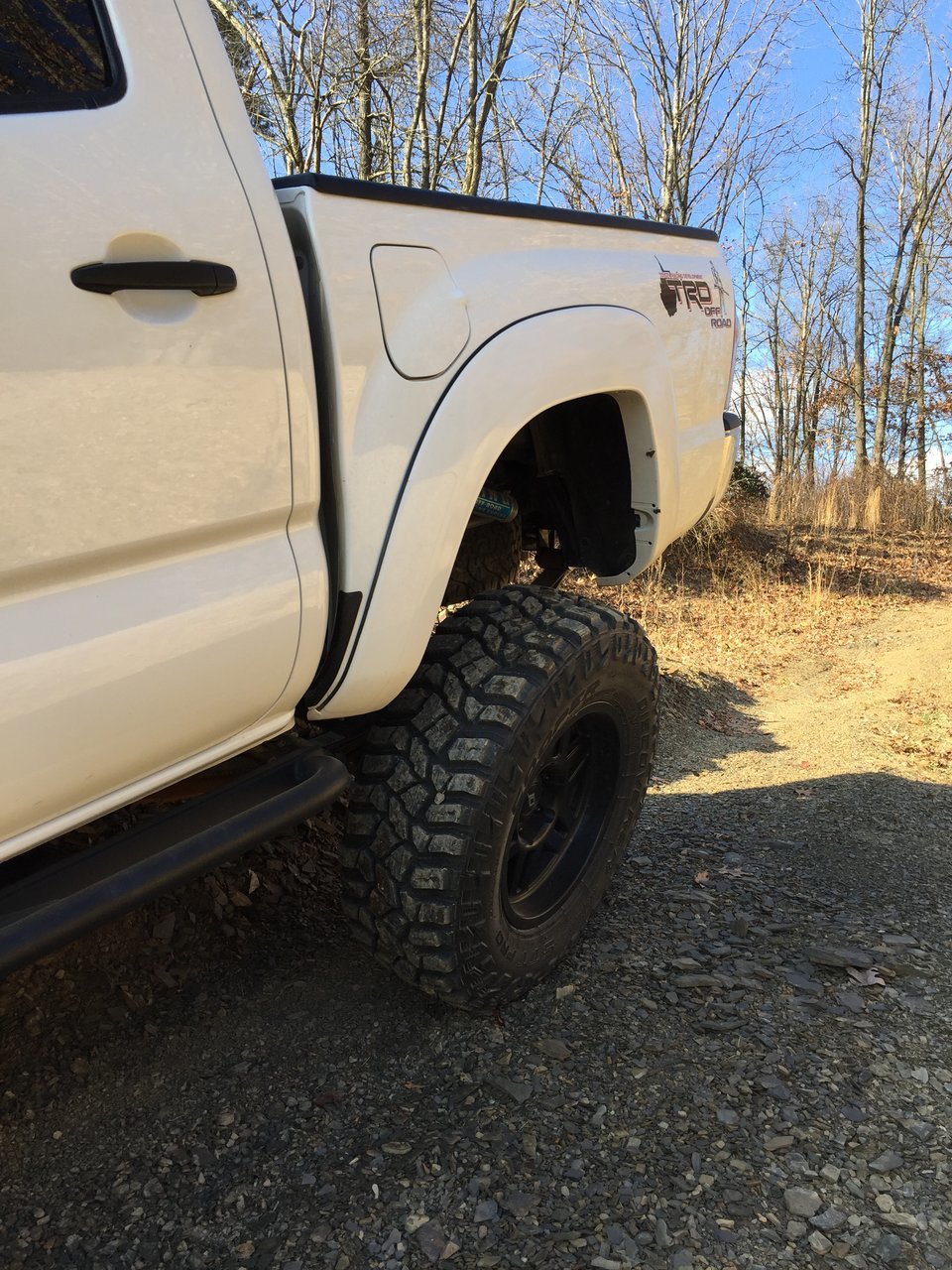

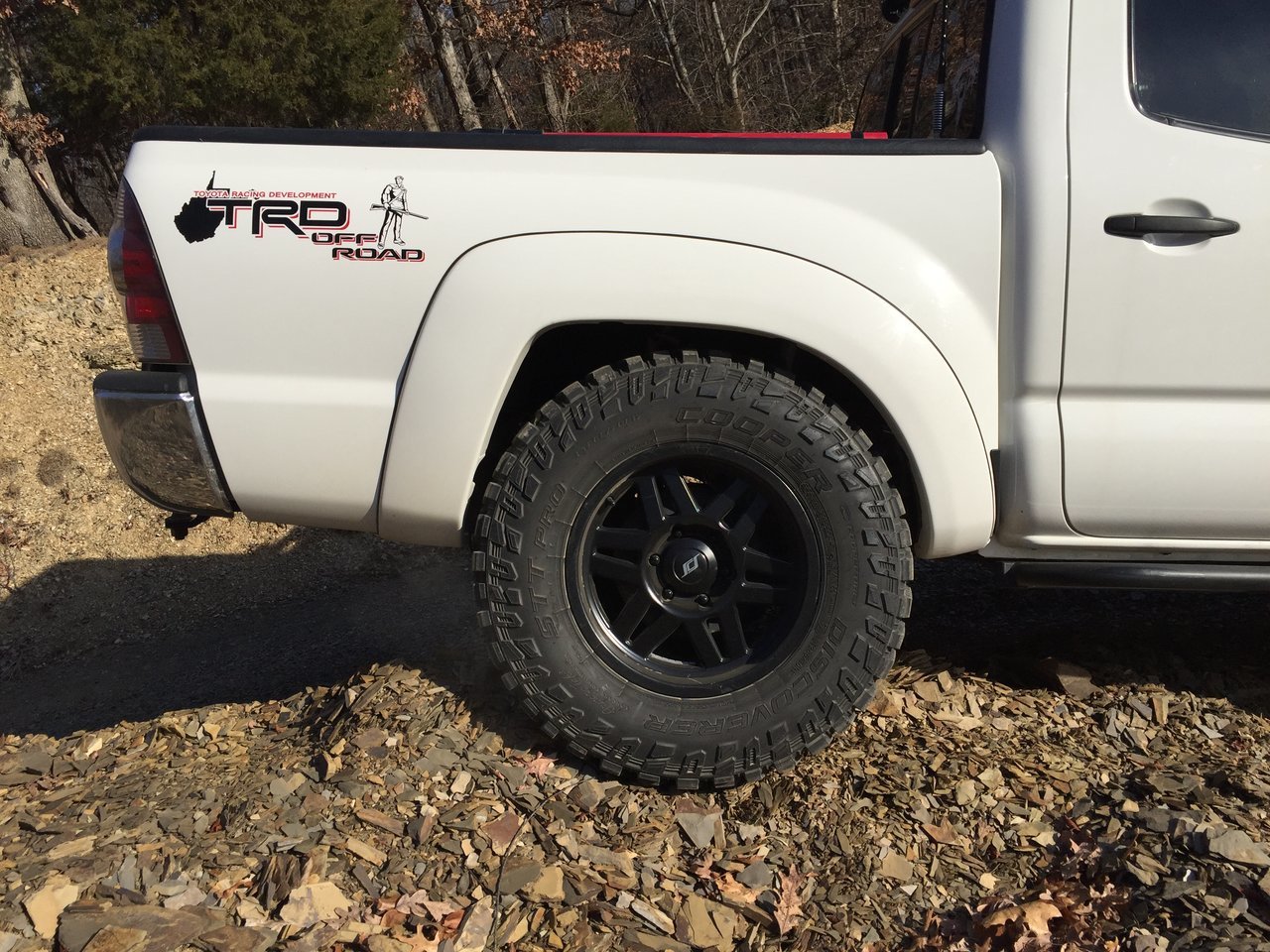

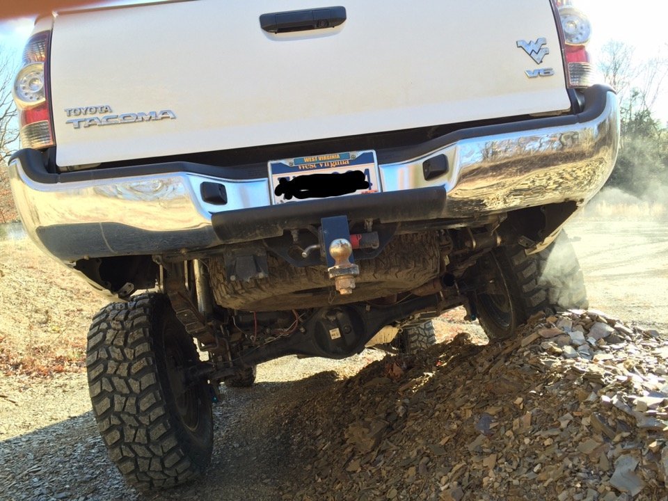

    Well, taken me awhile to get around to typing this up but thought I'd throw a little review up for Eric's shock relocate for the tacomas.
    I was part of the original batch made about 6 months ago so had plenty of time to test it out. It's been combined with two different front suspensions and been through quite a variety of conditions. As the setup currently sits however, the rear is the shock relocate with 14" King adjustable resis and a modified OME Dakar pack also with Archive shackle flip paired to a baja kits LT front.
    Concerning the install I personally did not do it. With the amount of welding required for the towers and the mount tabs I had a shop do it that does fab work. According to them install was very straightforward and everything lined up perfectly. I also had them go ahead and do the bed crossbar for support or which they did a chromoly bar with heim ends to allow the mounts to flex with the frame. The only figment issue I ran into was actually a hair of rubbing of the shocks on tires. When the rear flexes out the tires rub the shocks slightly. Something to watch for... I have SCS Stealth 6's 17x9 with -10BS and 285/70/R17 for reference.
    The performance has been exceptional so far. Mounts haven't budged and have taken some serious abuse both through prerunning and crawling and general abuse. Haven't fully gotten to get the use of the extended shocks yet as I'm waiting on the money to go to deavers and my leaf pack is limiting currently but I did gain travel already from stock location shocks and am very impressed. Between this and the shackle flip the amount of increased travel and gained droop is more than noticeable. Unfortunately haven't taken measurements for before and after but it is quite a bit even with the current leaves.
    Very happy with all of Eric's products I have and he has been super helpful answering questions and helping decide on variations of his products. Would recommend him to anyone. Looking to get some more of his stuff here soon.
    Wish I had pictures right now but yet again... Much better at getting stuff on and using it than taking pictures and measurements. Will try to update this post here soon with some though of the flex and the whole setup. Hope this helps anyone on the fence.
    Thanks again Eric!
    Edit:
    Photodump

    Adam,
    Thanks for your support with orders and posting your experience here. I'm glad you got some time on the setup.
    I'm working on a custom leaf pack focused on increasing suspension travel for spring over, testing starts very soon.
