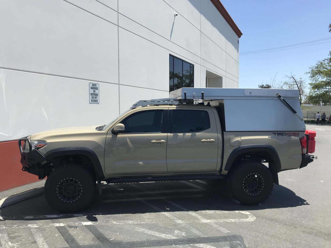

    alexplb
    alexplb Well-Known Member
    Jan 23, 2019
    #280401
    978
    I appreciate the input ! Yeah she is a heavy girl. 7F65BF36-BFEA-4CA3-B91B-6715EED8FF3B.jpg
