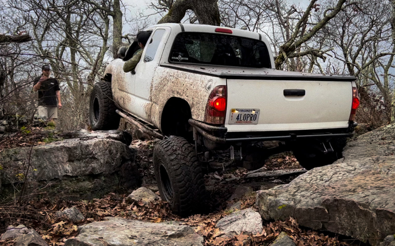

    Hey Eric, I'm upgrading my leaf springs from dakars to alcans this weekend and wanted to confirm with you based on the above post that for 45 degrees I want to move my hangers to the middle position on the hanger with factory rivet holes, correct?
  3. May 17, 2019 at 11:38 AM
    #1263
    ARCHIVE
    ARCHIVE [OP] Well-Known Member Vendor
    Oct 29, 2015
    #168099
    2,261
    Eric
    Orchard Park, NY (Buffalo)
    '05 Taco, '22 Tundra, '91 Cummins
    2.5" Fox relocation * Hammer hanger * Archive MD springs
    Yeah that is correct. What I call the "middle" in that post is really what I refer to as the "foremost position" using factory rivet holes.
    If the foremost position lays down the shackle too much, you always have the option of rearmost position.
    That said, I dont know conditions that the picture is from, what load, etc.
    I do know Alcans are too long for a stock hanger/shackle since they rub the shackle.
    mcharfauros and Littles[QUOTED] like this.

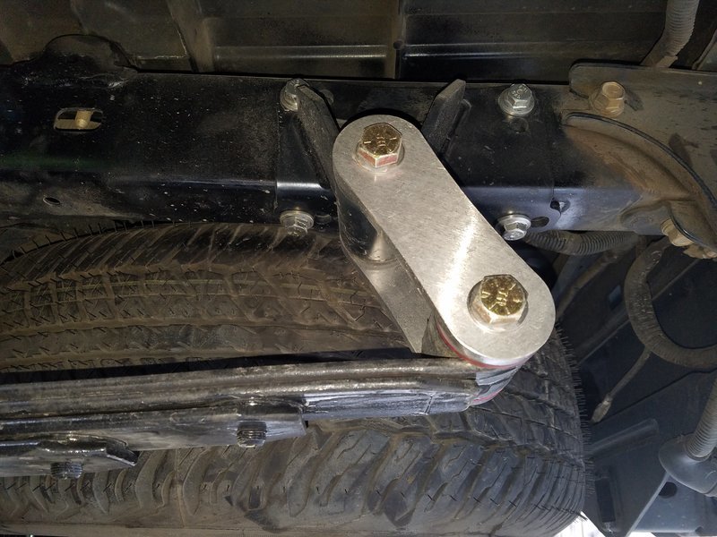

    My sas swapped 2nd gen needs a shackle flip. Could use an extra 1.5" lift in the rear on my 2 year old Allpro Expedition leaf pack.

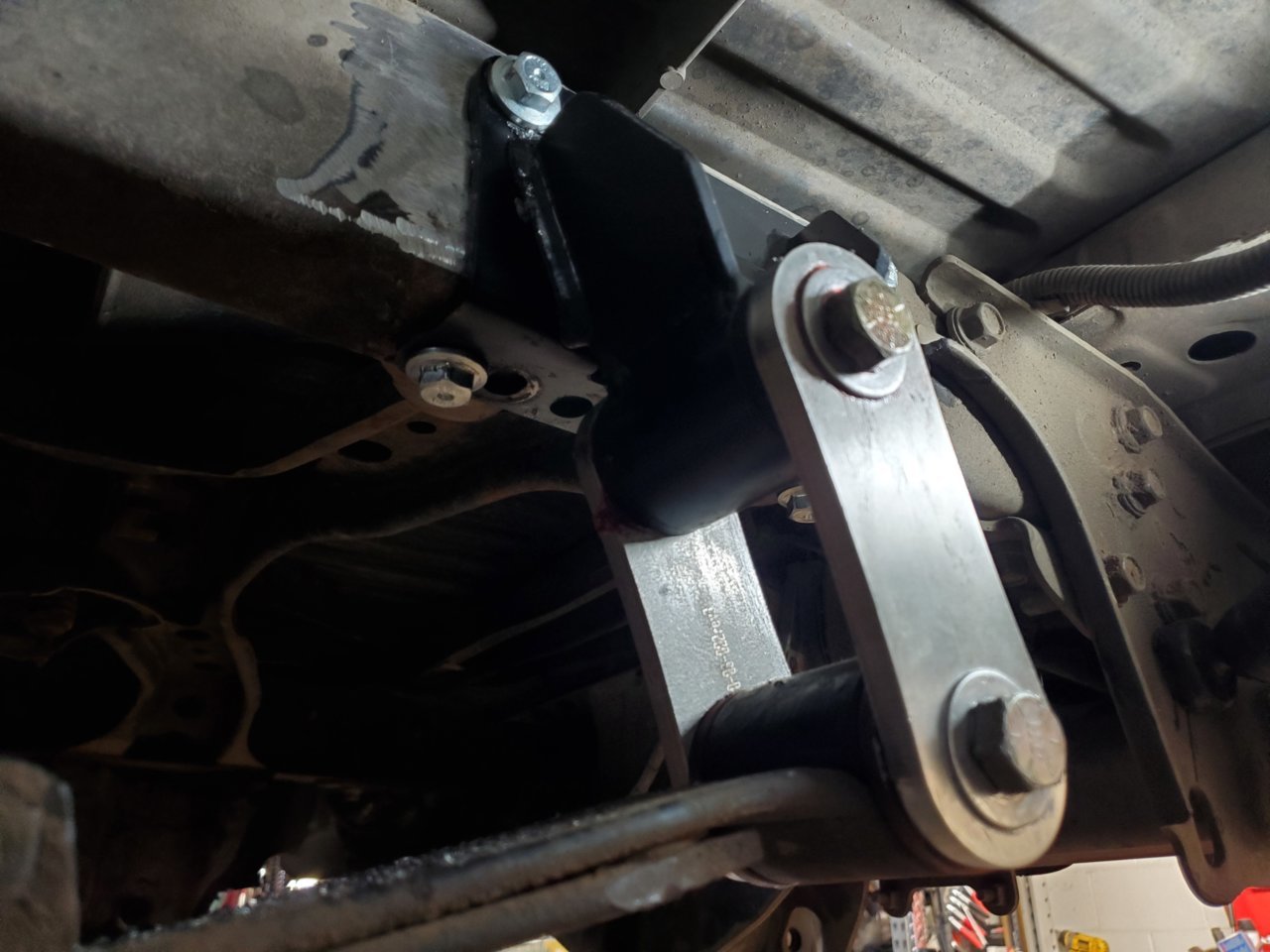

    Found some third party! Installed this weekend. Excited to check them out. What kind of angle should I looking for at full droop?? Have a set of AllPro Expo currently, 3 years old and about 30k miles.

    That looks pretty good on angle to me, possibly around 30deg. That's the best for weight, but if the truck is light and you are focusing on crawling, you would be able to move brackets forward to get 45 deg angle

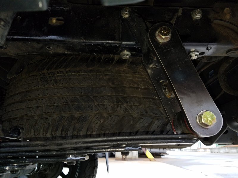

    Was this placement of the mounting plate on the stock holes? I've got an allpro standard pack that's getting tired, and I'm looking into this flip to help get some lift back/ride quality.

    That is the rearmost position using stock holes. All Pro are wet noodles, there isn't a way to "fix" that, they are made too little arch for how thin the leaves are.
    I recommend selling the leaf pack and looking at Dobinsons 110 or 111, and getting Hammer hangers. Or keep the AP and get Hammer hangers for better ride quality (but no lift)

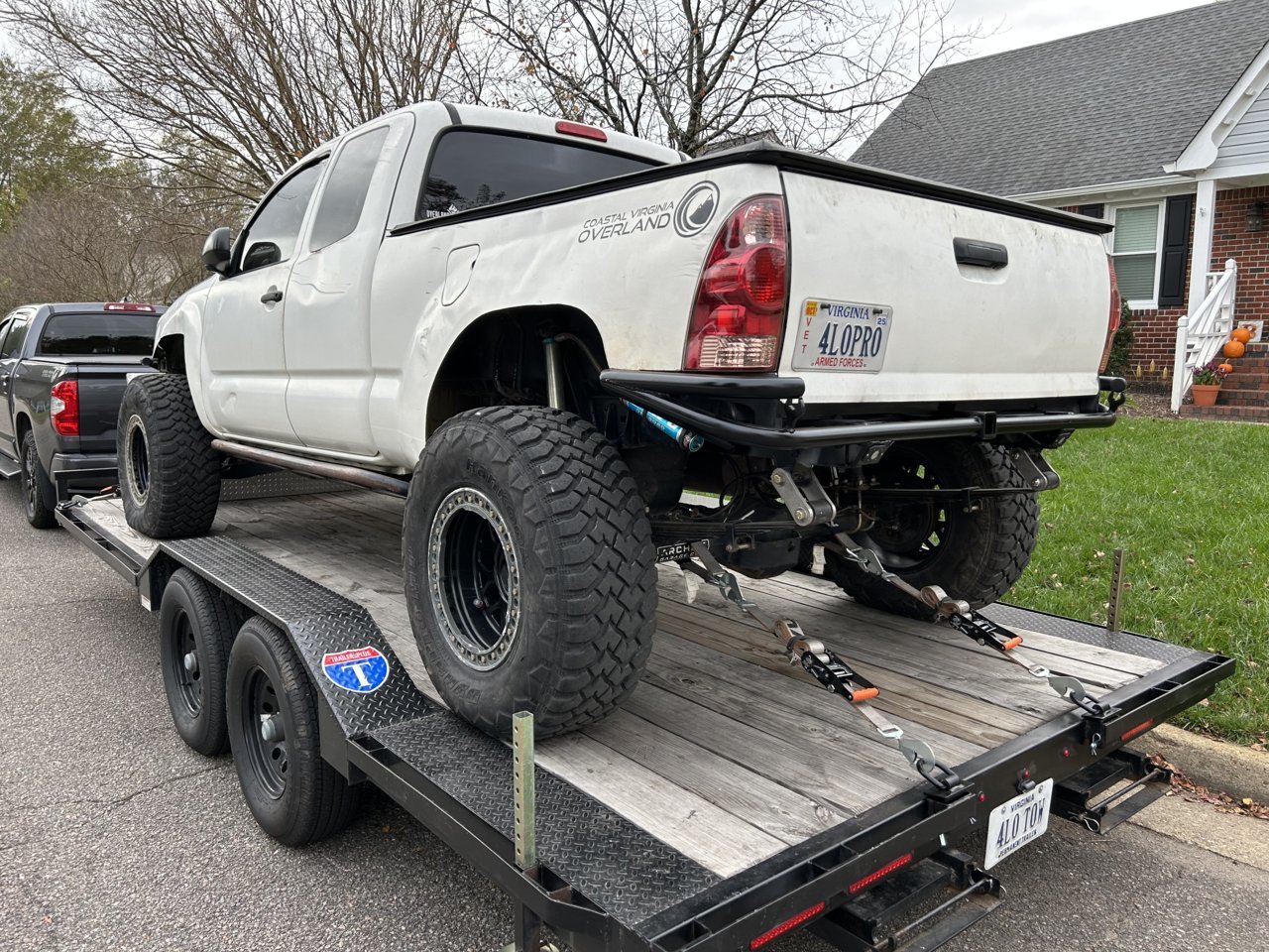

    Thought I would revive this thread. Icon rxt option 1, 2.5” lift over stock measured from the axle tube, 49° shackle angle, hangers in the foremost position (drilled 4 new holes per side).
    With archive trail relocate and 12” kings, the shackle is almost vertical at full droop but not quite. Overall I’m very happy with the kit, though it took a little tweaking with hanger placement to get it where I wanted.
