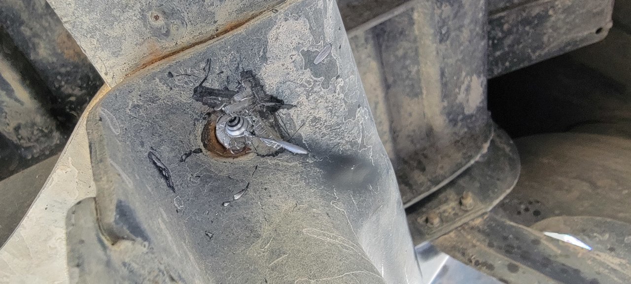

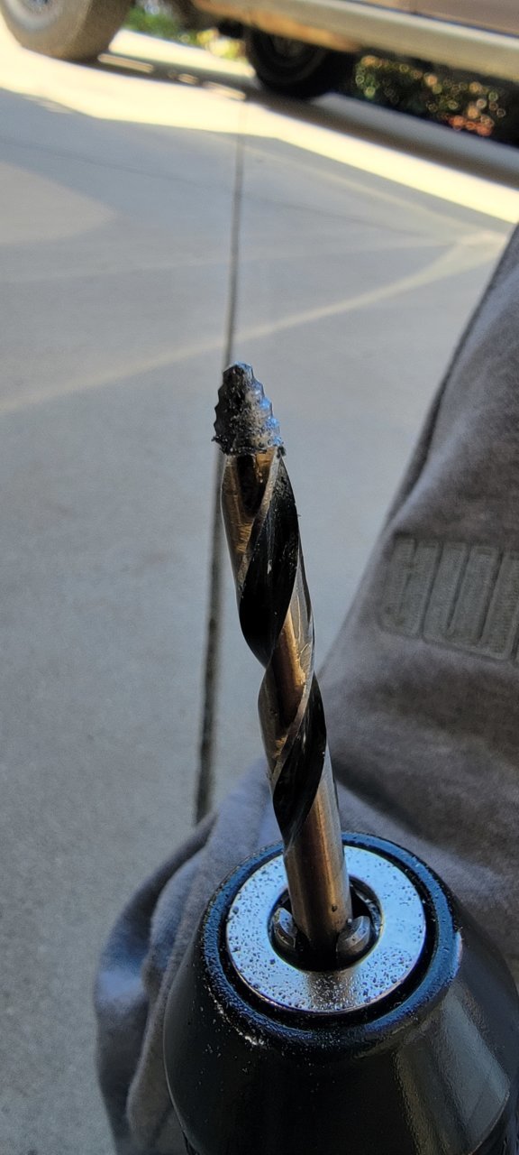

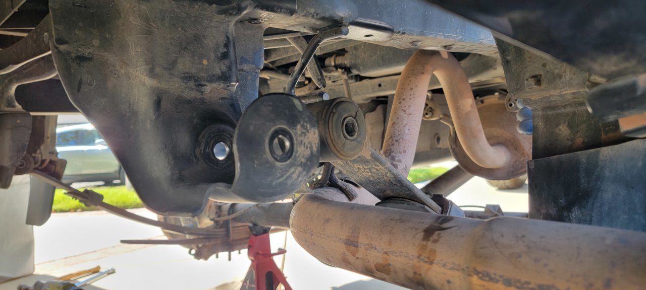

    Our rivet removal process was as hard as the next guy's, but here's what we found to work. We started by grinding all the rivet heads off and tried drilling them out. The stock hanger was in the way so we just cut those near the frame to create clearance. They're not going back on anyway. After spending an hour drilling a rivet, we pulled out an air hammer. two different air hammer bits, a flat head bit and a point bit. Loud as hell but way faster. A ground rivet was punched every few minutes this way. It was hard getting the air hammer to fit in the fender well, but we had JUST enough clearance to get er done. This was an 8 hour install and 6 of those hours were spent working on the rivets. 2 hrs for literally everything else.
    After drilling out the rivets and mocking up brackets, it was clear that they had to go in the foremost position. We drilled 4 new holes using the bracket as a template and this positioned the Upper Shackle Mount directly above the rear spring eye. The stock hole orientation would have resulted in a very negative shackle angle.
    With the stock SUA leaf springs (28.5" Eye to Eye) + AAL, foremost position on shackle flip, I achieved a perfect 0-degree vertical shackle at full droop (which is about 2" lower now). 35-degree angle under normal load.
    The 5100s are too short for full droop so I picked up some 5125s, have yet to put them on because on top of this, the brake lines are at high tension at full droop. Picked up extended brake lines. Both the brake lines and 5125s are going on soon. For the time being, the 5100s work, but limit the suspension travel to 2" above full droop. Haven't been wheeling on this setup, but haven't had any issues on dirt roads that don't require full droop.
    The exhaust hits the shackles at full droop, but otherwise clears it. Can hit the exhaust hanger with a BFH or just cut it if that's a concern. I personally don't care.
    Photos!

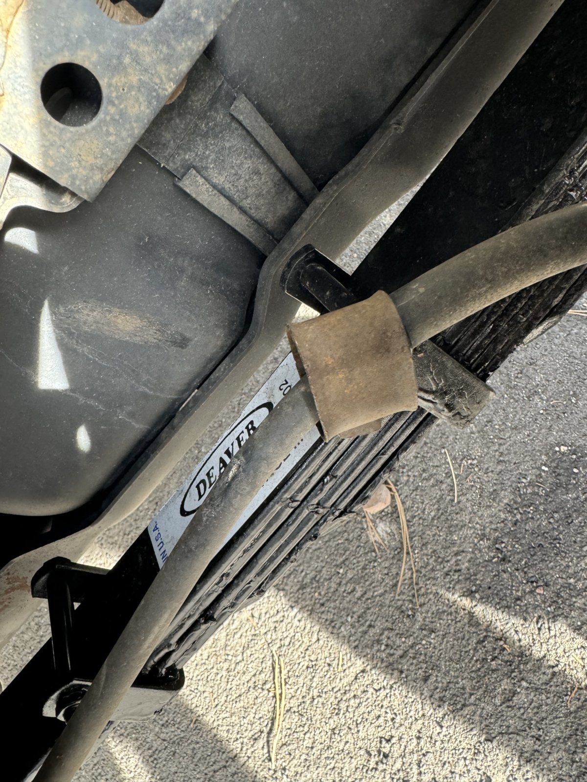

    For those of you with deavers what did you do with your e-brake brackets? Aftermarket? Custom? These don’t look good

    You may be able to bend that down.
    Or we can sell you a pair of rubber coated clamps. Start a conversation if wanted

    I've run Deavers for almost 200K miles, with the e-brake cable like that. I planned on moving it, but has shown no wear.
    I got to looking at the cable routing. The "pivot point" is actually the front spring bolt. From the loop to the brake drum, the cable does not really change position.

    If one has a shock relocation, especially with 14" shocks, the cable clip at the front spring bolt can cause the cable to get tight under droop, something to watch

    I would much prefer to loops to be inverse of their current position, but there wasn't an easy way to it. While figuring out how I wanted to flip them, I observed the lack of wear - hence, the project got moved to the back burner.
    I still have not installed my shock relocation. When I do, I'll check the cables. I should probably just plan to fix this at the same time - better late than never! :p
