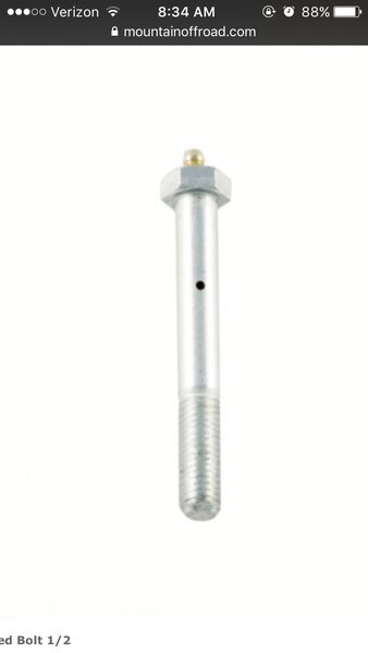

    For the bolt that connects the shackle to the leaf would it be possible or of any benefit to use a greasable bolt, since the top is greasable just figured it would benefit the bottom to be too. I know in the jeep world they use these...

    I offer drill bits with my kits, I like the method to grind the heads off rivets but prefer drilling holes clean thru, then removing brackets. Thanks for explaining
    Yes, definitely if you have poly bushings in the leaf spring. I dont offer them yet.
    Edit: You would need 9/16" which is almost exactly same diameter as M14 bolt
