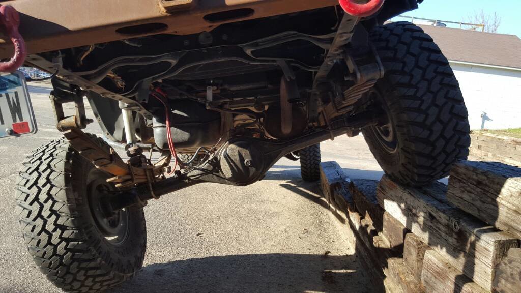

    hmm.. I have the AP standard pack with Icon 2.5s in the rear not sure if you or someone else might know but I can't find the travel so not sure if with these shackles they will droop too far.

    I run 29 inch lines and use almost all of the length at full droop

    That sounds excessively long

    Just a little slack i litterly use the entire shock travel whick is 12 inches

    Wow, your rear lines are set up way different than mine. Maybe because mine is an 09, but I would have tons of slack with lines that long

    would brake lines or longer shocks be needed? i have 5100's in the rear with new 4leaf springs from Toyota

    I would recommend both

    Got my kit installed! Been reading a lot of the questions in here and I think I can help answer many of them. Ill go through tomorrow and see what I can clarify. I am running AllPro expo leafs with Icon 2.0 rr 10.8" travel shocks with extended lines.

    Is your shock totally extended at full droop, or is there still some shock left? Reason I'm asking is because I have those same travel shocks and leafs.
