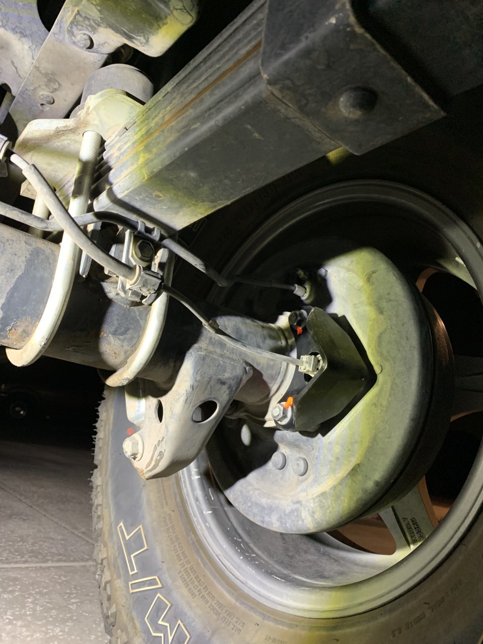

    About 11 minutes to install (including torquing to spec & witness marking). Erik thank you for making these killer little guards and thank you for providing the easiest instructions ever. It’s already easy and you made it easier.

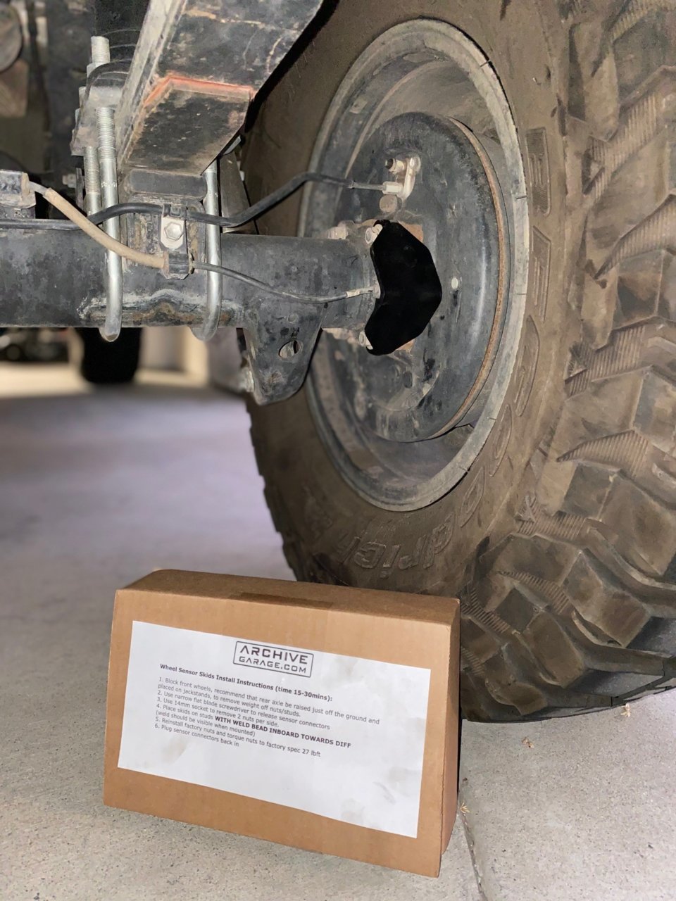

    Glad I had time to finally get these installed! Awesome fit and finish as usual.

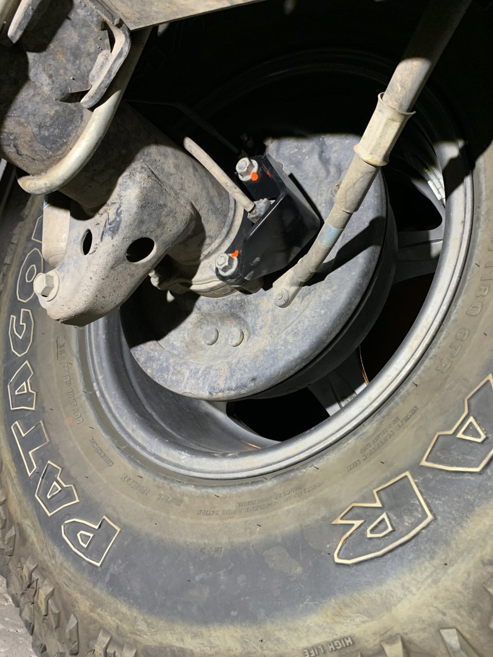

    Installed mine as well. Not sure why the weld bead orientation matters but whatever :) Surprising how much dirt is trapped in the sensor connector!

    Cool. The reason for the weld bead towards the center of truck is so the weld doesn't hit the hub flange, making sure skids sit flat
