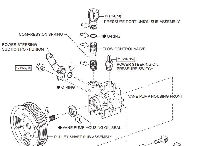

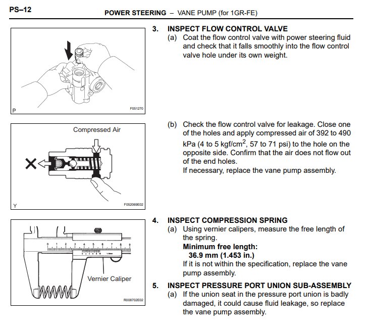

    it was previously mentioned that when the pressure sensor for the power steering is disconnected, the idle goes down, and it was also mentioned that when the computer gets a signal that the pressure goes up, it bumps up the idle.
    if there is no short in the PS pressure sensor wires, and the sensor is "good" ( should actually be tested, even new pars can be broken ) then perhaps you should have the power steering system pressure tested. I *could* be over pressurized
  10. Sep 9, 2021 at 7:43 PM
    #30
    D2.
    D2. Well-Known Member
    Dec 1, 2016
    #203759
    1,578
    Dan
    Nova Scotia, Canada
    2009 Tacoma - access cab 4x4 2TR-FE
    Cruise Control install. Intermittent wipers Hood lights Bed Lights Sliders 3" lift 886's on Billy 5100's Icon AAL 285/75 R16 Falken Wildpeak AT3W's
    Perhaps the flow control valve is "fudged" causing the system to be at a high pressure all the time.
    b_r_o and Dm93 like this.
  11. Sep 9, 2021 at 7:53 PM
    #31
    D2.
    Dec 1, 2016
    #203759
    1,578
    Dan
    Nova Scotia, Canada
    this is from the FSM,
    do you know if those systems have been checked yet?
