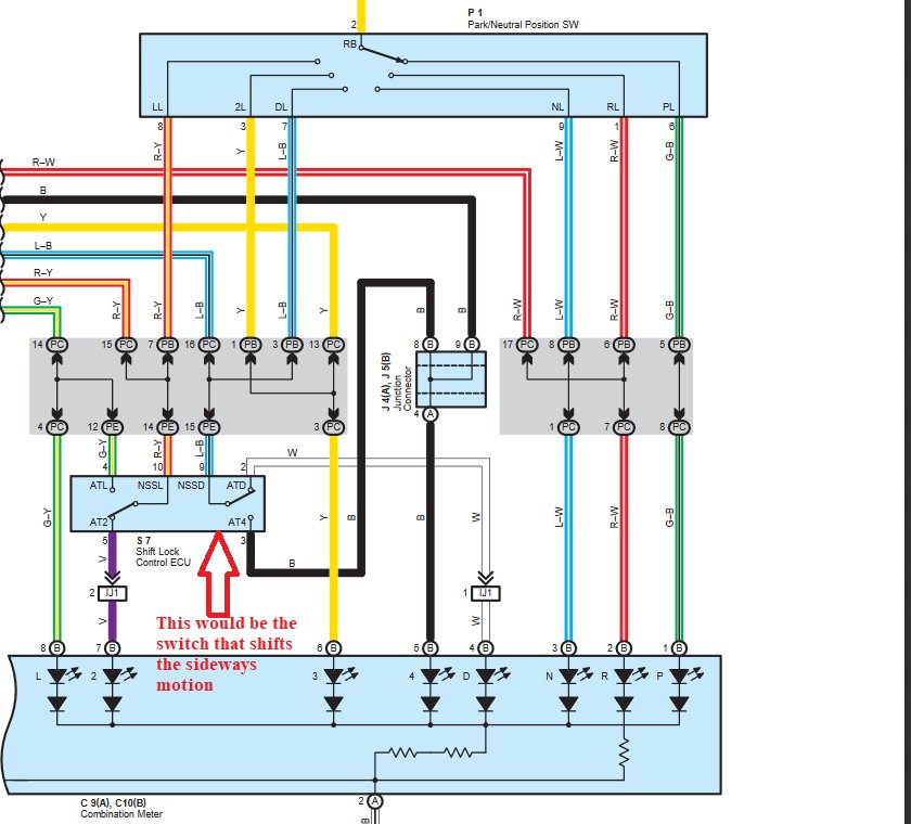

    Yes there is a switch that does this function between Low and 2nd, 4th and Drive. See image below:
