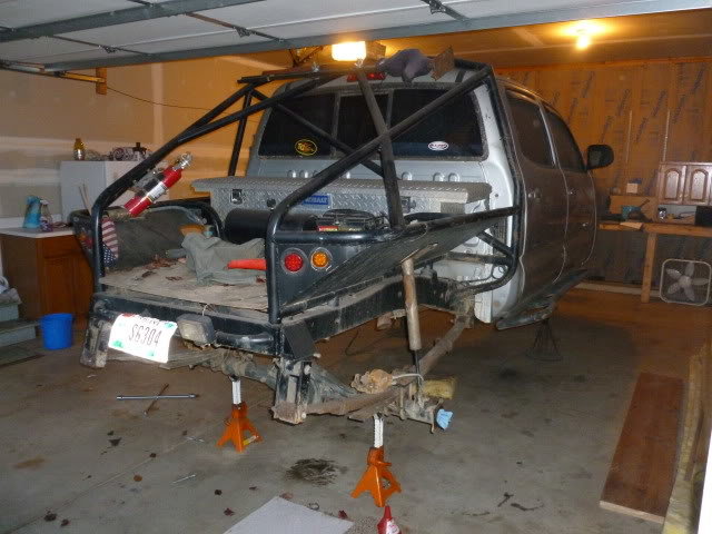

    On the up side you have never seen my garage so clean :D...or so empty :(
    Cheer up Eric, you'll be back over here before you know it!

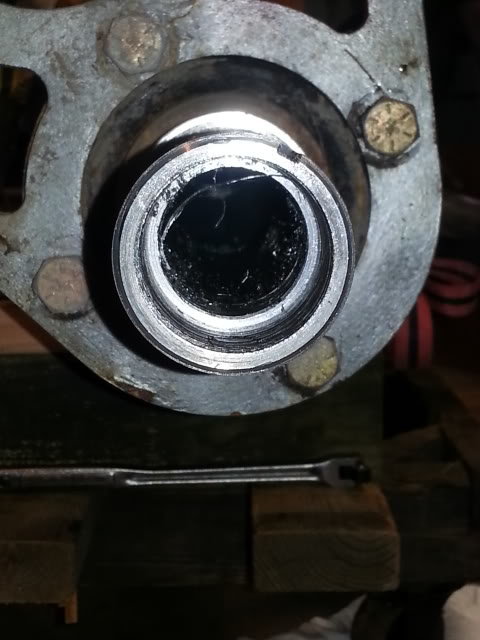

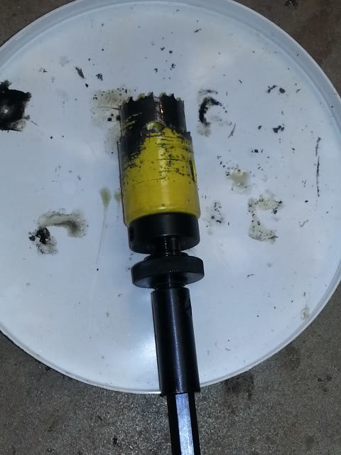

    Started working on my rear axle this weekend...boring for 35 spline shafts:
    1-9/16" hole saw with a 1-3/8" hole saw mounted inside it for a pilot:
    How much you actually remove:
    One side done...one to go!

    Both rear spindles are now bored! 35 spline chromo rear shaft should be here friday so saturday I can finish up the rear hopefully...install the hubs, shafts, 4.56's, and the ARB :)
