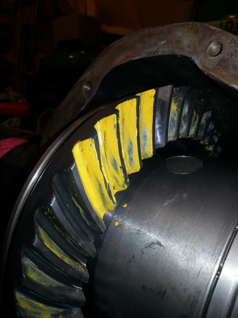

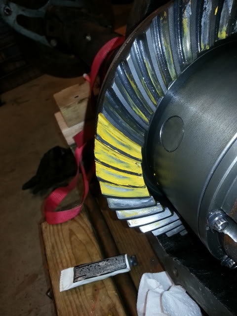

    Got gear marking compound today (GM1052351) from the GM dealer...they keep it in stock go figure...
    Drive Side:
    Coast:
    Coast side is a little towards toe but acceptable. Edges are still "soft" so its not running off the inside of the ring gear with force.

    Nice, man. Good to know about the GM marking compound! Those patterns ain't too bad. :cool: Although I think you've got drive and coast backwards? Isn't drive the convex side and coast the concave side? And yeah, a little deep and favoring the toe on the drive (convex) side is desireable for strength.. Real quick, how did you apply a load on the gear set when rotating it to check the pattern? I wish the patterns were a bit more clear, but sometimes that's all you can get with used gears.. :\

    Yeah you're right I labeled them backwards, lol.
    Pattern looks almost exactly like the first "Acceptable" pattern on page 3 of the randy's link i had posted...take a look, I am really surprised! :D
    http://www.tacomaworld.com/out.php?...-Adjusting-Ring-and-Pinion-Tooth-Patterns.pdf
    Coast side looks as if pinion may be a little close because of the flat bottom on the pattern, but the drive side is soft at all edges...I am gonna run it as is.

    Nice, man... yeah, I say go for it. Looks pretty good to me. :cool:

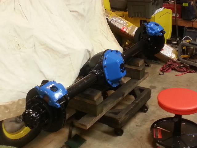

    Rear axle is done.
    '80ish Ford Rear Dana 60
    ARB RD35 Air locker
    4.56 Gear (unknown brand)
    35 Spline 4340 Chromo Shafts (Durasolid)
    Great Lakes Offroad Disc Brake Conversion
    Ballistic Fab 3/8" Pl. diff cover

    Nice! How much clearance do you think you will lose compared to stock?

    daaaamn

    Nice! Discs look painted!?
    Not much ground clearance lost with the size tire that will be ran.

    Not as much as if I ran a shaved 14 bolt :D
    Thanks!
    Yeah they had some surface rust on them and some red from the PO so I just shot them with the axle...it wont last long on there but will protect them while I finish the rest of the project.
