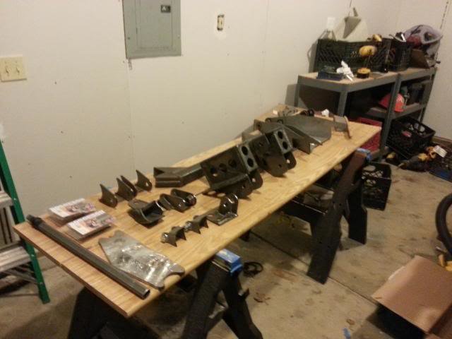

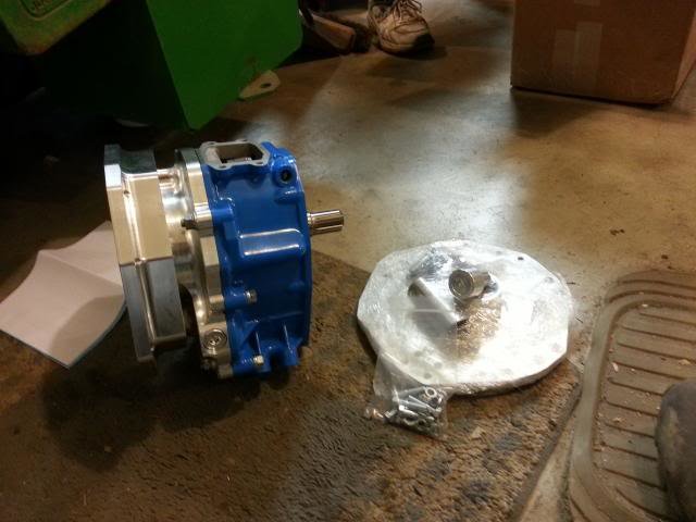

    More goodies:
    Maybe get this in this weekend so I can wrap up the rear suspension/driveline...

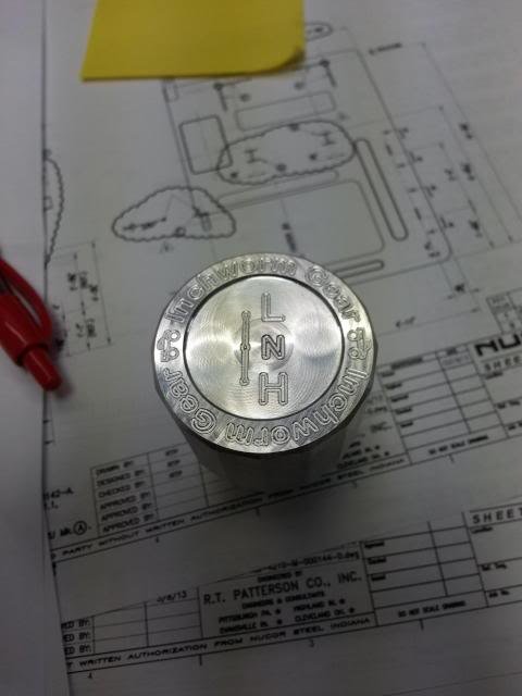

    So, I'm sure you did your research... Why the Inchworm over the Marlin or vice versa? Also, I noticed on Inchworm's site that they "do not recommend using a 4.7:1 gear set in the first case because of the strain it puts on the input of the chain driven case". First I've seen that.
  9. Mar 28, 2013 at 7:03 AM
    #349
    NwiTACO
    NwiTACO [OP] Big tars, little/no bed.
    May 19, 2009
    #17416
    4,428
    Mark
    Indiana
    05 TRD Sport
    Custom Everything, 1 Ton Axles F & R
    Costwas a factor. The product is very much the same in the end, and inchworms customer service is top notch (never dealt with Marlin, just heard they are hard to get ahold of sometimes). There are some threads out there comparing the two, and the information contained within is almost 8 years old. For example Inchworm now uses a completely new output shaft in the gear driven case (just as Marlin does) to mate with 23 spline stuff, not a modified stock output as they tried (unsuccessfully) long ago. Both are a great product, and I wouldn't hesitate to run either one in my truck. Inchworm also "lets" you find your own shifter, instead of including it and charging for it.
    I spoke with Josh at inchworm, and I am confident there product will more than suit my needs. I hope I dont eat those words.
    They both use each others adaptors, in fact most of the Marlin cases I have seen come with Inchworms tranny adaptor plate.
    You can still upgrade the internals, like I did, to use the Marlin total spline input shaft, vs. the Trail Gear 23 spline input.
    In the end the only difference is the special oiling technology for the bearing in the adaptor from the gearcase to your chain driven case. I have yet to see or hear of a failed case due to a seized tcase bearing in this location.
    As for the 4.7's, I stuck with stock gears, so doesnt matter to me, however, both companies use the same gear driven case, and Marlin says 4.7's in the front are ok, and that would be good enough for me. :D
    Some things in life which are better or stronger, unless necessary due to use and loading, are excessive and unecessary. For example, I can put a 3" pillow block bearing on a radio flyer wheel, and it will be stronger for sure, but when the wagon sees such small loading in real world use, is it really necessary?

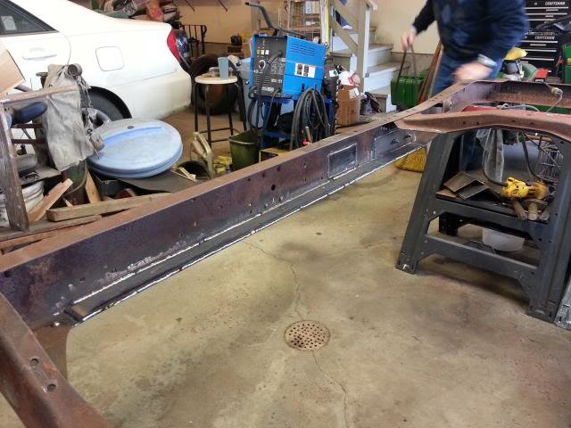

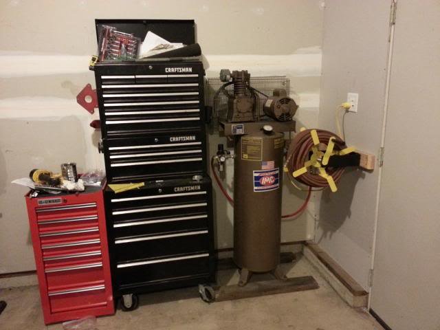

    Well finished drywalling over the weekend since I had some extra hands (thanks Supra TT). Also added another set of drawers to my toolbox (I dont give a shit that its red, lol) and got the compressor set-up how I want it too. Ran a dedicated 20A receptacle with a piloted switch to turn it on and off. Then added a regulator and a hose reel too.
    Almost ready to start working on the truck now :p

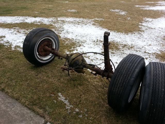

    Also did some more frame reinforcing on my dad's 1949 Ford project:
    Alot of welding...
    Just look at that rear end, lol:

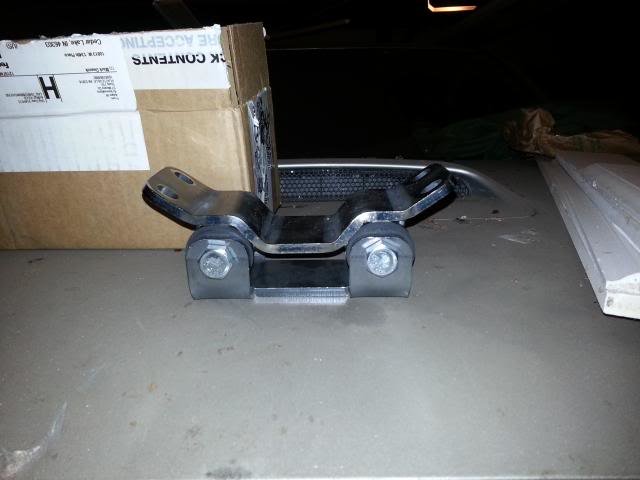

    4x Superduty Transfer case mount came on today for the crawlbox...

    I am gonna run bushings at the crossmember mounts as well to try to reduce the vibes...
