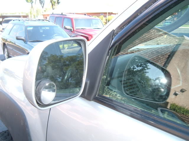

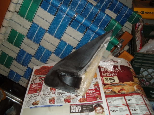

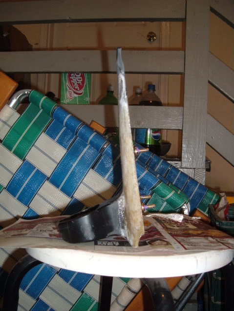

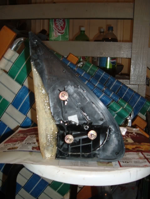

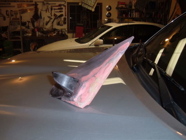

    When wheeling at CTJ'09 I managed to break my mirror. Just the black plastic "triangle" part that mounts to the truck, so I decided to rebuil the missing portions with fiberglass:
    Can't even tell!

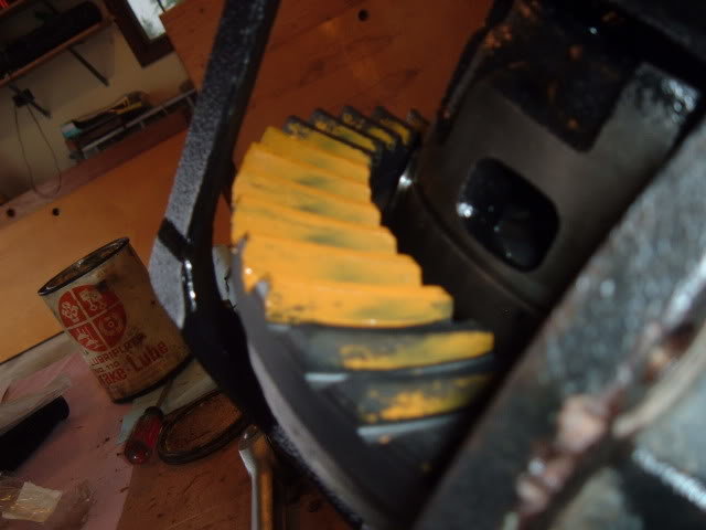

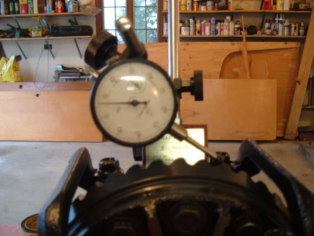

    Next I decided to regear to 4.56's. I wasn't about to pay what shops want to do this so I decided to do it myself. Disclaimer: This is in no way a job for the average Joe to tackle. I have a vast knowledge of mechanics including a ME bachelors degree so I know how to properly set-up gears.
    Apparently I didnt take a whole lot of pictures during this, lol but here are the two I took of the rear set-up I ended with:
    Pattern:
    Backlash:
    Now if anyone is thinking about doing this themselves here are a few tips:
    1. Try the rear first, if you can't do the rear, you will not have a chance at getting the front right.
    2. Don't bother withcrush sleeves, go solid pinion spacers all the way.
    3. Refer to this website, chances are you will find a write-up on the exact install you are doing...I did. http://www.gearinstalls.com/ Thanks Zuk!
    4. After swapping the gears, start with the shims as they were installed for a starting point. Adjust from there.
    The front is a different story, refer to the FSM for procedure, and you absolutely must have a dial indicator with a right hand attachment to measure the backlash.

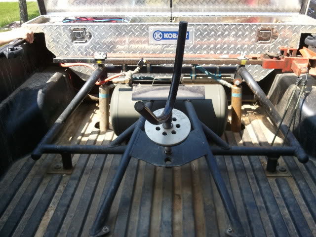

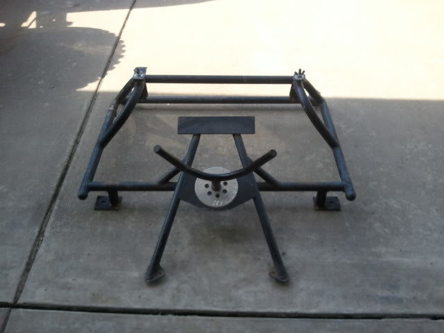

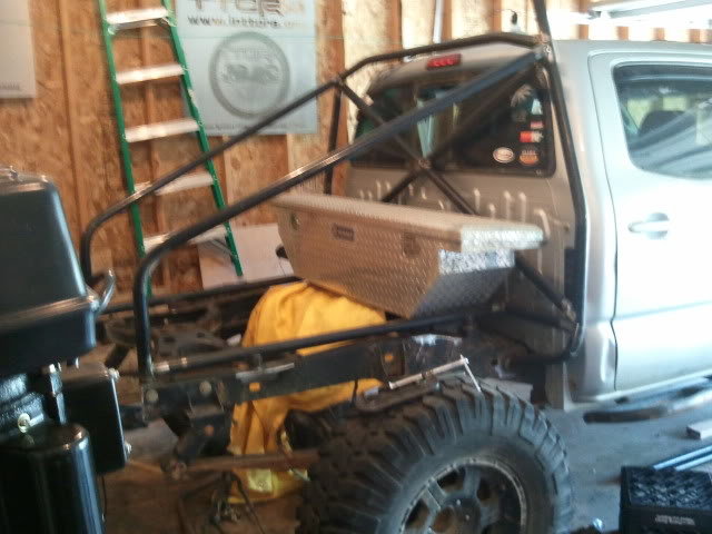

    Got a bedcage for a 2001 Tundra given to me so I figured I would make it work...with a few minor modifications I was able to mount it in the bed using the stock bedbolts.
    Combined it with some Bilstein 7100's and this was the result:

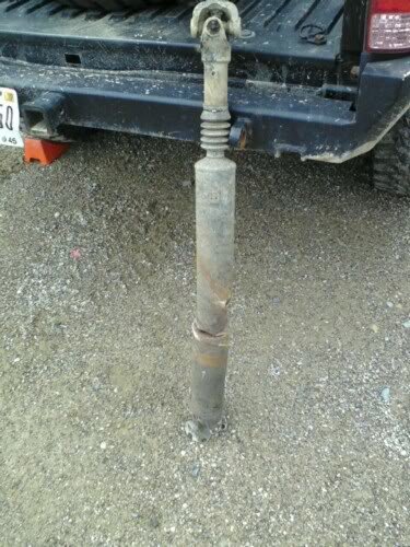

    Twisted rear d-shaft:

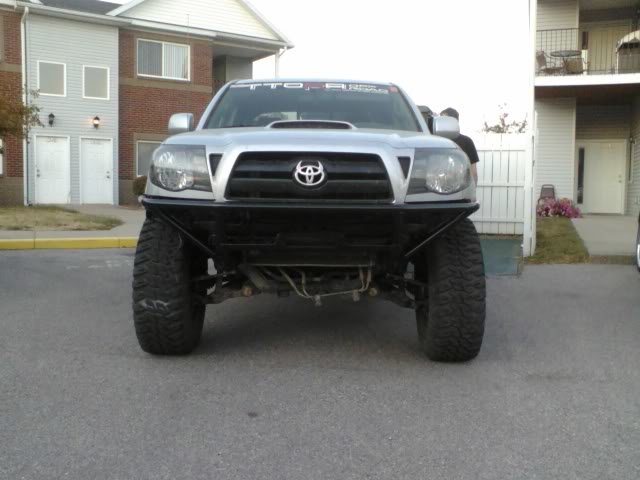

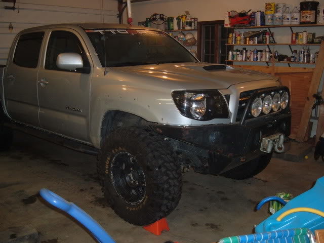

    Well by this time I was getting tired of my All-Pro front bumper and the tube look was growing on me so I decided to build 'me one of my own!
    No bumper:
    Sold my AP and my skids to no mods.

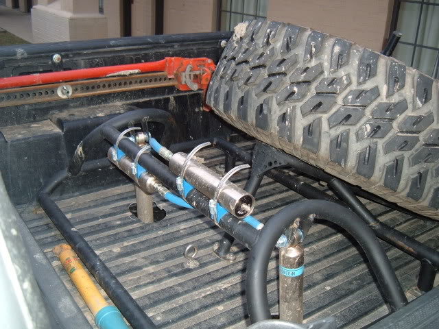

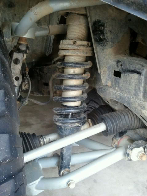

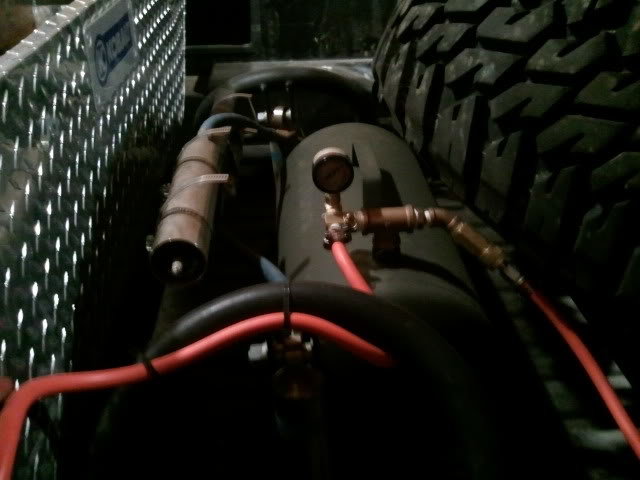

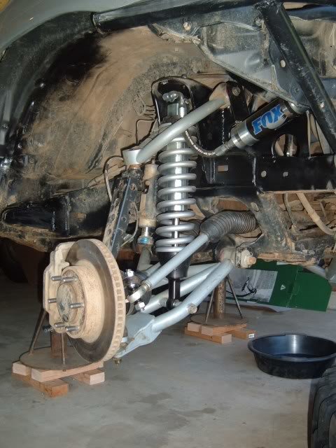

    Next mod was All-Pro LT and Front and Rear ARB locker. Dont have alot of pictures but heres what I do have:
    Mounted the airtank under the mini-cage in the bed:
    Then threw the high-lift on as well:

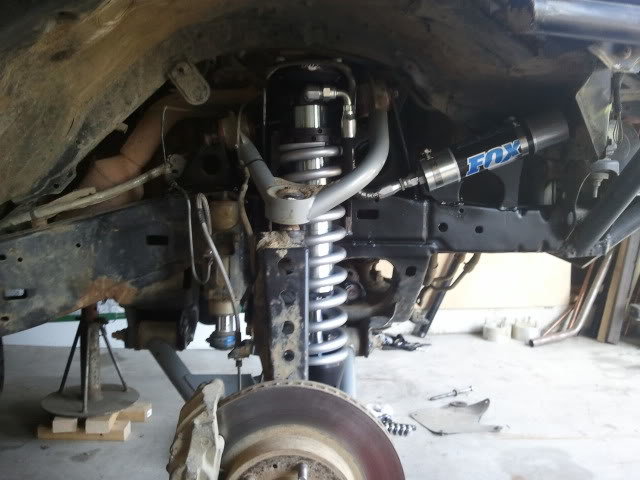

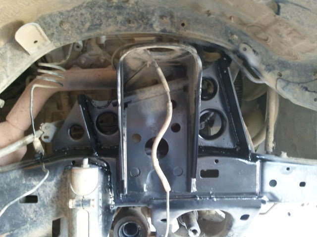

    Then upgraded to the Foxes and added Total Chaos Coil Bucket gussets as well:

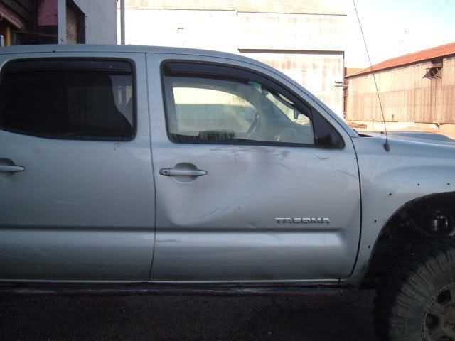

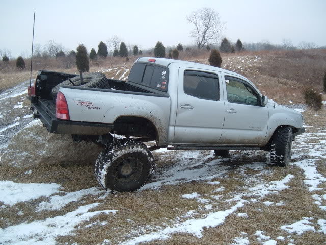

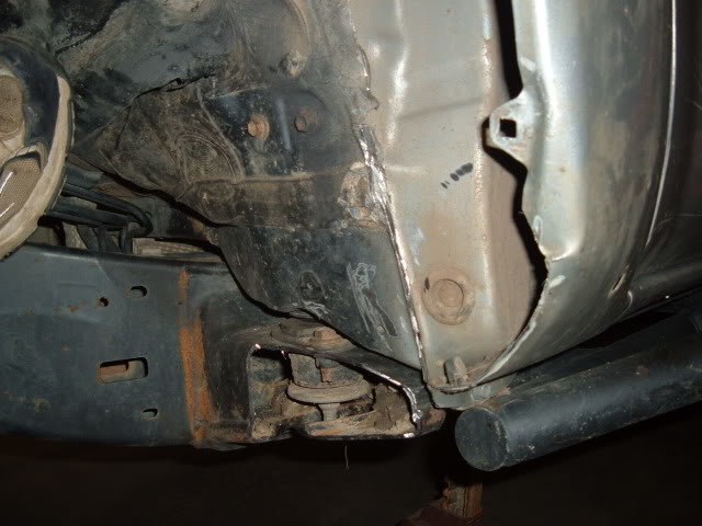

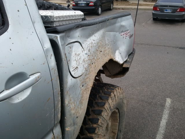

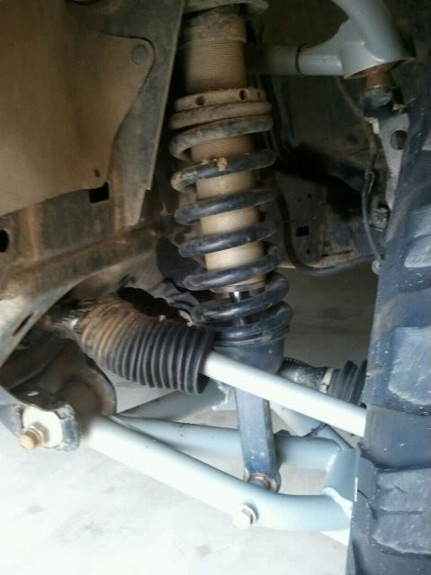

    Then this happened:
    So a major change was in order...

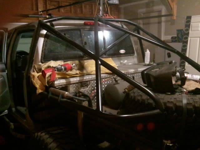

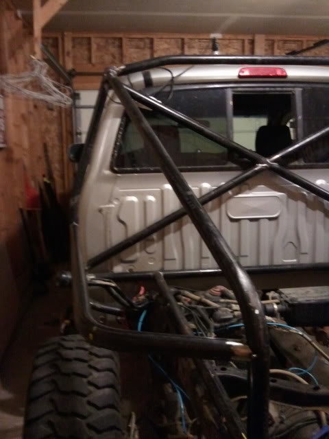

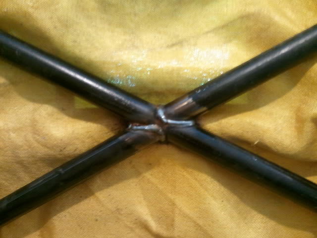

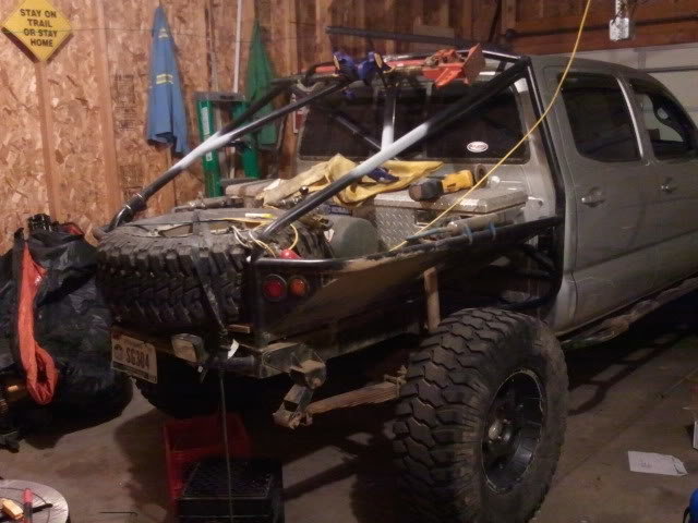

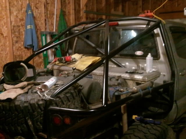

    Then I started my bed cage:

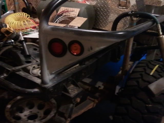

    Tail light arrangement:

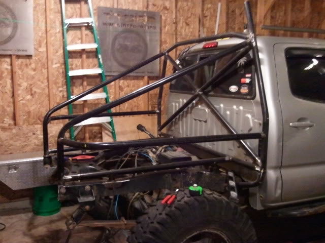

    A few more tube addittions:

    So was this:
