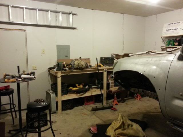

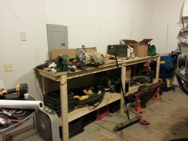

    Well Eric (Supra TT) came down so I had some help this weekend to get some work done on the truck...true to form for lately we completed some work on the garage first :D
    First up was building a workbench to store some crap and give us a nice area to work. Bench is 10' long and 42" high, built with 2x4's and a 5/8" particle board top and shelf.

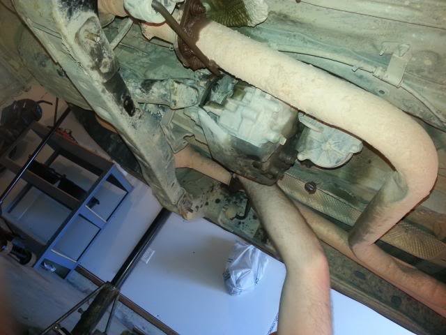

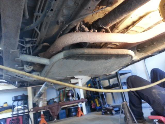

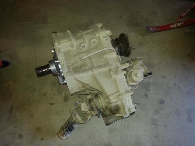

    Then we got started on the truck. First up was to remove the tcase skid:
    Then removed the crossmember, tranny support, and tcase:

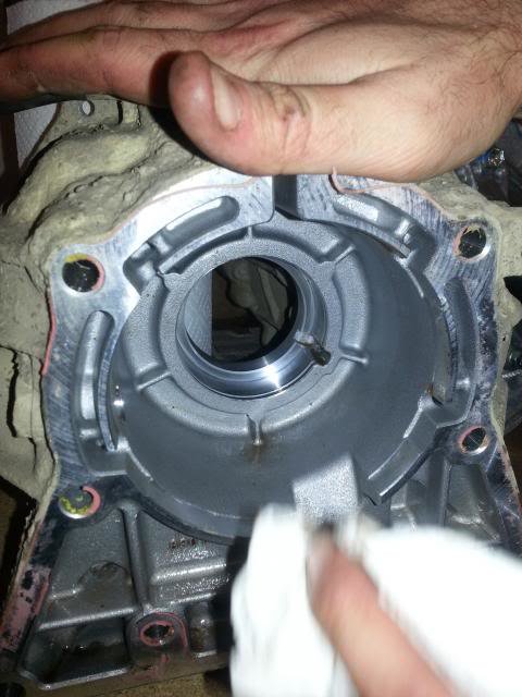

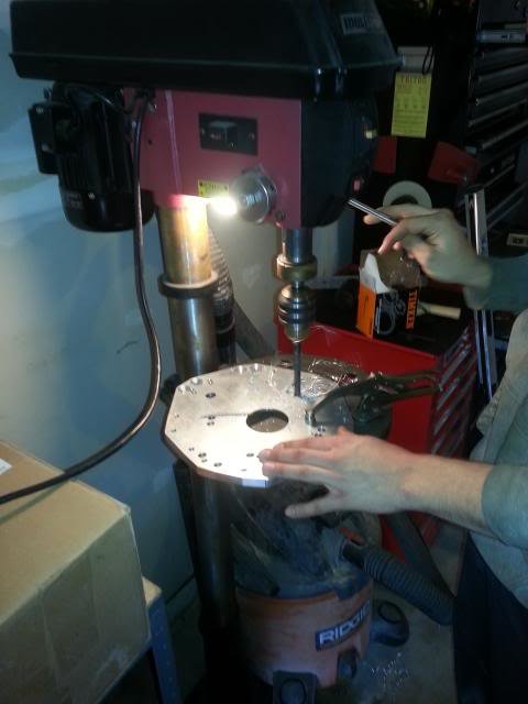

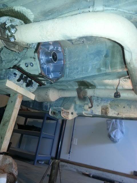

    Transmission to Gear-drive adaptor marked and being drilled out:

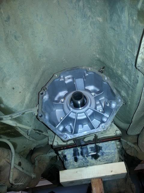

    Tailhousing removed from transmission and bearing and seal removed from it:

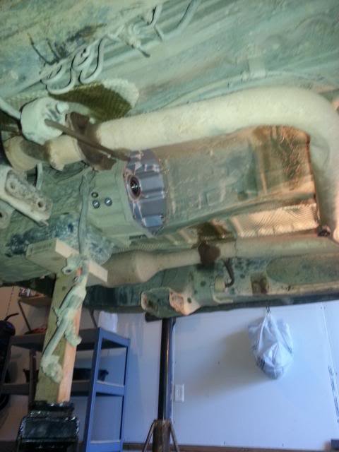

    Tailhousing back on tranny, minus bearing and seal, with coupler on tranny output:

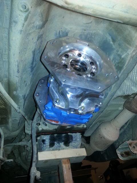

    New extension and seal installed over coupler:
    Crawlbox installed:

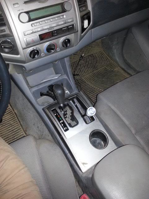

    Hole in tranny tunnel for shifter:

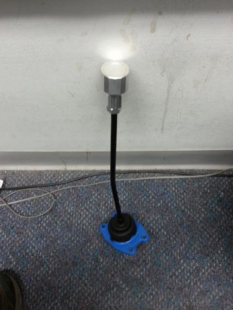

    Got the shifter all made up last night, First I cut the stock lever off the "ball" and drilled it out to insert a piece of 3/8" dia CRS. Welded the top of the joint and a plug weld through the side...its solid. :D
    Reassembled shifter and installed in the truck, marked and bent the jog. Then cut the rod to length. Beveled the end of the 3/8" rod and the end of a piece of an M12 bolt and welded them together, an filed them smooth.
    Added some rustoleum primer, paint, and topped it off with an Inchworm shift knob :cool:

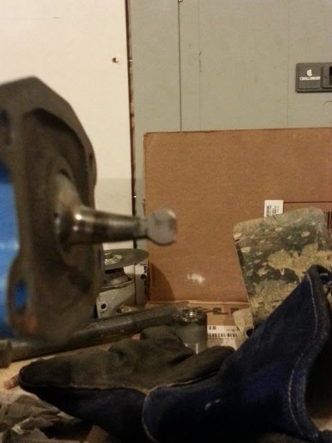

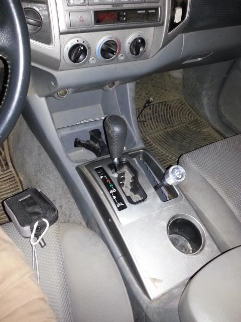

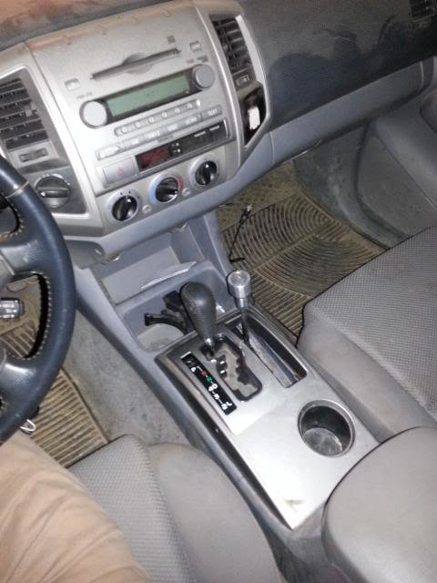

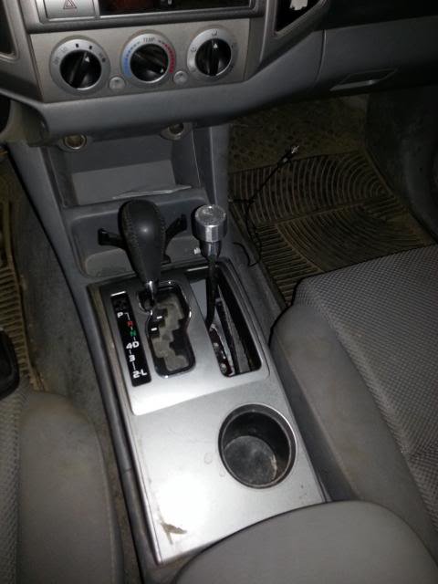

    So I have this problem in life of not leaving "well enough" alone. I reinstalled my shifter for the crawlbox and wasn't happy with the height or with the little bit of "slopo" the shifter had too it. Back out it came.
    First I removed 3" of height from the lever. Easy enough. Cut out a section of rod, bevel both ends, weld, file smooth, paint.

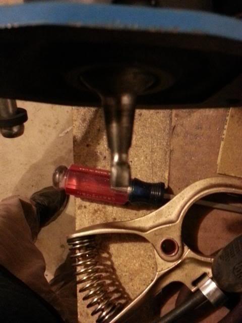

    Next was to remove the side-to-side slop in the shifter. Dropped a little bead onto the side of the shifter "tang" and filed smooth. Test fit, repeat until desired fit is achieved. :D
    Its hard to tell from the blurry pic, but I added material to the right side of the tang, about 3/64" of material.
    Then to eliminate some of the front-to-back slop I repeated this process on the front of the "tang" as well.
    Material was added to the top of the tang in the picture, then re-filed to profile.
    ***NOTE: The shifter components are hardened so use caution not to overheat them, and quench immediately after welding to retain strength properties.
    Re-installed the center console, grinding away the lower edge of the coin slot to remove only the bottom as I will utilize the sides to attach some rubber flaps to seal the shifter slot.
    Crawlbox HI
    Crawlbox LO

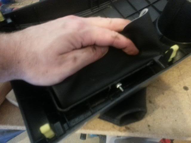

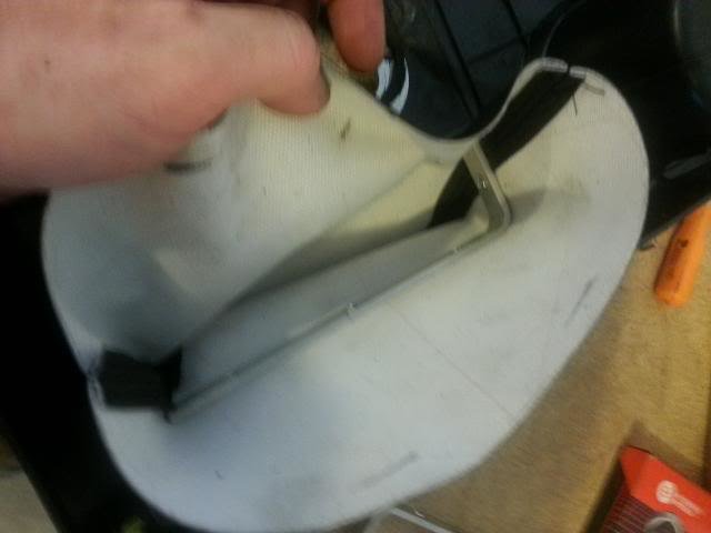

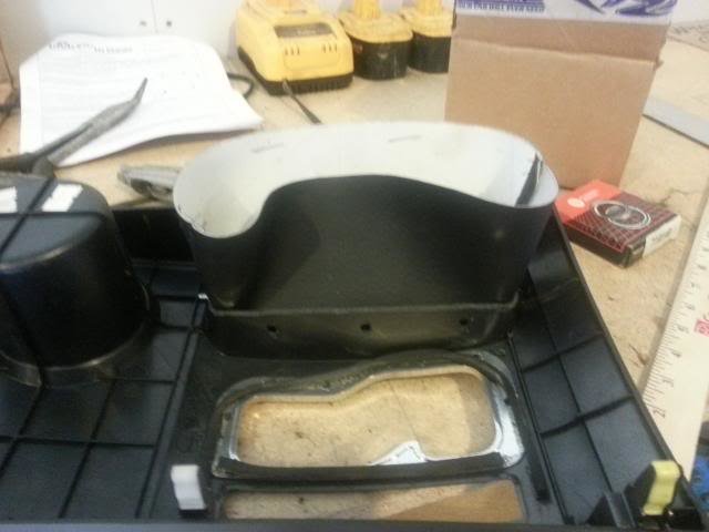

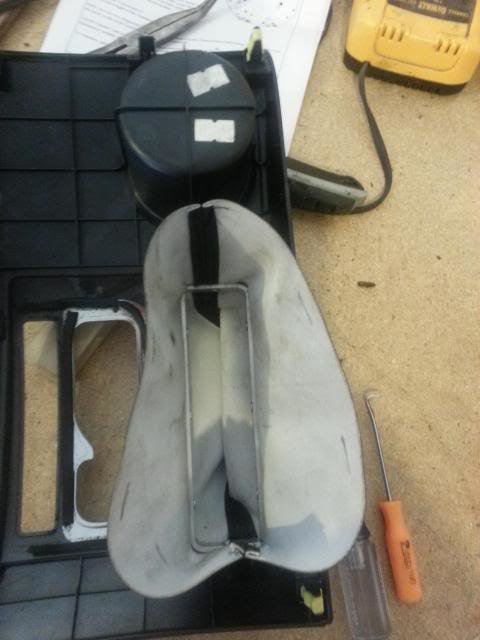

    So last week I ordered a shift boot off ebay, about the only one I could find all in black that I figured would work was for a Nissan 240z, cheap enough at $12.00 so I figured heck with it.

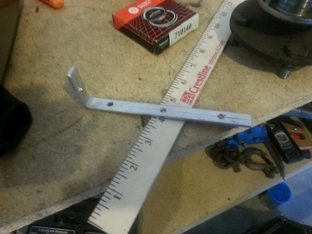

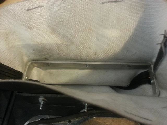

    Stuck the boot through from the backside:
    Made a few retainers from some aluminum strip...
    Test fit
    Added some #6 machine screws
    Trimmed the excess material:
    Then I trimmed off the excess machine screw shanks as well to clear the Tranny shift mechanism next to it.
    I still have a rubber boot to install at the tunnel opening to seal from water and debris. It from an '62-'67 MGB :D
