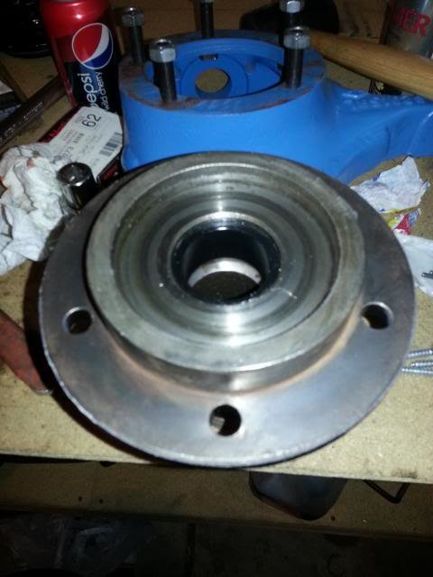

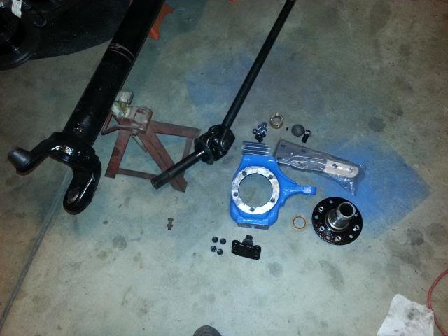

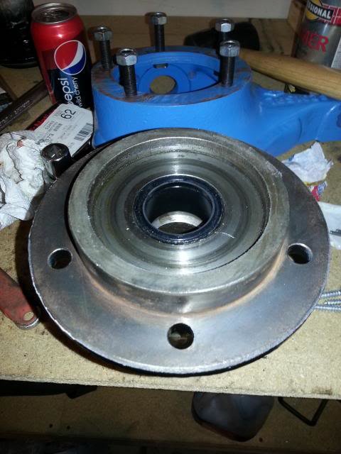

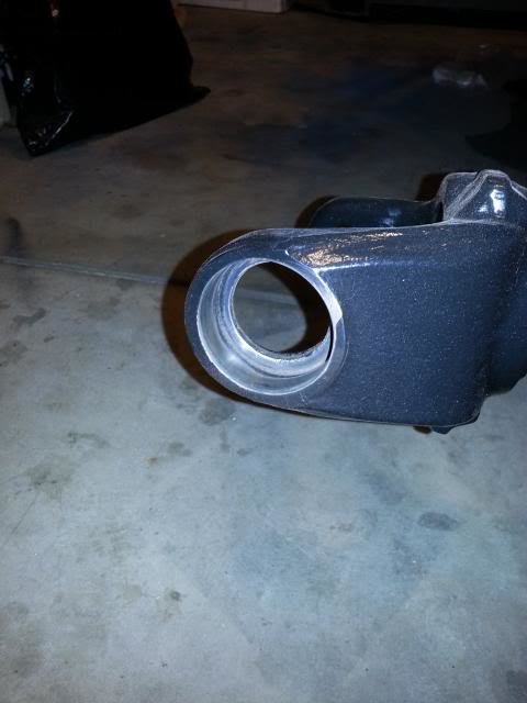

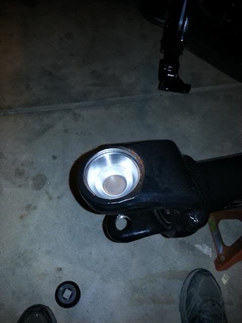

    Got a few minutes last night to work on the axle again.
    Lower bearing seat
    Cleaned
    Dust cap and outer race installed
    Greased bearing and seal installed

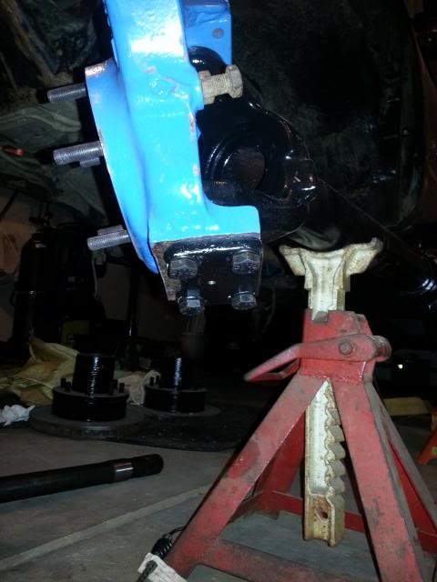

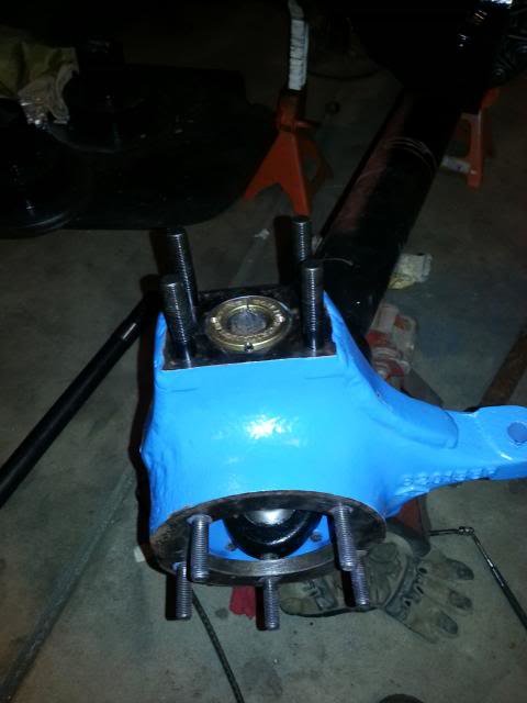

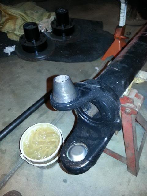

    Next was installing the new kingpins. The torque spec for these is 575 ft-lbs :eek:
    I used red loc-tite and got them as tight as I could
    Used the installation tool from ECGS (7/8" hex stock) allowing me to use a 7/8" socket and a breaker bar. Maybe its time for a 3/4" drive socket and breaker bar :D

    One of mine was loose to begin with, and the other was pretty stubborn. I cut half the kingpin away with the plasma and stuck a pipe wrench and a cheater on it. Came loose easy enough. Its harder holding the axle while you are trying to break it free.

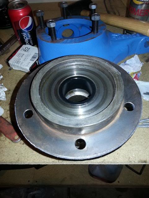

    Now that the kingpins were in I could start assembling the axle. Some of its gonna come apart again but I need to get it all dry fitted.

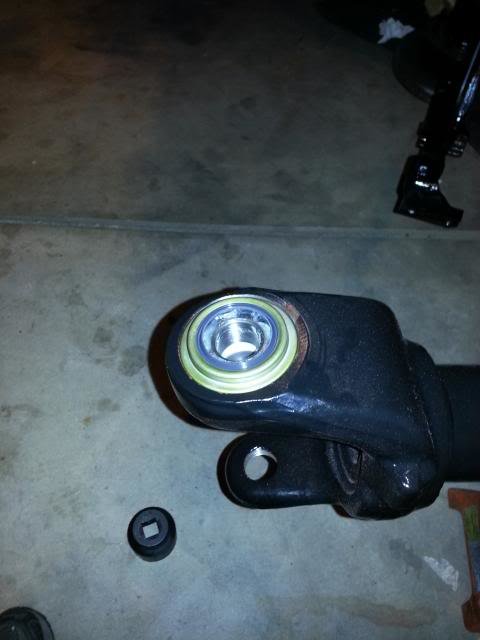

    Spindle bearing eliminator bushings (UHMW) from ECGS:
    Seated a little more so I could still run a seal;
    Seal installed:
    Dust shield and dust seal on axleshaft:

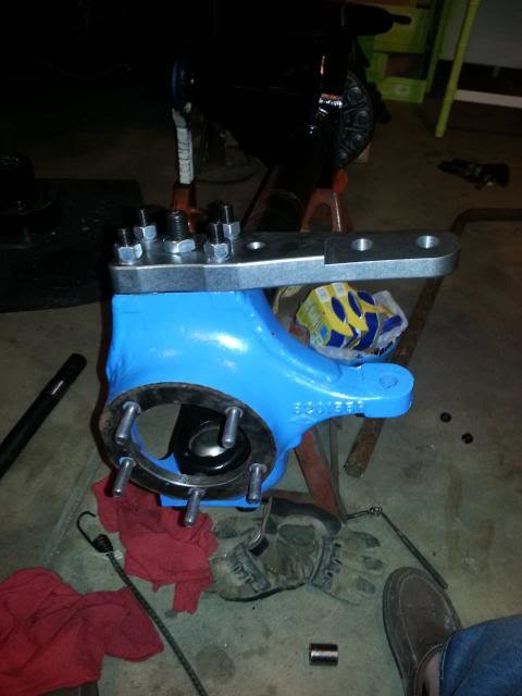

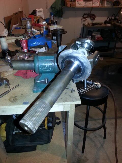

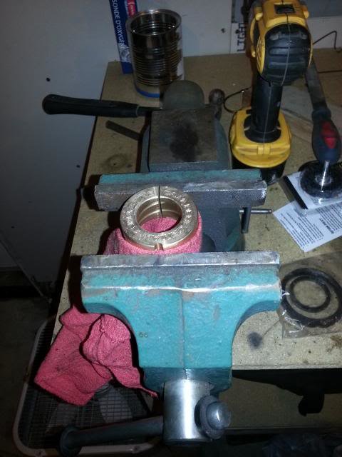

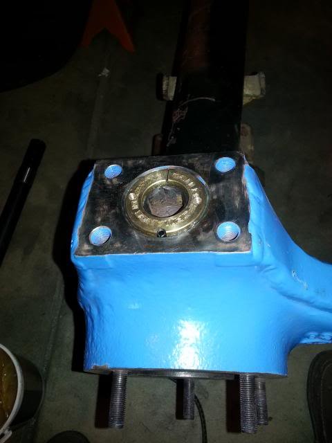

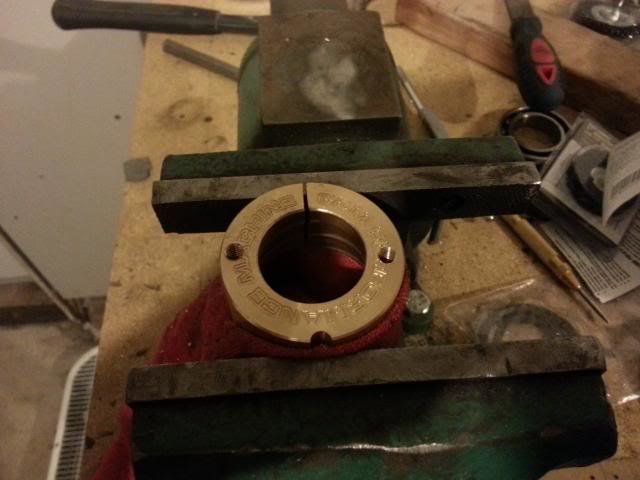

    I opted for the C&M Performance Machine Brass Kingpin bushings over the Reid Racing ones bc they were almost $60 cheaper :cool:
    One feature the Reid ones have are two tapped hole to thread some machine screw in to pull the bushing out of the knuckle when it comes time for maintenance. So into the vise my brand new bushings went:

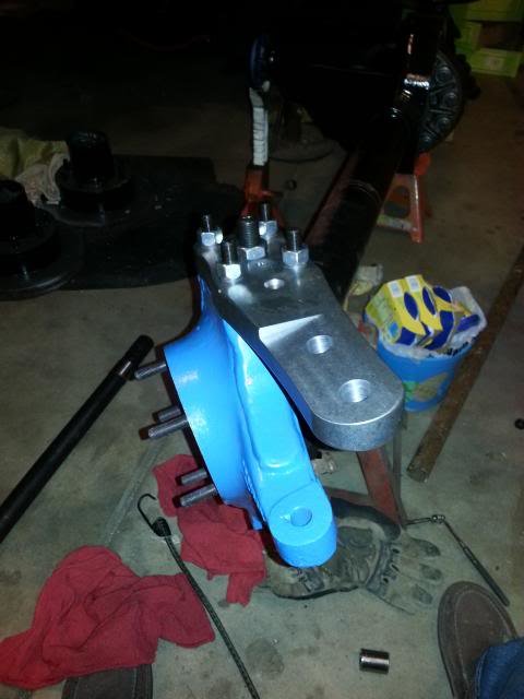

    Most of one side
    Steering arms are from chassis unlimited, media tumbled for a superb finish :D
    ARP studs for steering ams
    Yukon 35 spline inner and outer
  14. May 21, 2013 at 11:45 AM
    #474

    Greased up the kingpin
    Install lower cap
    Drop in the KP bushing
    Install the steering arm studs
    Torque down the steering arm and preload the KP

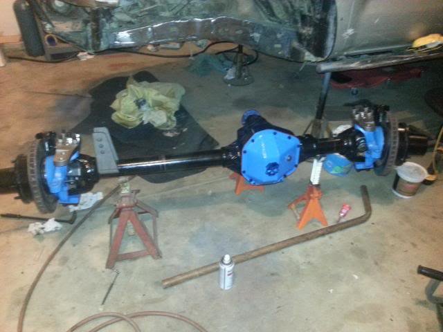

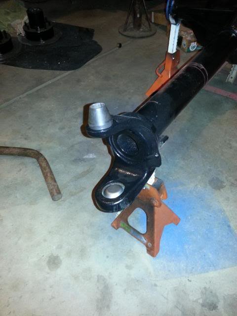

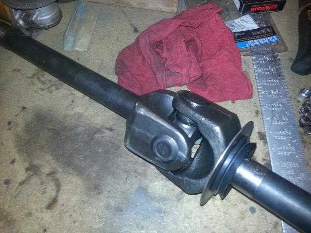

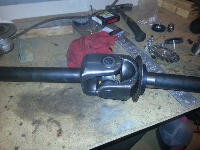

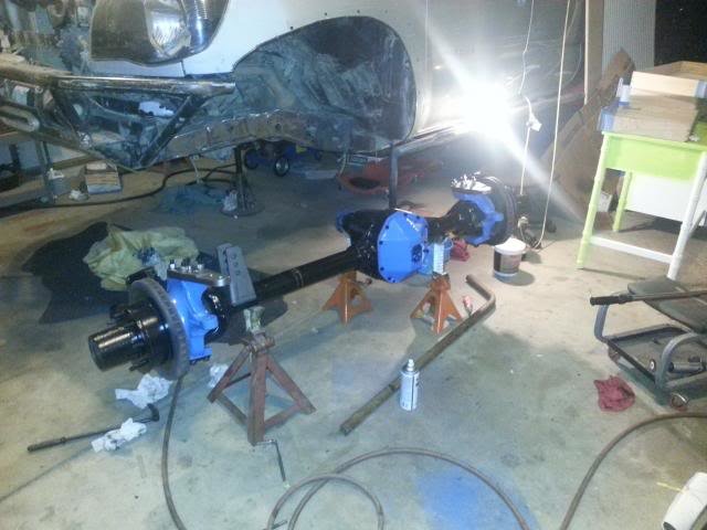

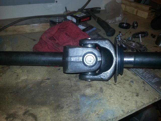

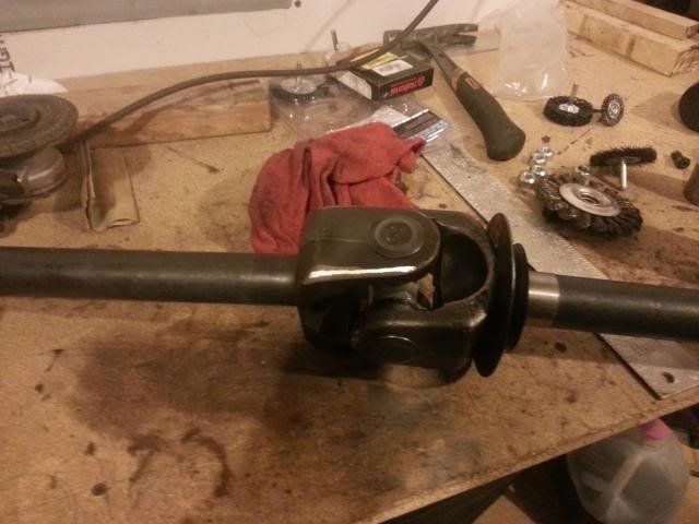

    Installed the shafts, caliper bracket, spindle, and hub to the passenger side then started on the drivers side.
    All was going well until I tried to install the axle shafts. The "yoke" on the inner wouldnt fit throught the knuckle. I had read of this happening before so off to the grinder I went.
    From there on went smoothly again.
    Complete minus lockouts and calipers.

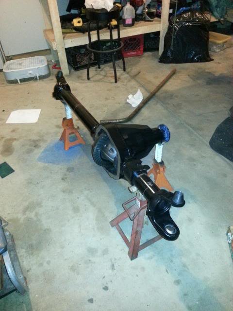

    As you may recall, this housing has been fitted with Ballistic Fabrications Dana 60 Shave Kit for those that dont http://www.tacomaworld.com/forum/2n...bulletproof-taco-1-ton-sac-9.html#post6044071
    Well after having my gears installed I had a slight problem:
    The cover no longer fit! :mad: Seriously...this cover had been a pain in the ass. When originally fitting it to the housing we had to enlarge several holes on it, and ended up half stripping a couple as well.
    I contacted ballistic and they sent me another cover. This time it fit perfectly. I chase all the threads on the cover bolts, and all the threads in the housing as well. Went together like butter.
