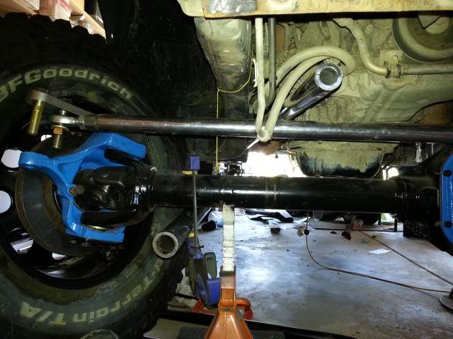

    I was gonna order the rings and weld them on myself at a later date but sooner is always better!
    On another note, I am about 2/3 of the way through designing the passenger frame rail bracket (consists of upper link and lower link mount), its all one piece, easily locates on the frame rail based on existing features on the frame. Some pieces will be duplicated for drivers side bracket which will only be for the lower link.

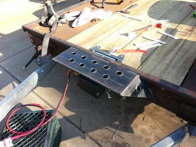

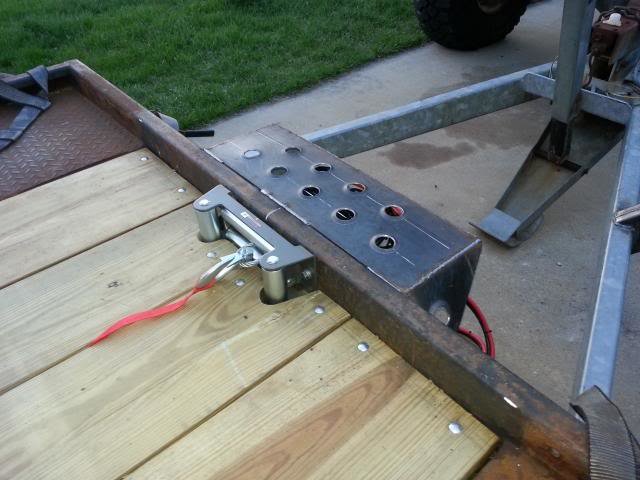

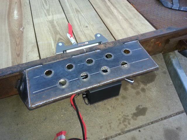

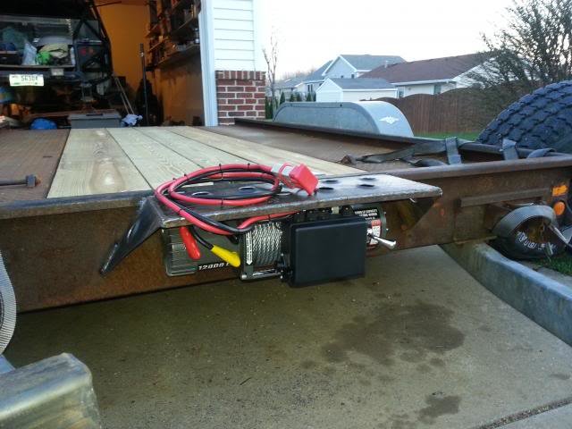

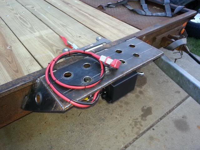

    Was and IS :D It was my pride piece until I did this a month ago for a friend...added the deck, winch and a winch step plate/solenoid cover. Cover was all one piece, dimpled it when flat, scored and welded up the bends.
    Just made this for the same guy:
    Mark and Jackie's Bed & Breakfast is officially closed to you sir! :p

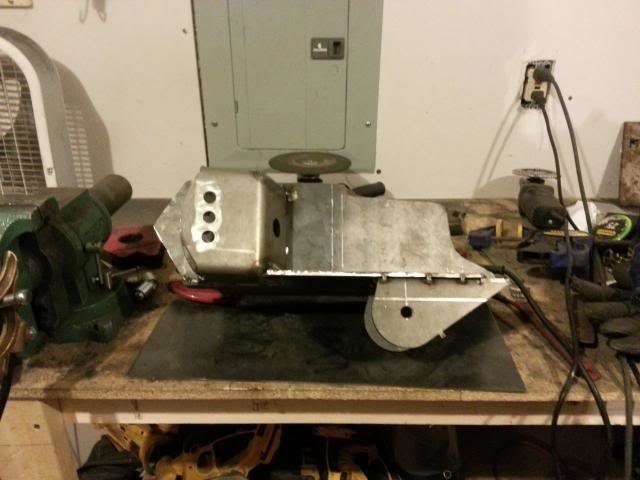

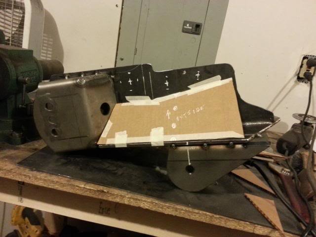

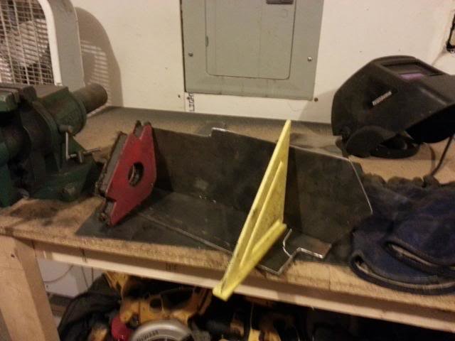

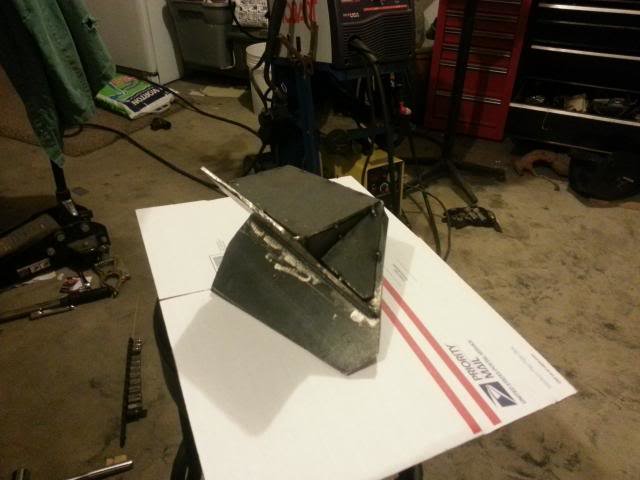

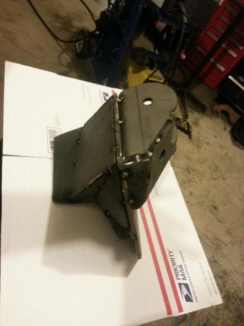

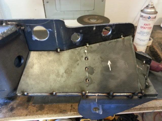

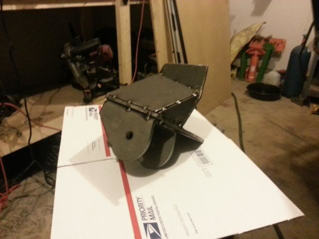

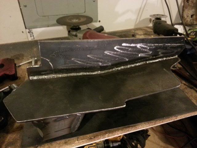

    Got a chance to get some more work done this weekend. I focused on getting my frame end brackets done. The lower links will mount below and inboard of the frame so they triangulate outward, and the upper will mount on the inside of the passenger framerail and triangulate inward towards the center of the axle.
    I started with the passenger bracket which will be the upper and a lower. First made frameplates of the inside and bottom of the frame. Everything will weld to this to make one bracket that will get welded to the frame.
    This is bent to follow the frame contour as well.

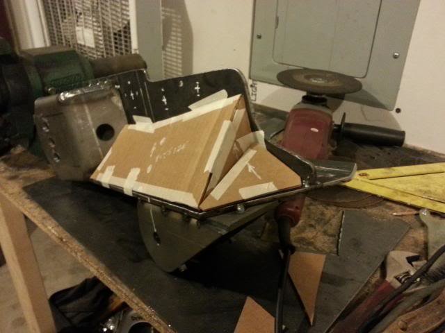

    Then I added my generic brackets from Ruffstuff and Ballistic:
    Then mock-up some cardboard:

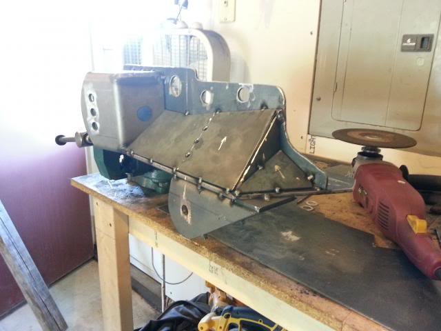

    Now make it out of steel :cool::
    Can't forget the plug welds to grab the internal gusset:

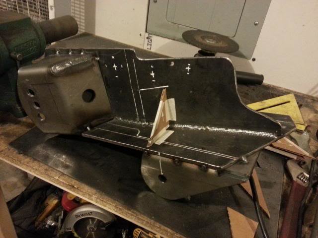

    Mock-up on the frame:

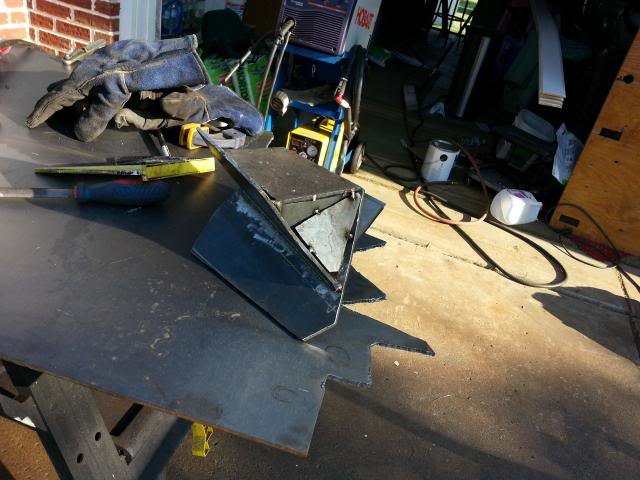

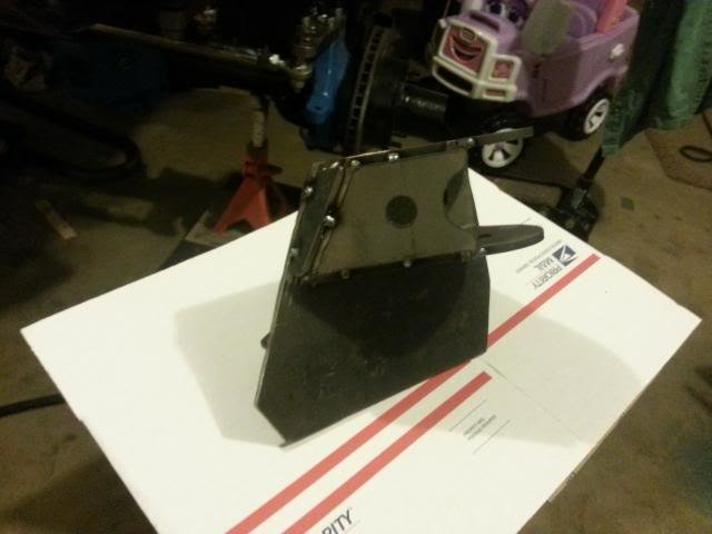

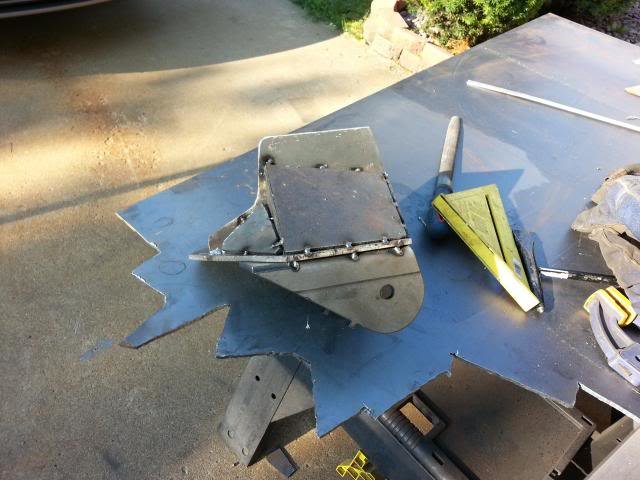

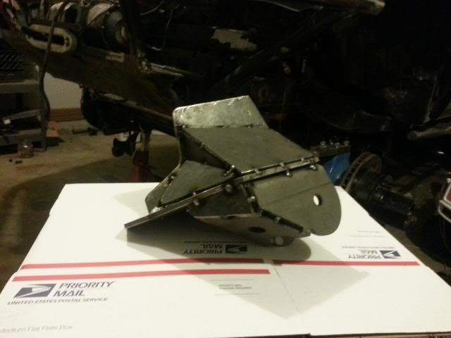

    The next step was easy...since the frame is symmetrical I cut apart my templates to make just the outrigger and gusset for the lower link mount:
    Clipped the corner off the lower bracket to finish it off a little more:
    Still need to add weld washers to this one and some plug weld holes in the frameplates but otherwise its done too.
    Passenger side bracket is 13 pieces and drivers side is 11 pieces :eek:
    These will get disassembled after cycling the suspension, and then fully welded upon reassembly. :cool:

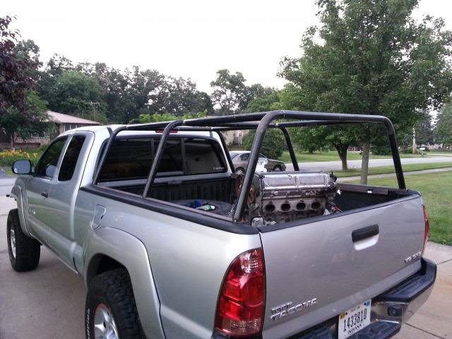

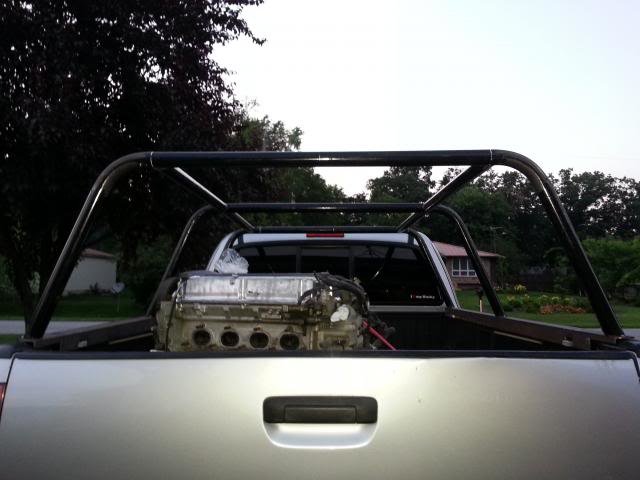

    Eventually its getting an Exo that will tie into the bed. For now I at least have a rollbar which is leaps and bounds ahead of having nothing so its not high on my priorities...
