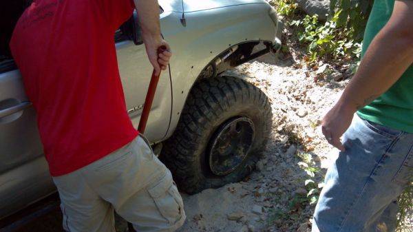

    Yeah lost a bead five minutes into the day on sat. I should have some good videos up in a day or two.
    Major carnage this weekend...Eric toasted a passenger side shaft in his 9" rear, no mods went thru two passenger side tie-rods (one was my spare), snd I once again bent another two All-Pro cv shafts...
