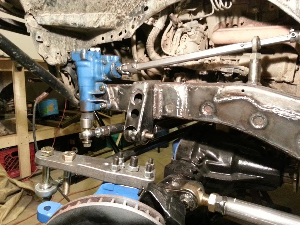

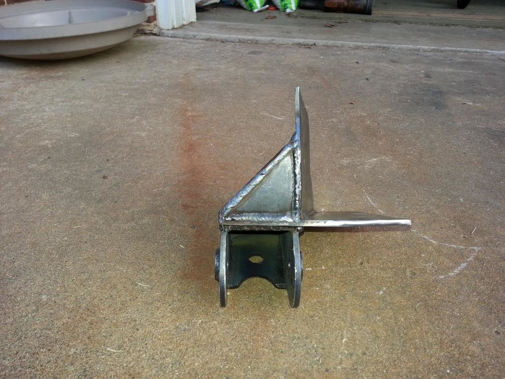

    Well both frame end lower link brackets are adjusted and at the exact same angle as the lower links.
    I also did some work on the frame end panhard bracket last night. I cut some of it apart and raised the bracket by 3/8" so the pivot is at exactly the same height as the pitman arm end of the draglink :cool:
    Also capped off the panhard mount with another frame tie-in as well. Cap plate is 1/4", scored and bent, then welded up.

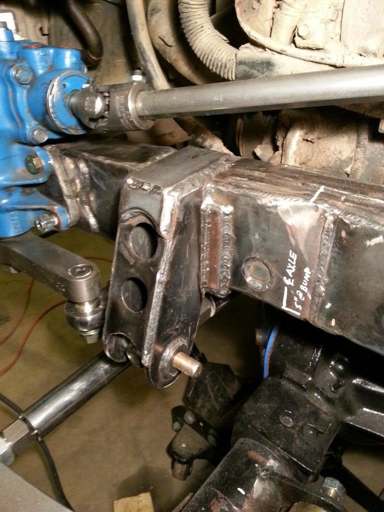

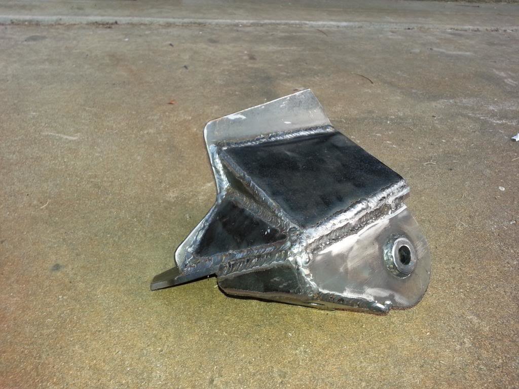

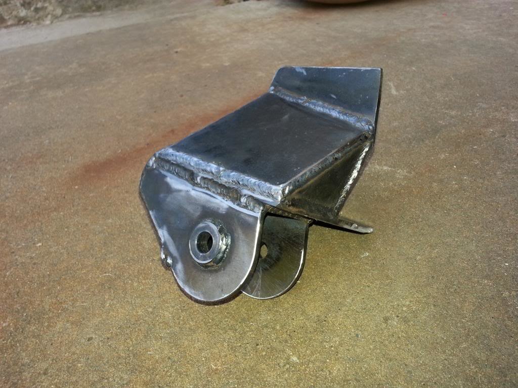

    Removed the drivers side lower bracket and welded it up solid:
    Its tacked in position back on the frame now. Gonna try to get the combo bracket on the pass side done tonight.

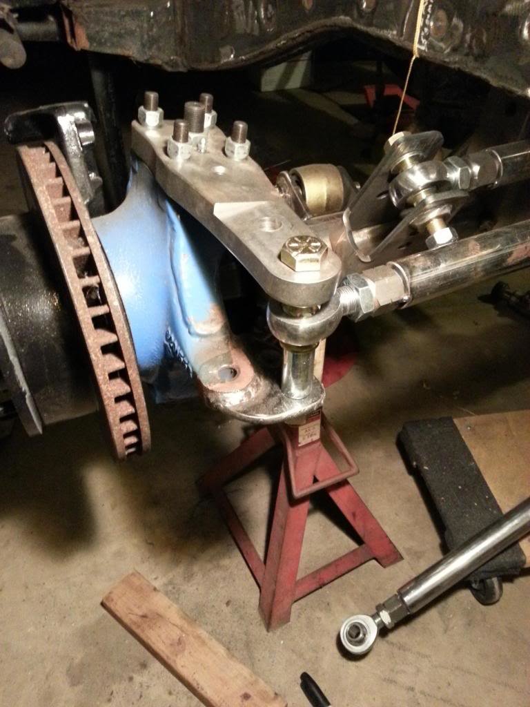

    Why thank-you kind sir.

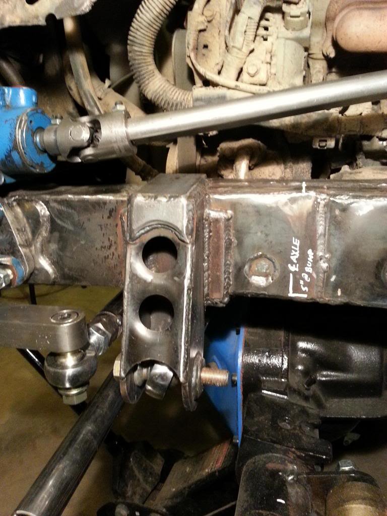

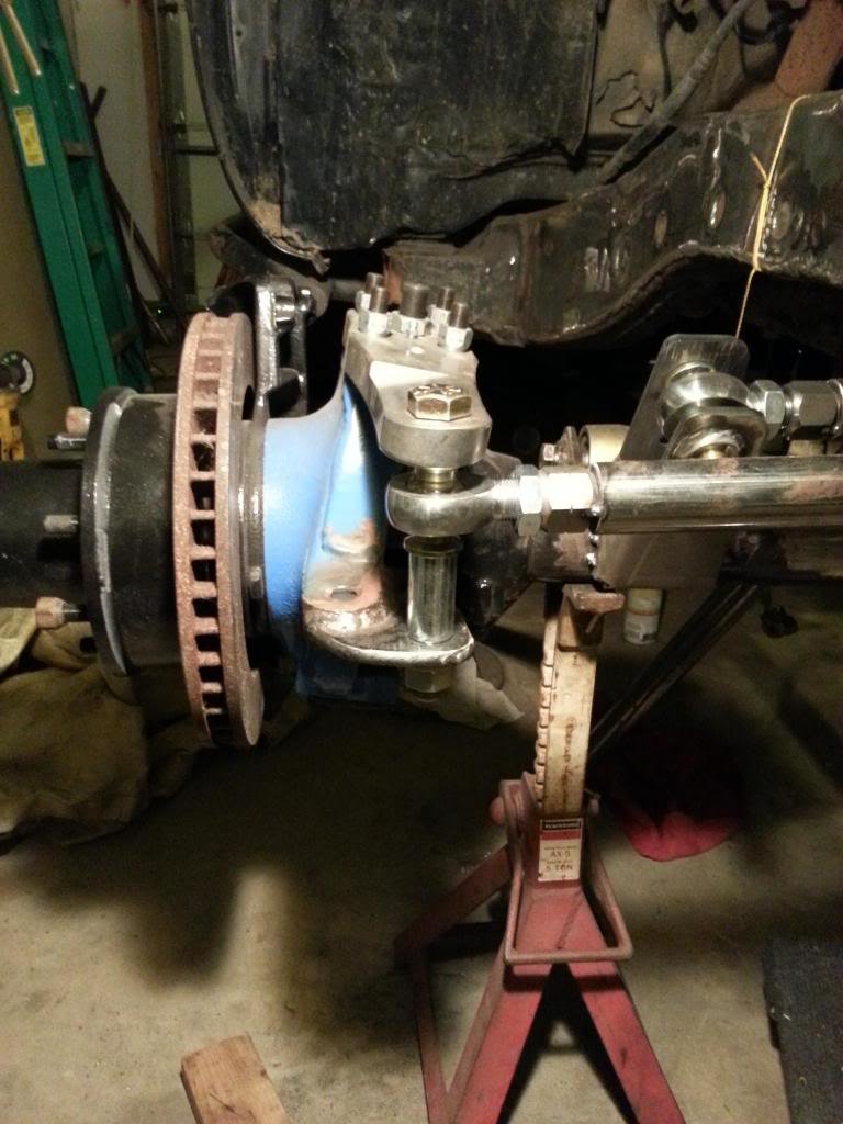

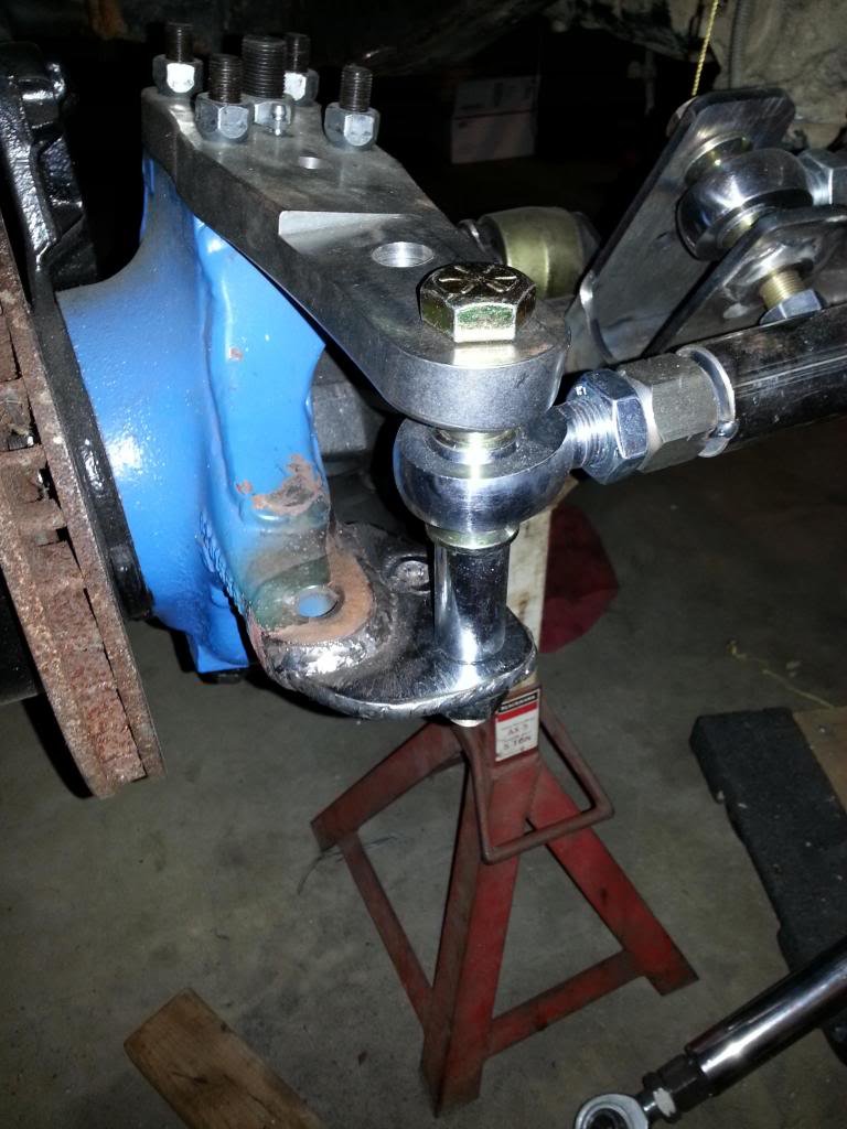

    Got the double-shear steering worked out this weekend. Plates are double layer 3/16" plug welded together, then fully welded around the perimeter, then bored for the 3/4" bolt. The steel spacer is mimicking the 7/8" Heim from the tie-rod.
    No pics of drivers side since it was still wrapped to slow cool from the post-heating :D.

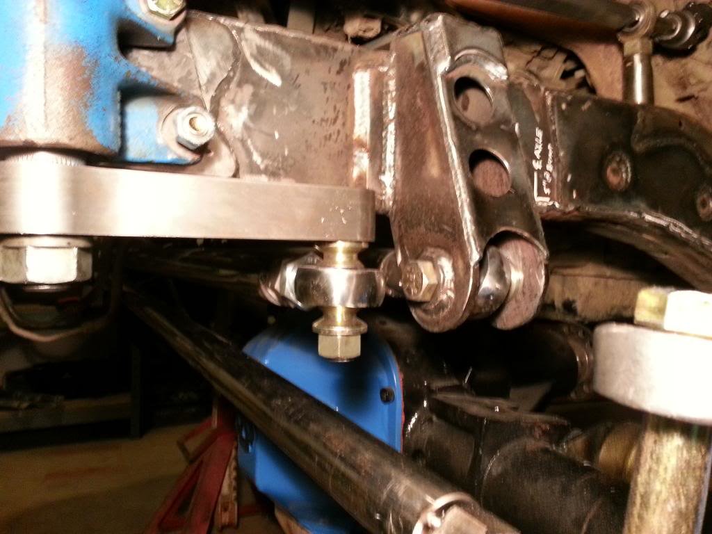

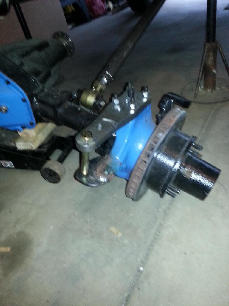

    Drivers side double shear:
    Bling:
