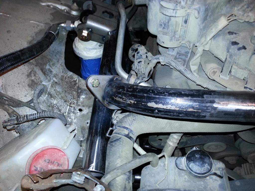

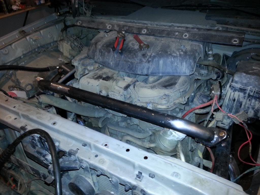

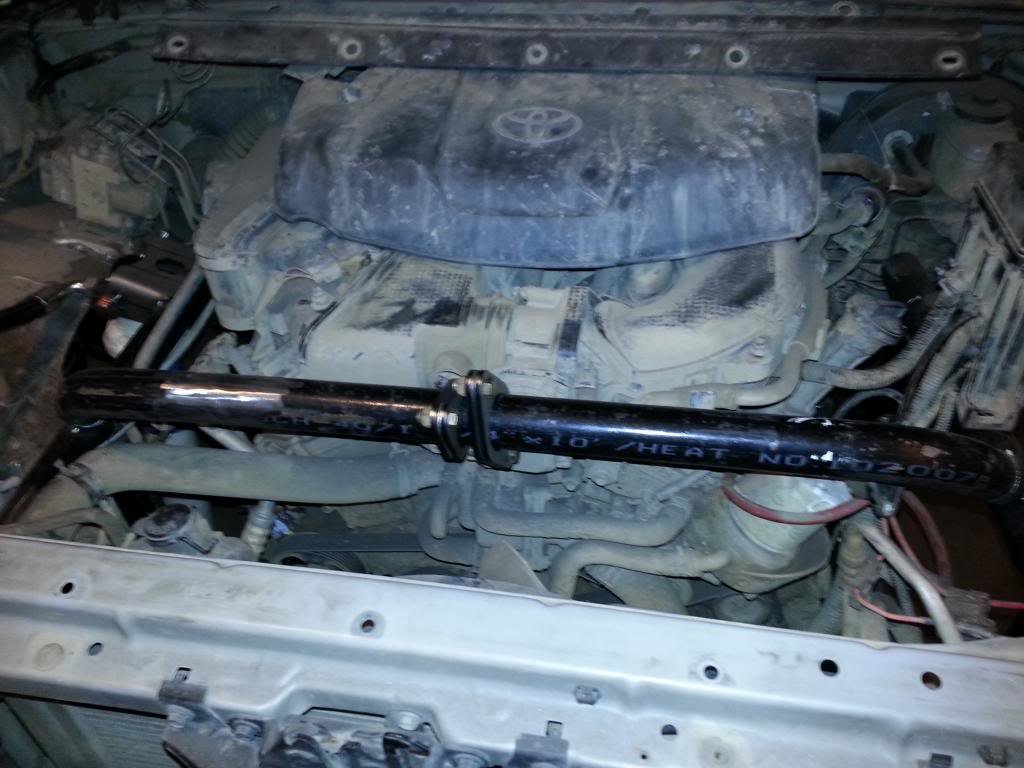

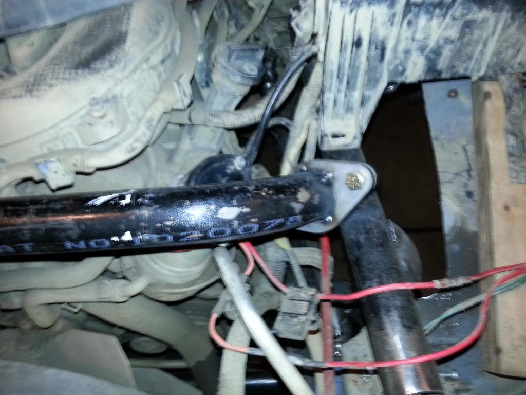

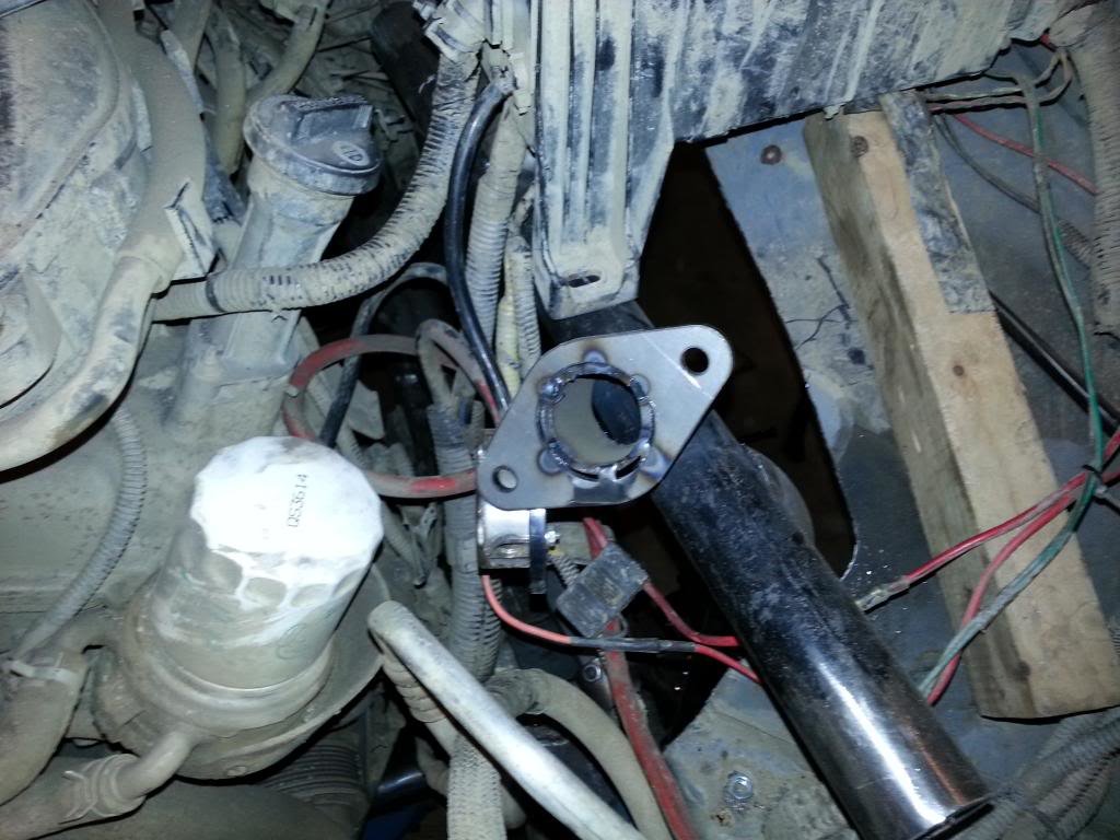

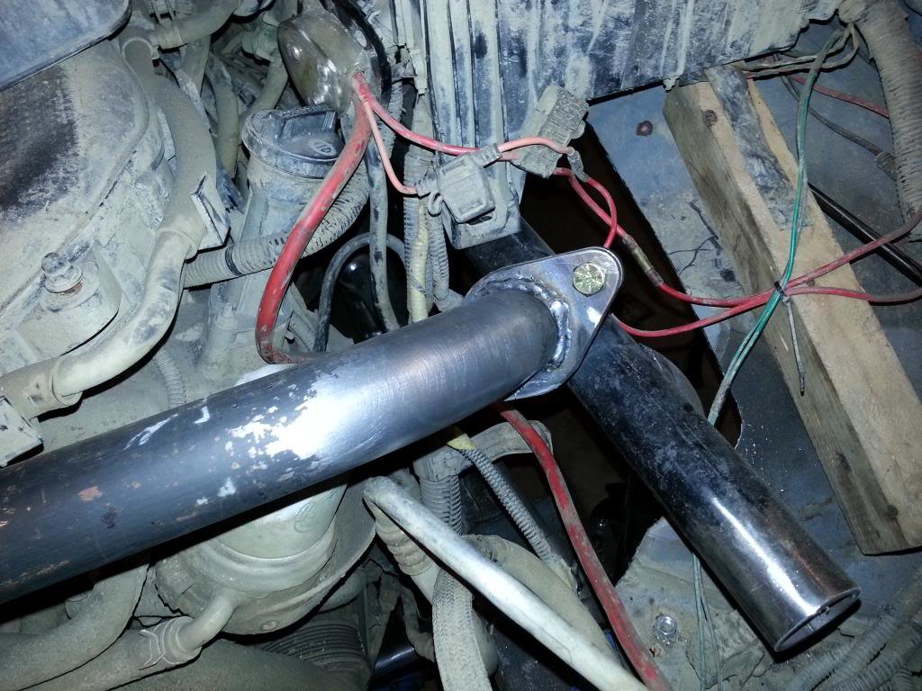

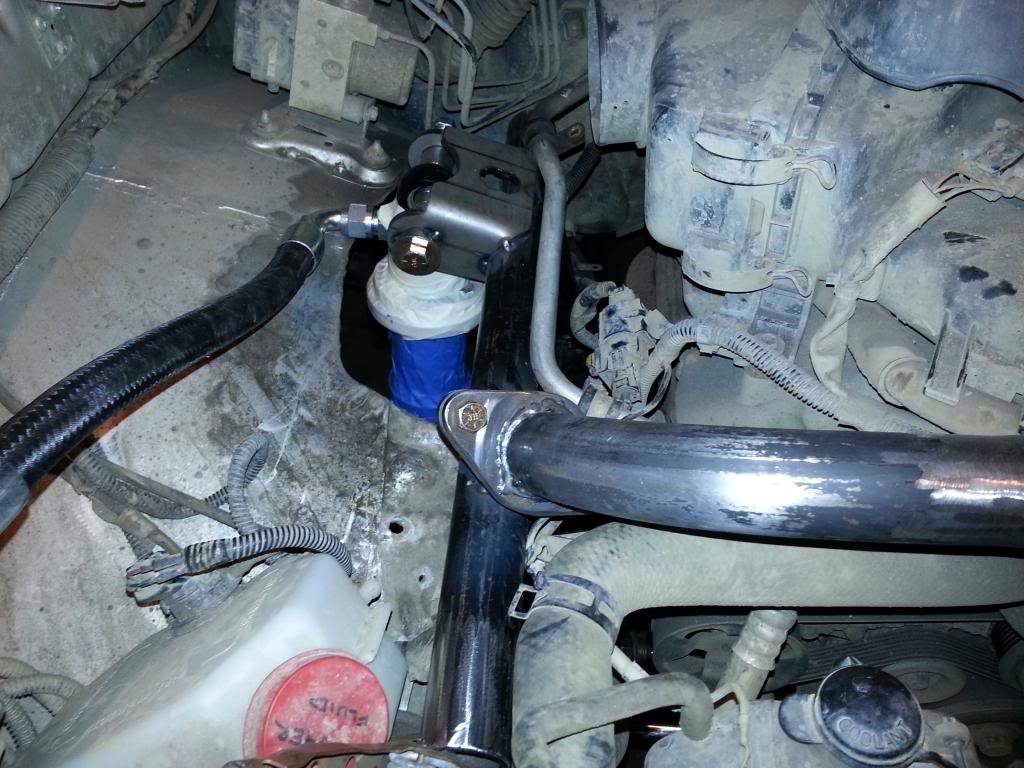

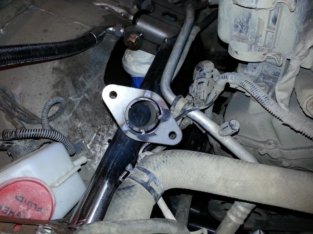

    How to make a removable cross member that fits perfect every time:
    Mark location of flanges on crossbar.
    Remove said crossbar.
    Cut 95% of the way through at each flange location.
    Slip flange pairs onto crossbar and reinstall (tack). I bolted the flanges together with a flat washer in between them to give me a little pull when I tighten the bolts at final install.
    Position flanges and tack into location. Both flanges at each end.
    Remove flange bolts. Place a pipe wrench on the crossbar and crack it right out.
    Add additional tacks where you can.
    Weld up the crossbar and clean it up a bit. Drops right back in.

    Good to know! Where did you get said flanges?
  7. Aug 8, 2013 at 7:50 AM
    #667
    NwiTACO
    NwiTACO [OP] Big tars, little/no bed.
    May 19, 2009
    #17416
    4,428
    Mark
    Indiana
    05 TRD Sport
    Custom Everything, 1 Ton Axles F & R
    Ballistic Fabrication...cheapest I could find.

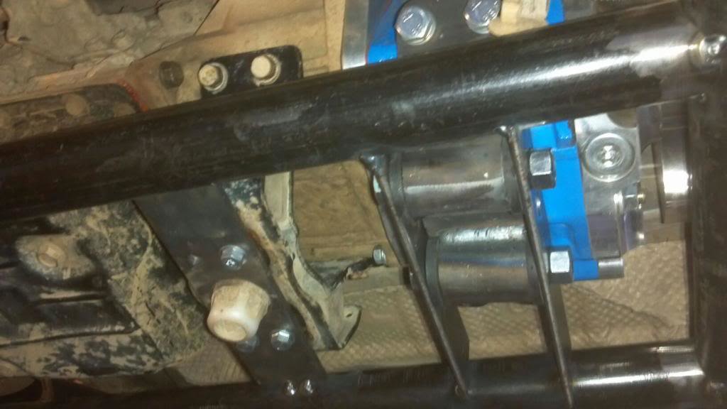

    Took a couple pics last night for you.

    Thanks mark! I'll have to look around for a set, or at least a standard set that i can modify to work as bolt-ups. definitely the way to go for those odd components.

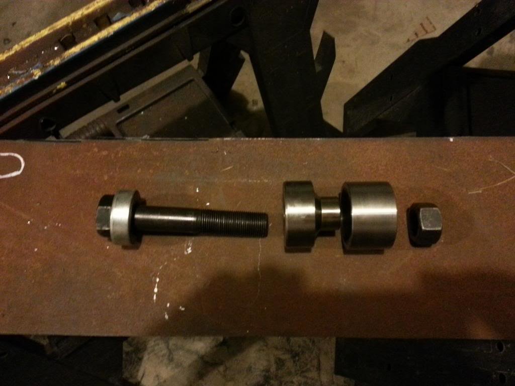

    Don't forget to dimple the small pieces when they are still part of a bigger sheet to avoid bending the piece.

    10-4, i've used dimple dies before, on small and large components, it's just always been with a big shop press.

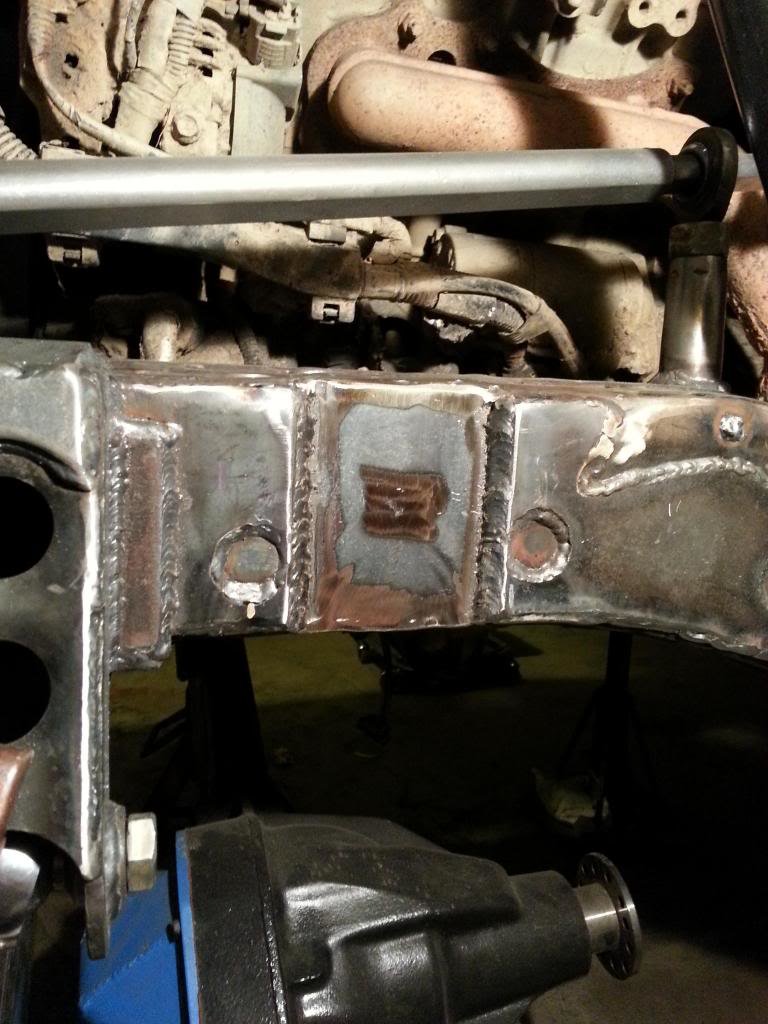

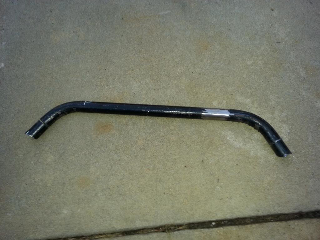

    Welded up the notch in the drivers side of the frame
    Removed and welded up the entire drivers side hoop and got gussets/caps ready

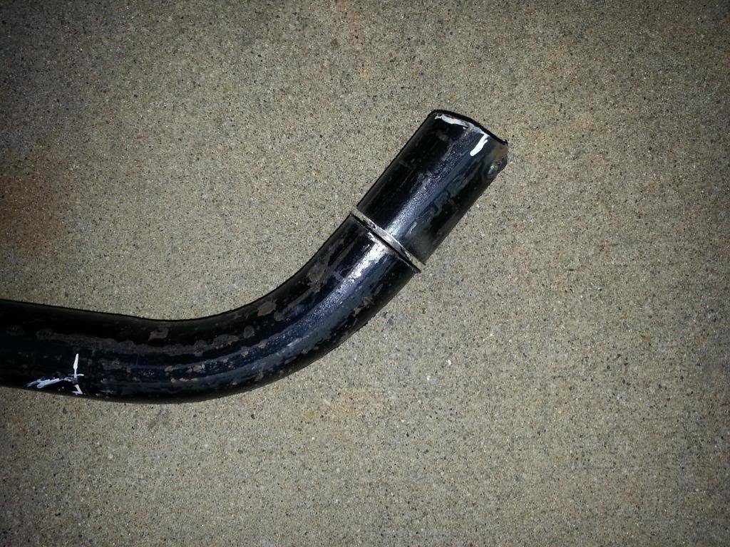

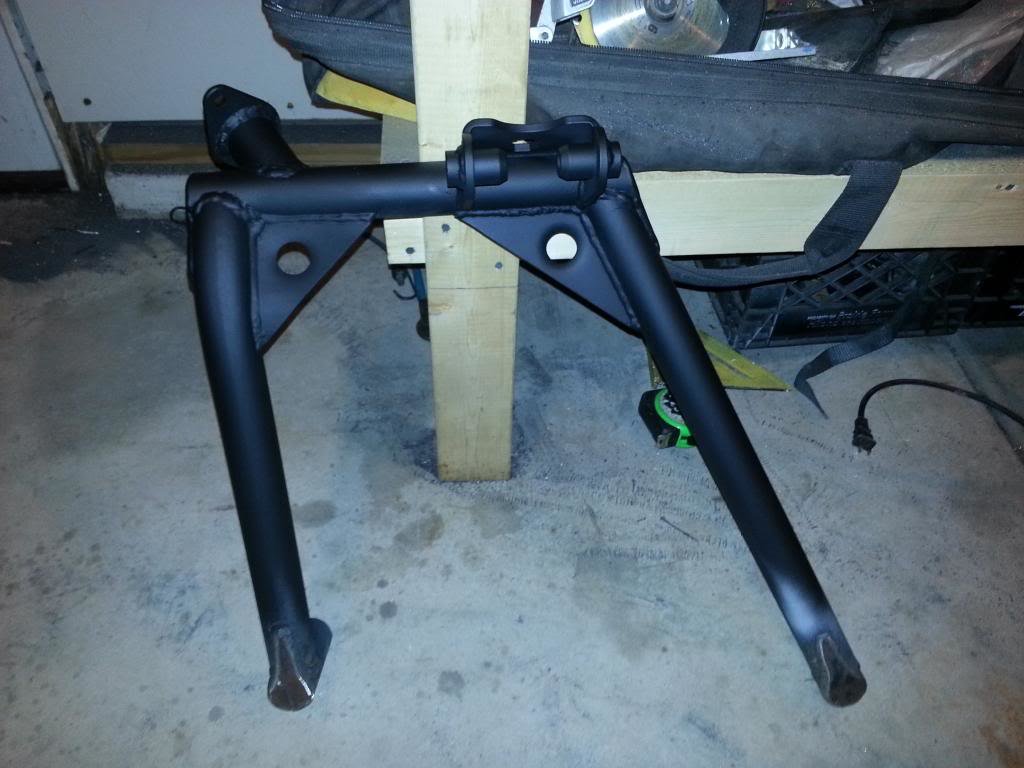

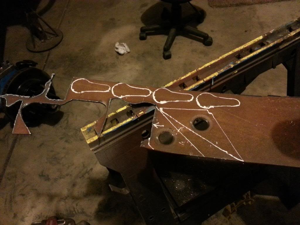

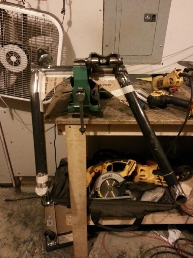

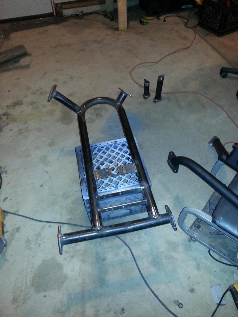

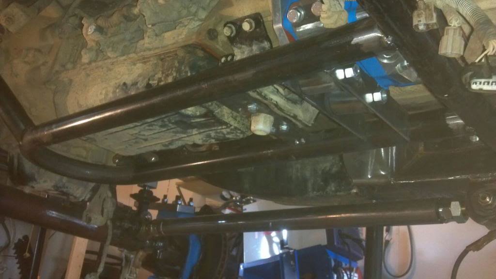

    Got some work done on the frame crossmembers/skids on Saturday:
    Resampled_2013-08-10_11-59-18_435_zpsfc4_28bec5252dc94958b2a3a6d86f868573c11de8e5.jpg
    Resampled_2013-08-10_11-59-24_988_zps3bb_a2c4172c428cd2a0e4a94156ff1a1a5210a8ae7d.jpg
    Resampled_2013-08-10_11-59-32_671_zps918_e318a04e1195554c8acc78d1a45f8bb99b806249.jpg
    Removed and welded up:
    Drivers side shock hoop removed, trimmed, gusseted, capped, painted, and ready to go in one final time;

    i need a 180* bender :drool:
    two 90s welded together ain't cutting it :rolleyes:
