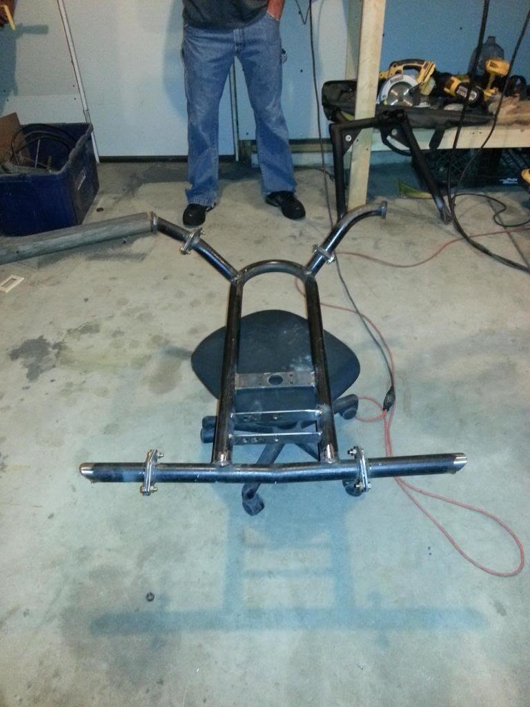

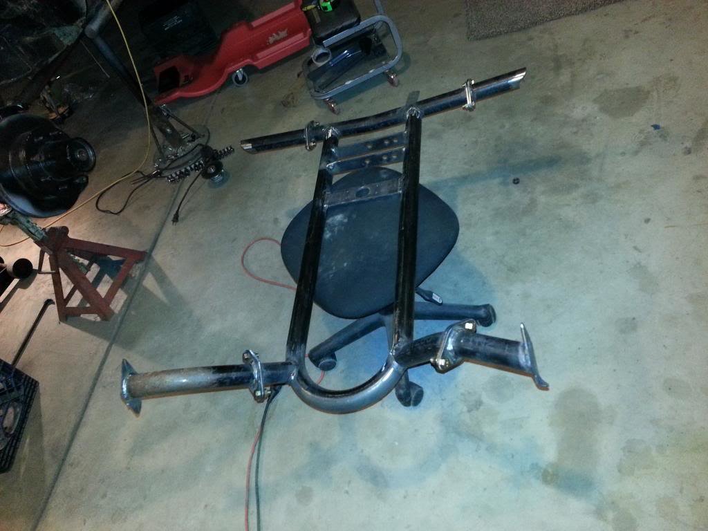

  9. Aug 14, 2013 at 6:39 AM
    #689
    NwiTACO
    NwiTACO [OP] Big tars, little/no bed.
    May 19, 2009
    #17416
    4,428
    Mark
    Indiana
    05 TRD Sport
    Custom Everything, 1 Ton Axles F & R
  10. Aug 14, 2013 at 6:47 AM
    #690
    Spoonman
    Spoonman Granite Guru
    Sep 11, 2011
    #63328
    9,810
    Jamie
    Alberta
    Nicely done. What are ya gonna plate it with on the bottom?

  12. Aug 14, 2013 at 9:19 AM
    #692
    NwiTACO
    May 19, 2009
    #17416
    4,428
    Mark
    Indiana
    05 TRD Sport
    I am currently using a combination of the harbor freight pipe bender and a JD2 bender.

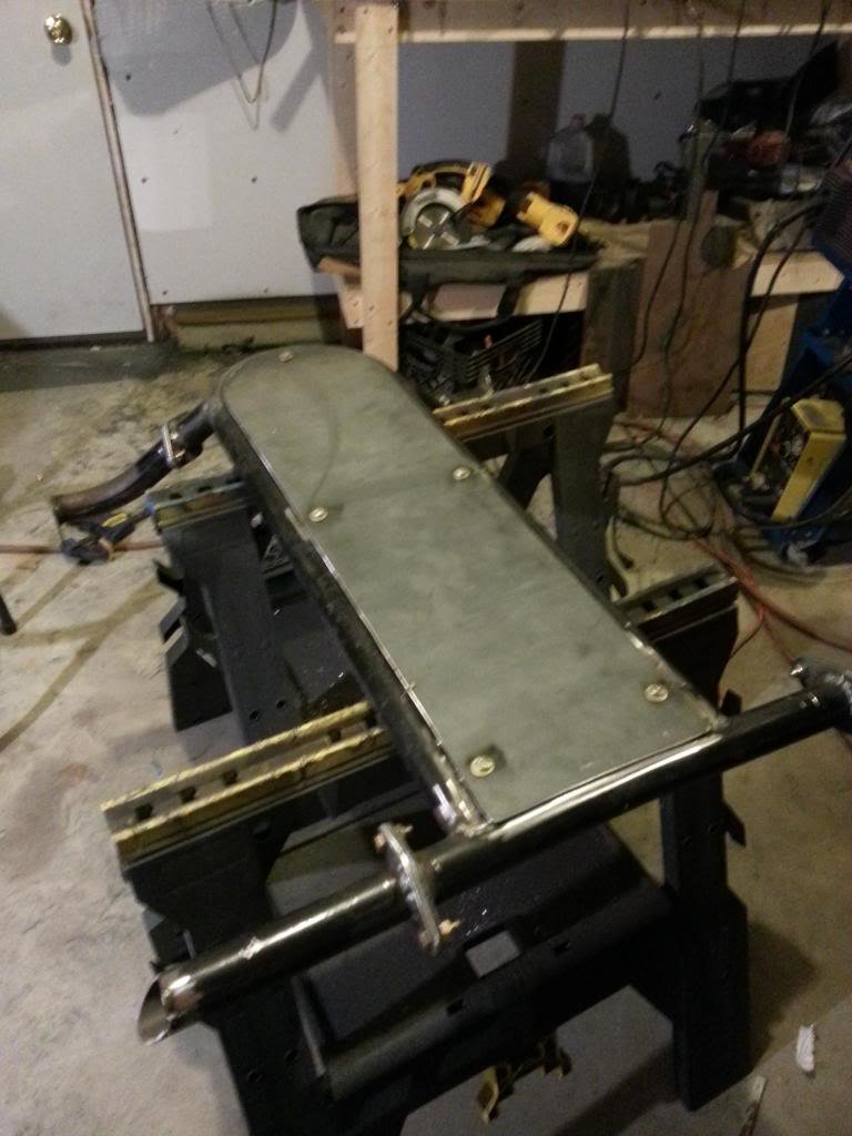

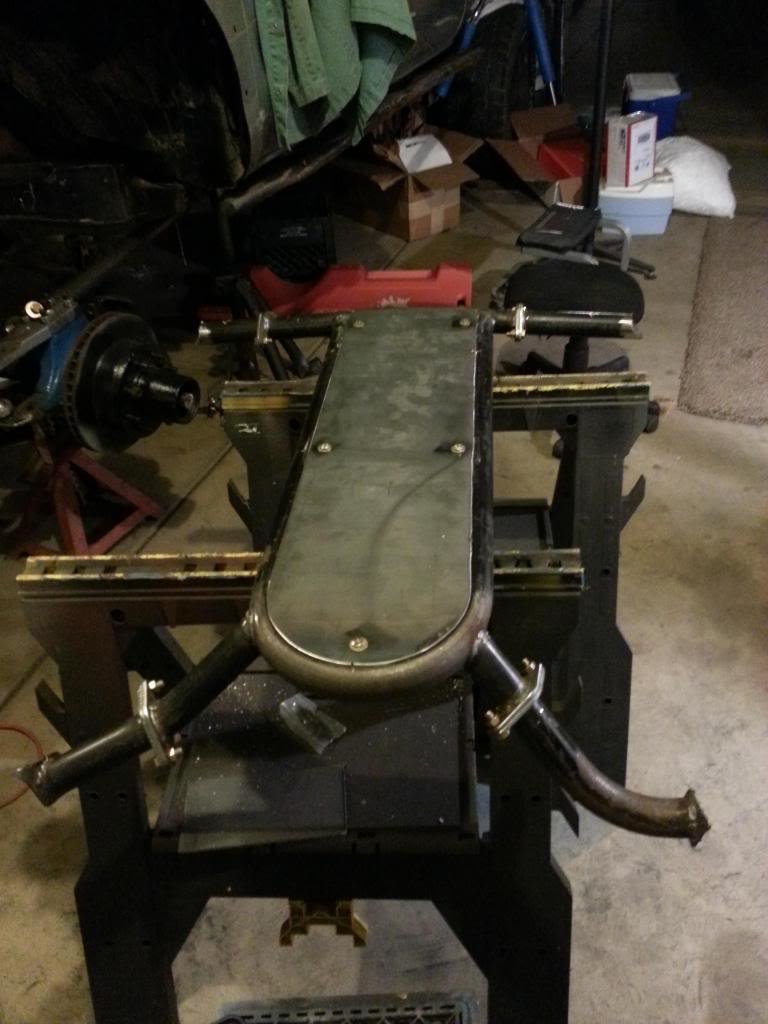

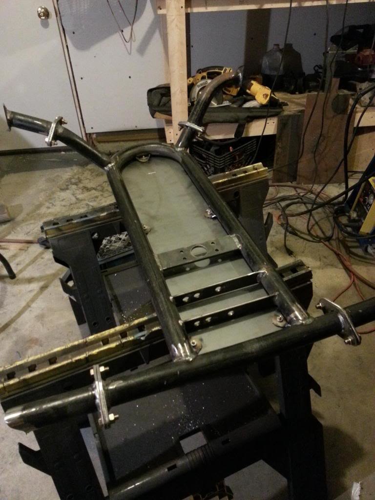

  13. Aug 14, 2013 at 9:20 AM
    #693
    NwiTACO
    May 19, 2009
    #17416
    4,428
    Mark
    Indiana
    05 TRD Sport
    Bolted on 1/8" plate, dimpled real nice :cool:
    Then it (plate) can be removed for fluid servicing, or the whole kit 'n caboodle can be dropped for driveline removal.
  14. Aug 15, 2013 at 6:43 AM
    #694
    NwiTACO
    May 19, 2009
    #17416
    4,428
    Mark
    Indiana
    05 TRD Sport
    And before anyone says I should've used countersunk fasteners go try to find some in 1/4"-28 thread because that's what the inserts in the threaded trick tabs from ballistic are. I looked at three places before giving up and just using gr 8 bolts.

  16. Aug 15, 2013 at 6:53 AM
    #696
    NwiTACO
    May 19, 2009
    #17416
    4,428
    Mark
    Indiana
    05 TRD Sport
    I was going to dimple a pattern in this but I think it looks good smooth too :confused:
  17. Aug 15, 2013 at 6:56 AM
    #697
    colinb17
    colinb17 If at first you don't succeed, don't try skydiving
    Jan 6, 2008
    #4127
    20,161
    Colin
    Charleston, SC
    '07 TRD Sport 4x4
    Build thread in sig... 4-link long travel
    i agree, and it's narrow enough that it's not going to bend as easily as a standard skid. might as well jsut run couple trusses on the back side if you're worried about strength, and avoid the potential for snagging that the dimples would create.
