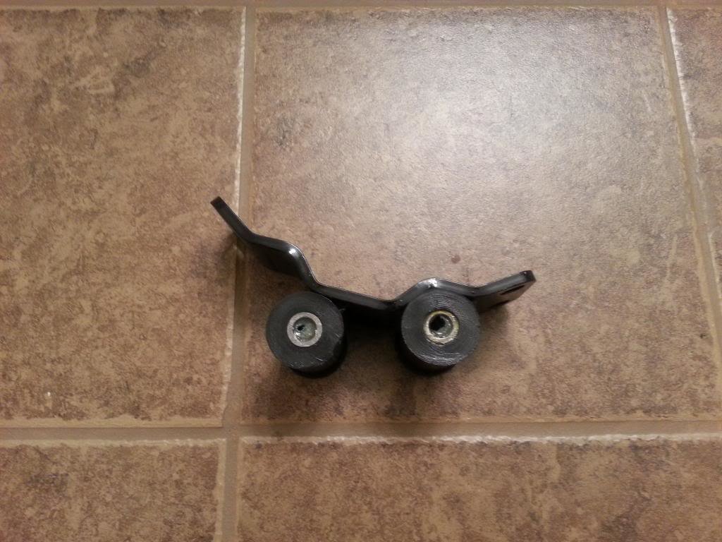

    Pic of modified upper portion of the 4x tcase mount:
    You can see by the mount what I meant when I said the crawlbox is clocked as well. I am about 1/4" from flat belly setup like this.

    Yeah... we clocked both... I guess we should of just done what you did. Would of probably been easier.

    Yeah but the shifter for the crawlbox cleared much better this way and was still fairly straight, if we hadn't it would have had to have a 90° dogleg in it
    So now I am wondering if I am clocked at 20°, oh well whatever I did worked. :D
