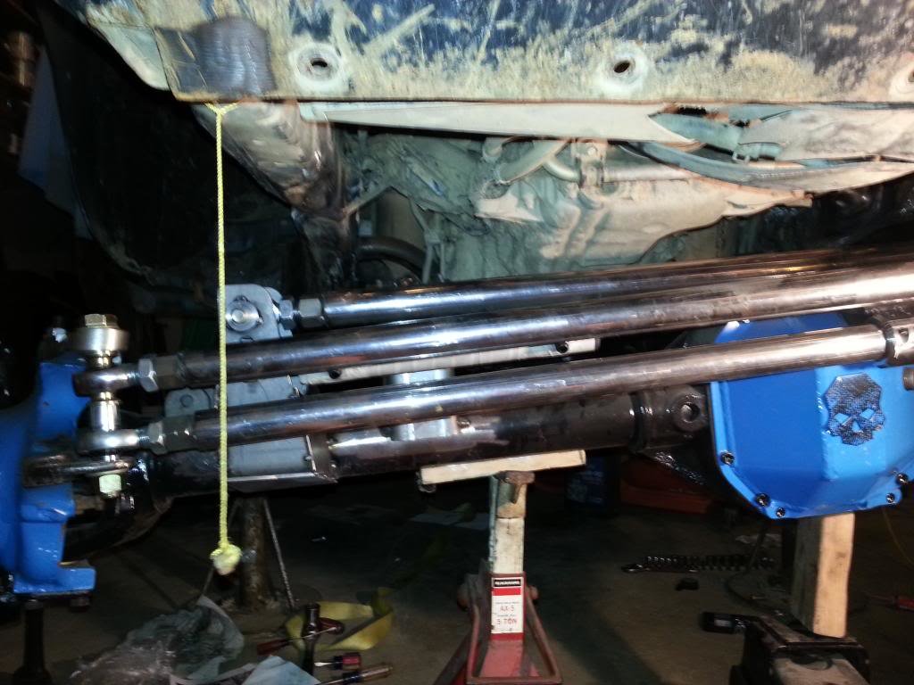

    So you're planning on duplicating that on the rear, right? after all, i thought you were just building this thing to do doughnuts.......

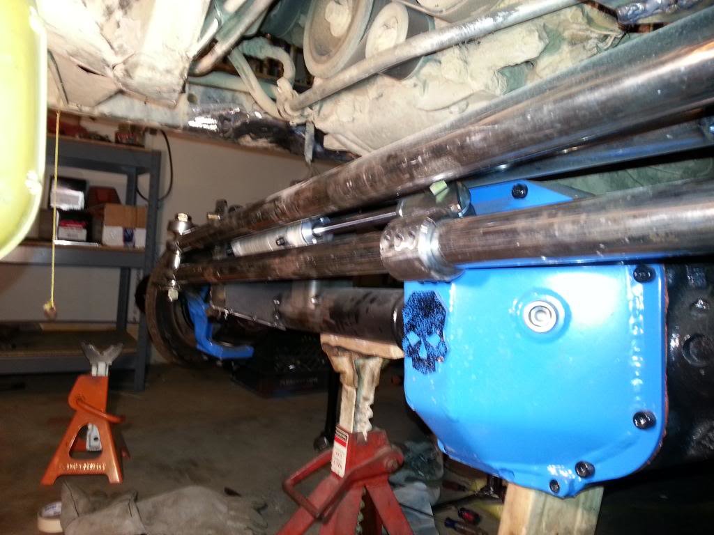

  9. Aug 27, 2013 at 10:01 AM
    #729
    colinb17
    colinb17 If at first you don't succeed, don't try skydiving
    Jan 6, 2008
    #4127
    20,254
    Colin
    Charleston, SC
    '07 TRD Sport 4x4
    Build thread in sig... 4-link long travel
    I like how it puts the ram on a pivot, instead of clamped to the axle. prevents side loading the piston and extends the seal life.

  11. Aug 27, 2013 at 10:30 AM
    #731
    NwiTACO
    NwiTACO [OP] Big tars, little/no bed.
    May 19, 2009
    #17416
    4,428
    Mark
    Indiana
    05 TRD Sport
    Custom Everything, 1 Ton Axles F & R
    Its also out of harms way and doesn't need a skid or anything for protection :D

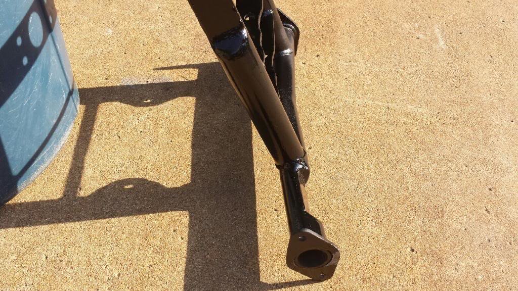

  15. Aug 29, 2013 at 1:02 PM
    #735
    NwiTACO
    May 19, 2009
    #17416
    4,428
    Mark
    Indiana
    05 TRD Sport
    So I am thinking about cutting out the resonators and eliminating them in my new exhaust. It will eliminate some work moving things around for clearance, but I don't want it to sound too awful.
    Anyone have any thoughts/experience running without the resonators???
  16. Aug 29, 2013 at 1:16 PM
    #736
    colinb17
    Jan 6, 2008
    #4127
    20,254
    Colin
    Charleston, SC
    '07 TRD Sport 4x4
    put a single, larger resonator further back, after the y-pipe? parent's '01 sequoia came like that and it worked well.

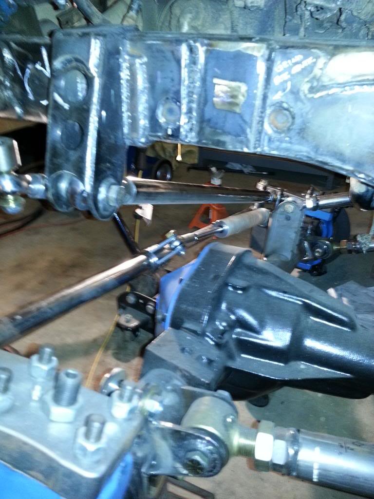

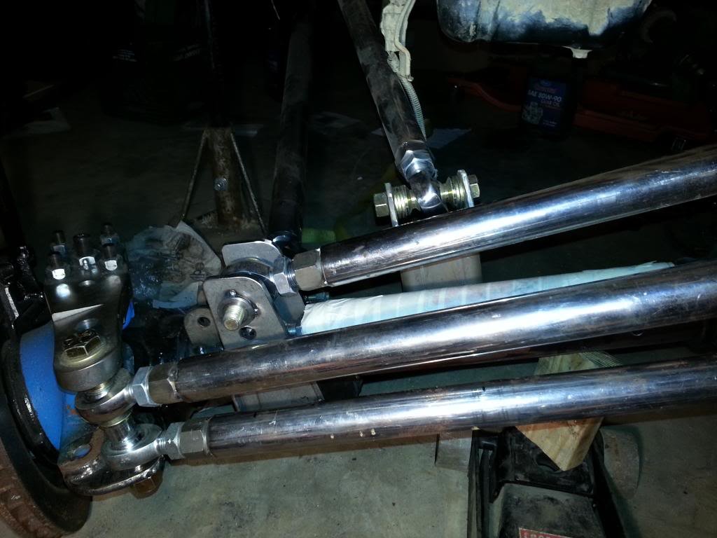

  17. Sep 4, 2013 at 7:33 AM
    #737
    NwiTACO
    May 19, 2009
    #17416
    4,428
    Mark
    Indiana
    05 TRD Sport
    Thinking I am gonna ditch them for now and I will save them in case I want to add them back elsewhere in the system.

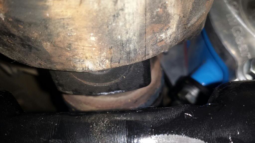

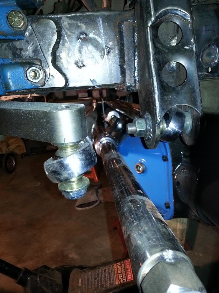

    1 Ton T1oo Master Cylinder has 1-1/16" bore instead of 13/16". Had to modify and remove two of the four mounting point on it, and extend the pushrod 2-7/8".

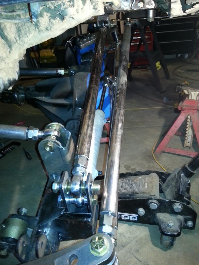

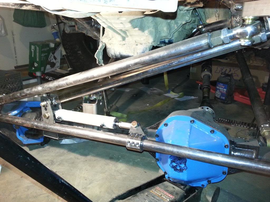

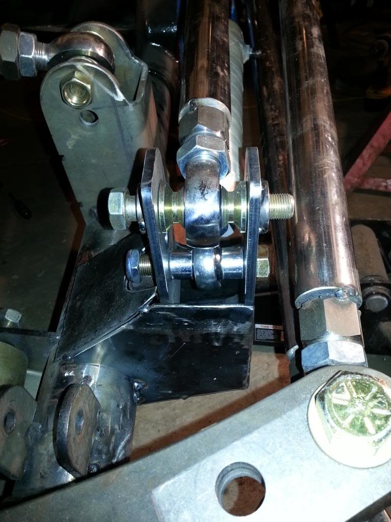

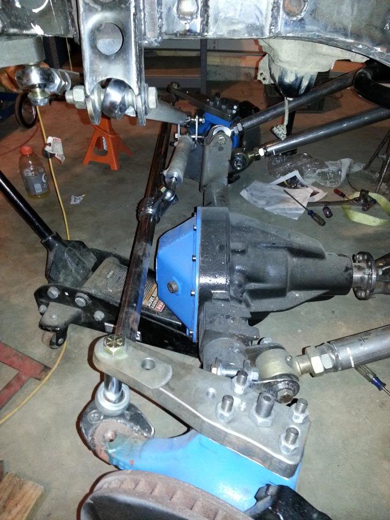

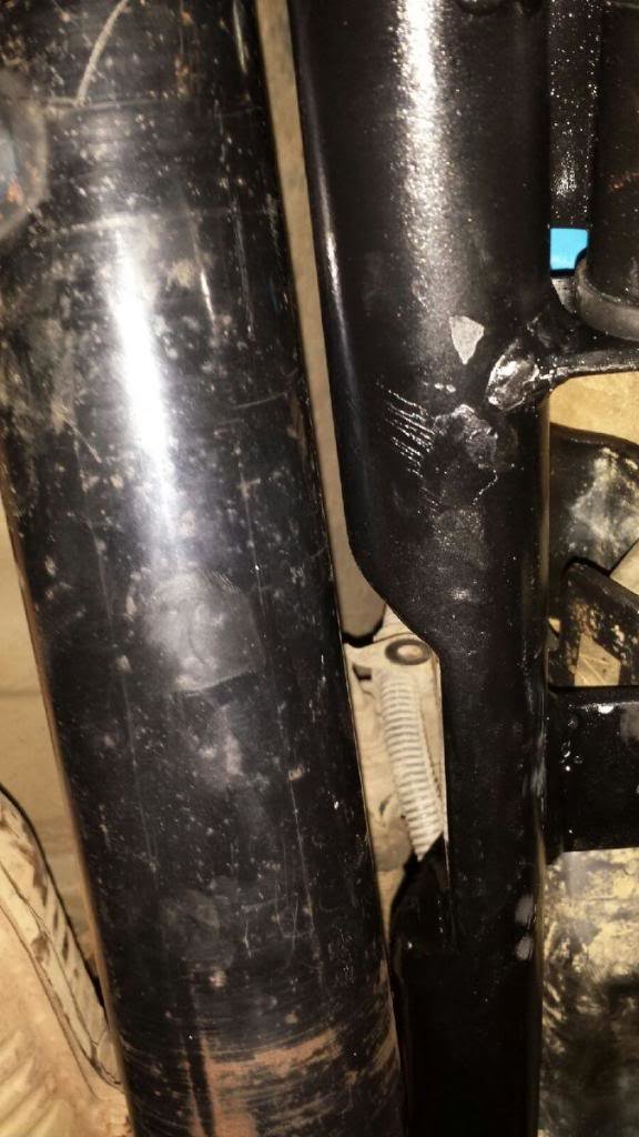

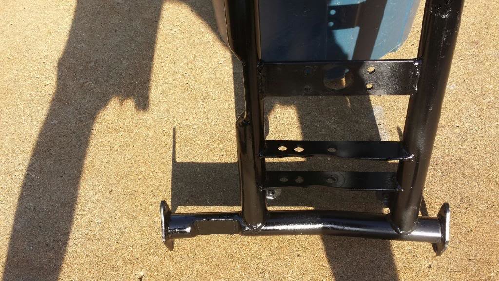

  20. Sep 4, 2013 at 8:27 AM
    #740
    NwiTACO
    May 19, 2009
    #17416
    4,428
    Mark
    Indiana
    05 TRD Sport

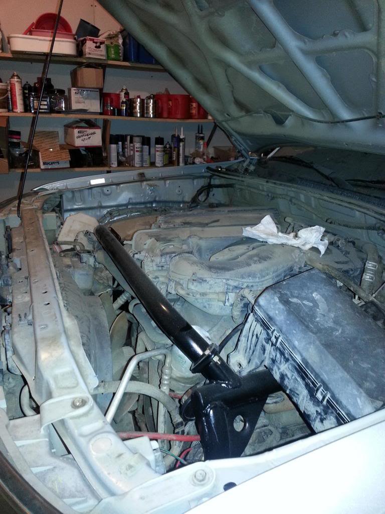

    Eric came by last Friday to lend a hand again and we got some more things done too.
    Hoops and crossbar final installed and welded:

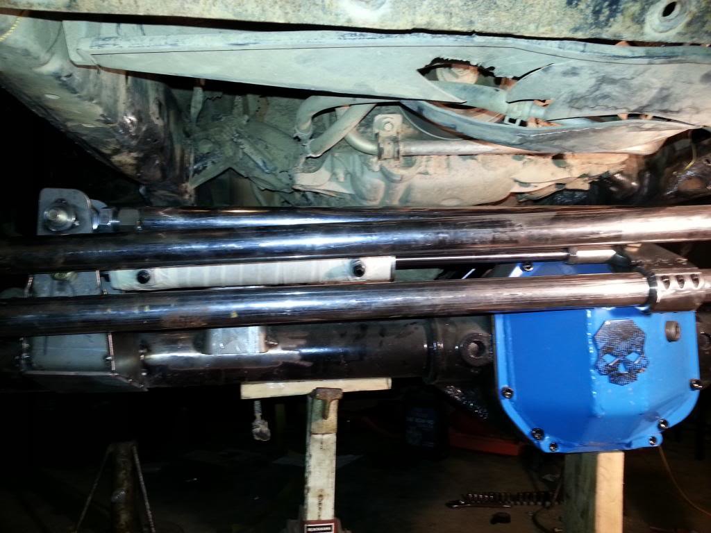

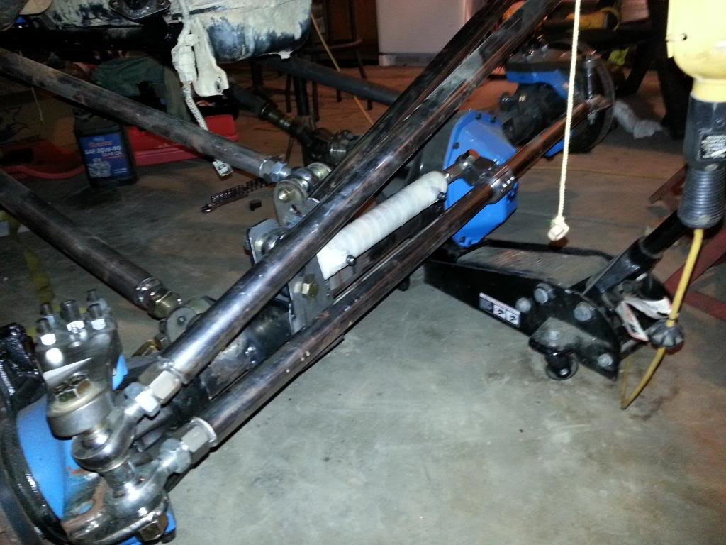

    Then installed the shocks and front DS and cycled things one last time before teardown. Good thing. The was a slight interference between the crossmember and the double cardan joint, and the DS was kinda close to the side of the skid too. So we made more room. :D

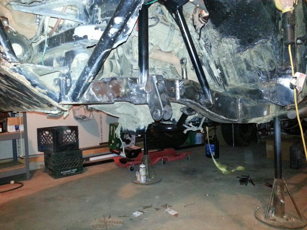

    Installed:
    And then we did this:
