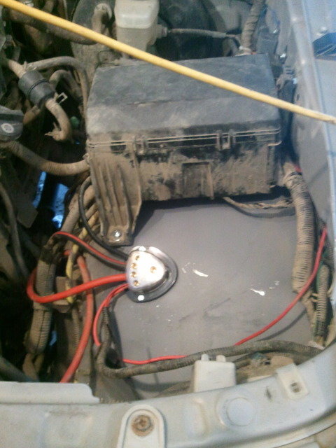

    Battery in the bed?

    Its been back there since I tubbed a while back.

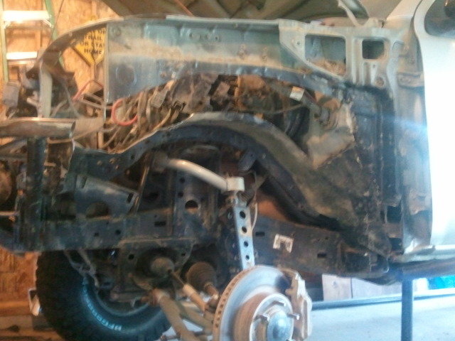

    Man, i could use that kind of roo under the hood.

    If you think that's a lot you should see the pass side! :D

    you relocate the washer fluid and ABS block?

    No more ABS, small washer resi, now PS resi will move too.

    That's a sweet little distribution block in that last picture

    Haha had to use something. Main power wasn't run yet either. It hard finding a distribution block that can handle 00 gauge and several large gauge outputs too.

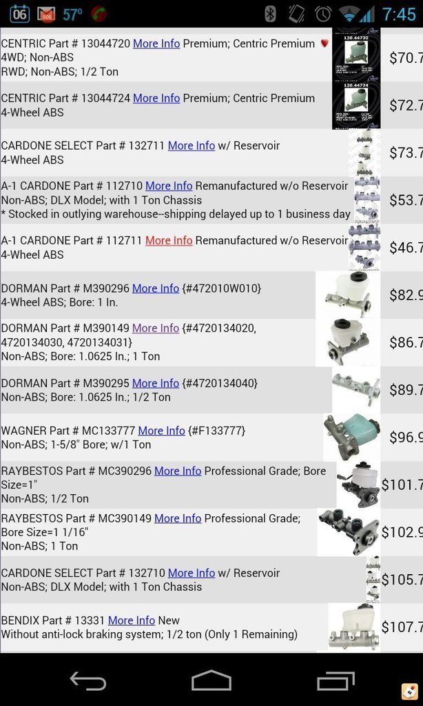

    ujyzara8_e811a7a7bb13e480de54e89d13146e1f48dee3e9.jpg is this the one u ordered?
    4720134020?
    I'm still set on getting this to work haha (a two year in the making dream) u take any other pics of your extender? I don't really understand.. May have to call u. And where did u find the t's to take out abs block?

    No pics taken. The stock pushrod is threaded into a piece inside the booster. Have someone hold the pedal down, grab the aluminum piece with a vise-grip, and unthread the stock pushrod. Thread new one in. You will end up removing the master a few times to adjust the pushrod length until its just right.
    Removed the entire abs pump. Running all new lines. Should be able to get a "t" from anywhere like Jegs or Summit.

    Oh, I got ya now did that look like the right part number from rock auto?
  18. Sep 6, 2013 at 7:14 AM
    #758
    NwiTACO
    NwiTACO [OP] Big tars, little/no bed.
    May 19, 2009
    #17416
    4,428
    Mark
    Indiana
    05 TRD Sport
    Custom Everything, 1 Ton Axles F & R
    My part number from Rockauto was CENTRIC 13044722.
    I wanted a new one, not reman, and I wanted the Resivoir on it since I don't know if mine would fit it. Low Fluid level plugs right in to the new master as well :D
    And don't forget to use a discount code to save another 5% Enter this in the how did you hear about us box: 869598ED3303

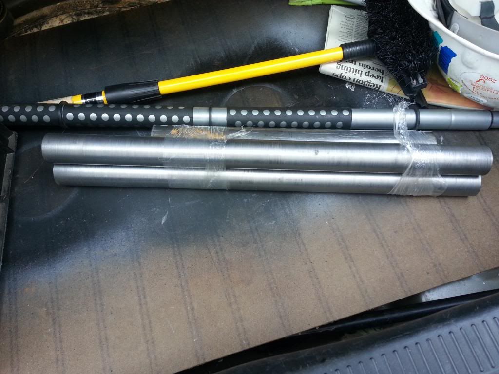

    Got my inner sleeves ready for my lowers. Dropped them off at a machine shop to have them turned down to a snug fit into my 2" DOM lowers.

    is that solid bar stock :eek:
