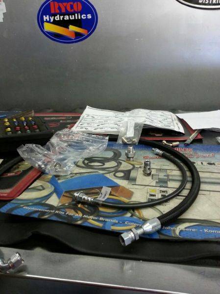

    Got a surprise at the hose store too

    They surprised you with 42s?

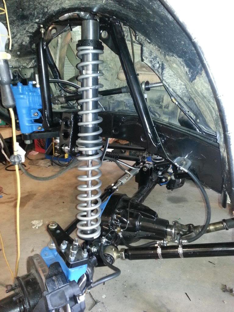

    Got the brake lines wrapped up. Wish I would have went with one lone hose from the frame to the "t" fitting but oh well.
    All hoses clip into factory style retainers with clips as well.

    maybe i'm missing something, but is that not what you did? i only see the one break line :notsure:

    I ran a hose from frame to link, then a hose from link to the axle housing.

    oh, i see what you mean. i thought you were saying you ran two hoses from the frame to the axle, and got slightly confused. so would have rather run a single piece of soft line to the T? just to avoid the hose clamp mounts?

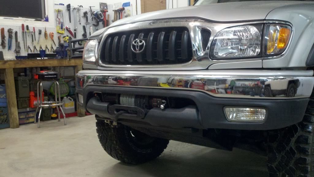

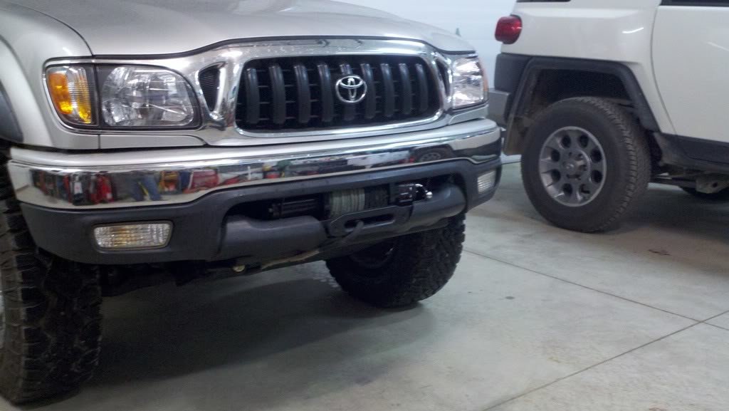

    Hello NwiTaco,
    I saw your customer feedback on the HF winch mounting plate. I'm also from NWI (Crown Point). I'm overseas right now and haven't even seen my 02 4wd TRD/OR yet. My son did the leg work to buy it for me. I've been researching MANY hours on winch/mounting options. I'm wanting to keep the weight and cost down and keep the original bumper. Is there a durable way to do a hidden mount without buying the Curt front mount hitch? Do you mount winches? What would that cost? Thanks, Goose.

    Yeah I have a buddy that just did this to his 1st gen, so I could do it similar to his. I will try to find a few pics and post them here for you. Really its just metal and I can do just about anything with it.
    Depending on what you want to do with your truck in the end, you may want to consider a new bumper altogether, as the stock one severely limits approach angle.
    Either way you want to go, I can get you squared away. Most people tell me I work too cheap, but its really hard to get an idea on price until I take a look at what it would involve.

    For GOOSE.:
    Not my work, but an example of what it takes to accomplish this.
