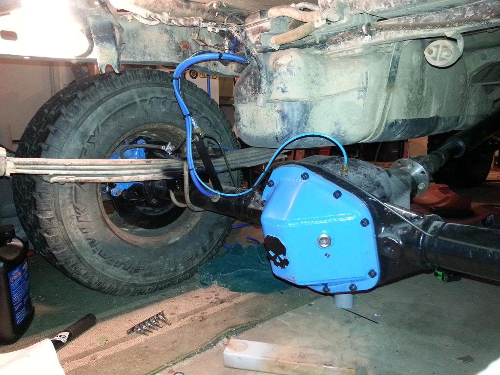

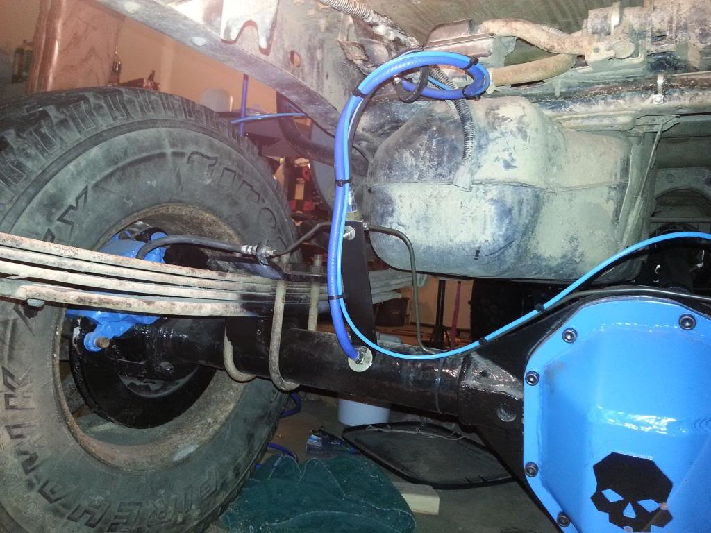

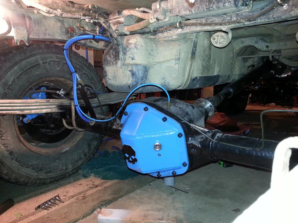

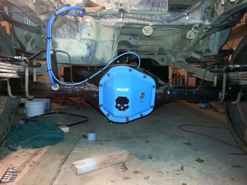

    Rear done besides shock tabs:

    What is the hose running into the axle housing?:confused:

    One is the arb air line, the 1/4" is the axle breather (vent)

    Ah! I knew what the ARB line was. I was confused on the breather. Guess I just assumed they were all on top of the pumpkin like on the factory axle. haha
