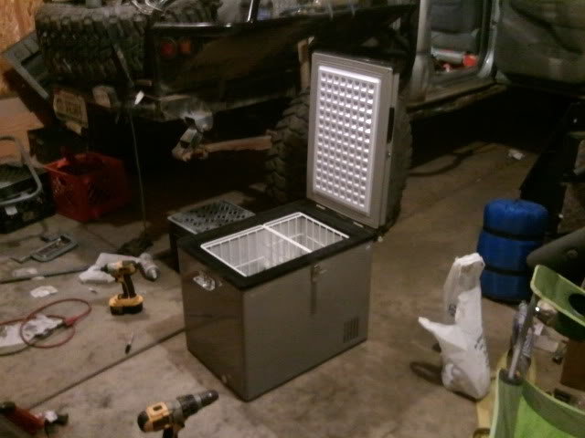

    Alrighty...time for an update. Last I left you guys I just built a tube bed/cage...
    The next issue was my wife and I had recently purchased an EdgeStar Fridge/Freeze vs. the ARB for cost reasons. The problem is this thing was large.
    When I say large mean it would take up half the back seat when in use. This wasn't working for me so I decided to do something about it.

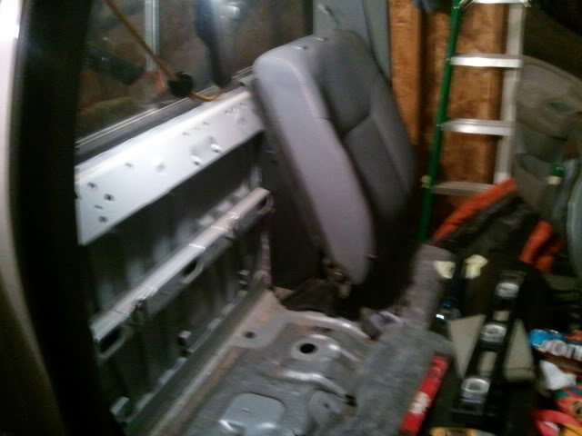

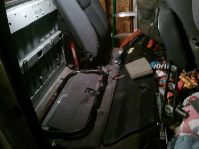

    First I removed the seat bottom, then the seat back, then the plastic crap taking up more room.
    Was left with something like this:

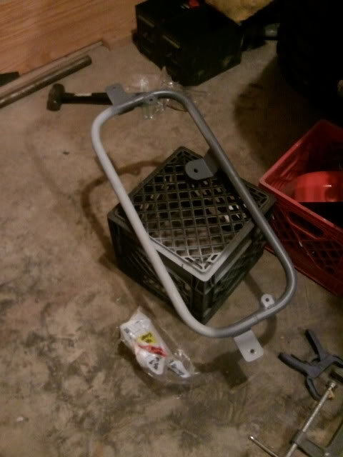

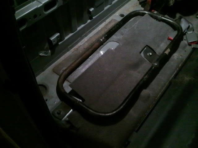

    So I made a rack to host some secure tie-down points:
    Bolt in to factory seat mounting locations:

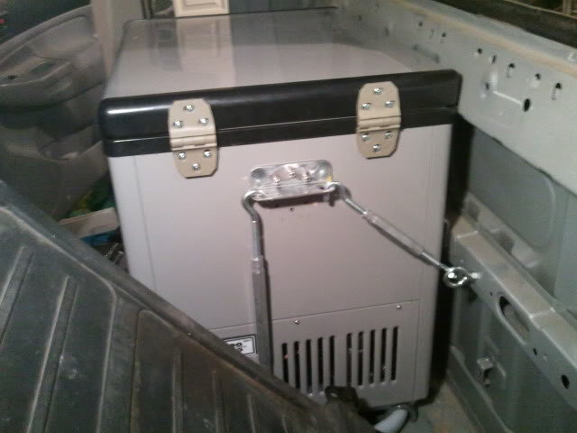

    Then reversed the hinges on the fride so I could tuck it closer to the back of the cab and not need room for the lid to clear when opened:

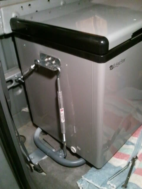

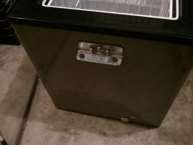

    Swapped out the handles for some brackets made of angle:

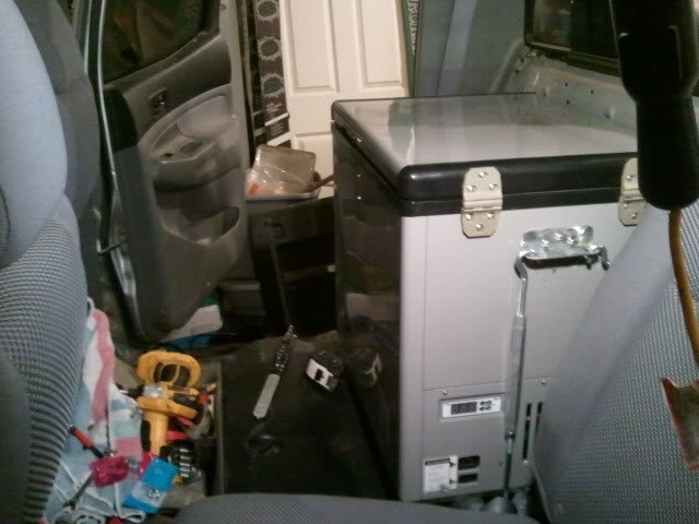

    Then mounted it in the truck:

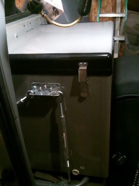

    Relocated the latch:

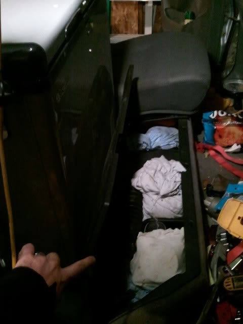

    Floor storage still works:
    All in all I gained tons of interior storage back by removing the seat and other crap.

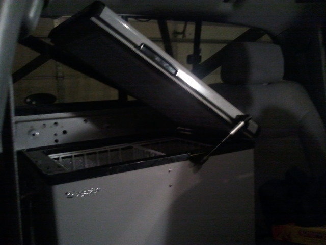

    Then executed project "no more holding the fridge open with one hand while you dig for shit in the fridge with the other!"
