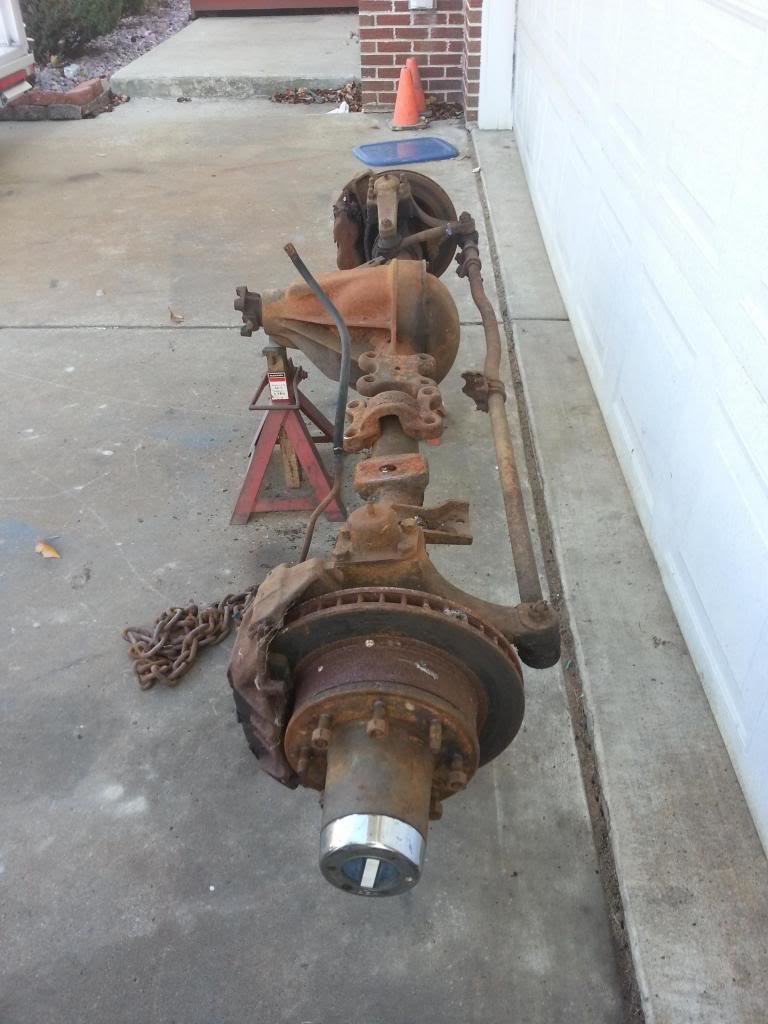

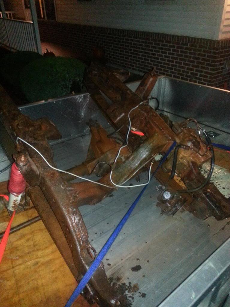

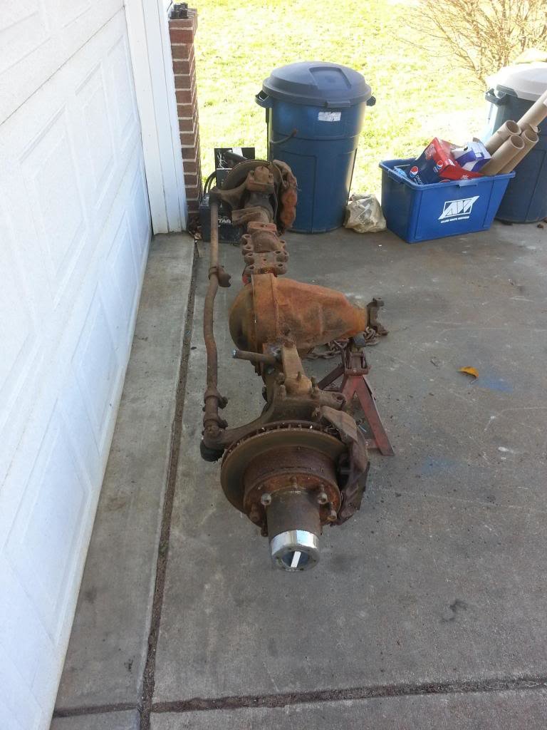

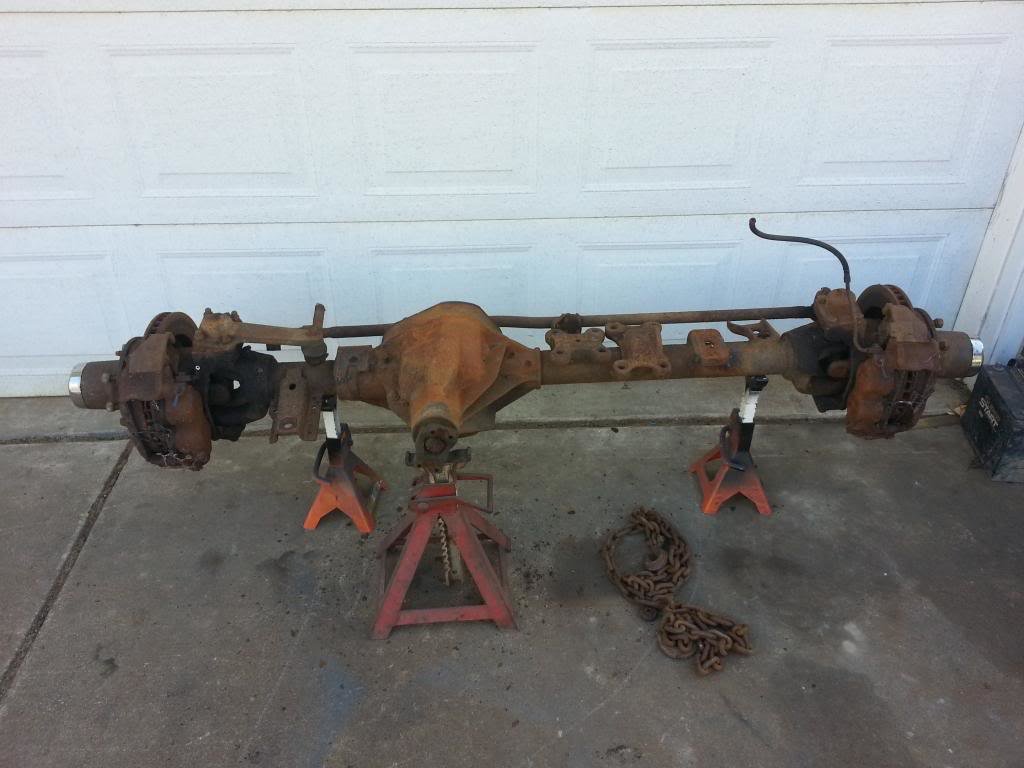

    Well 'twas a busy weekend. Started out Thursday night actually...
    After removing the extra 500 lbs of scrap I had this:
    Another of the ubber rare hard to find 1979 F350 D60 Kingpin axles :D
    4-link with rear steer? :D

    Jamie
    Alberta
    What's that axle for?!

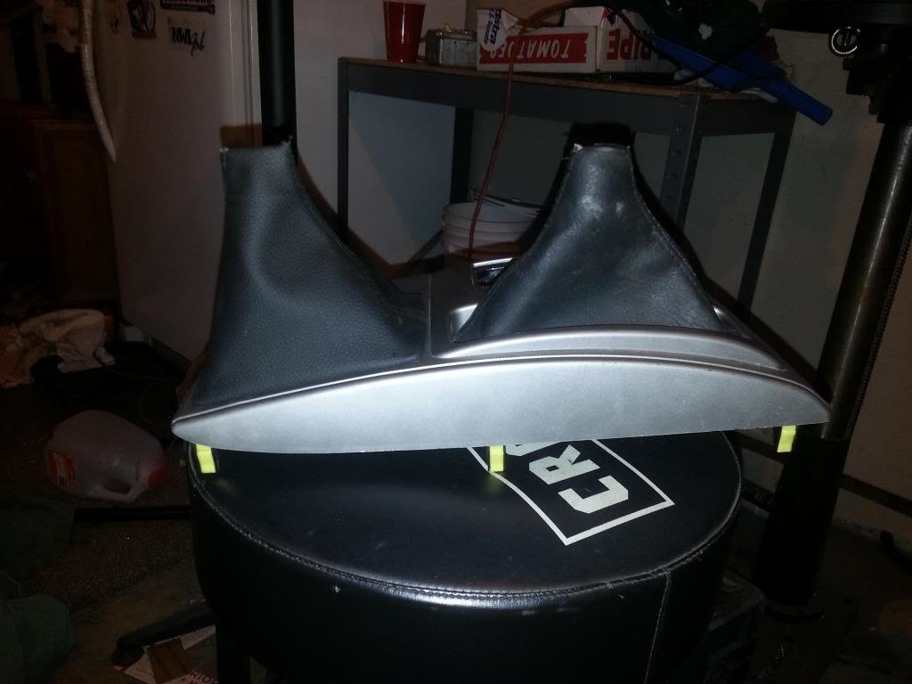

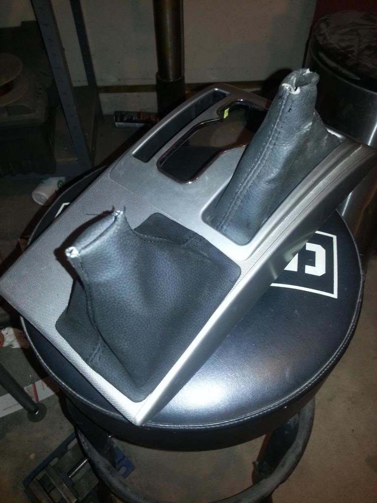

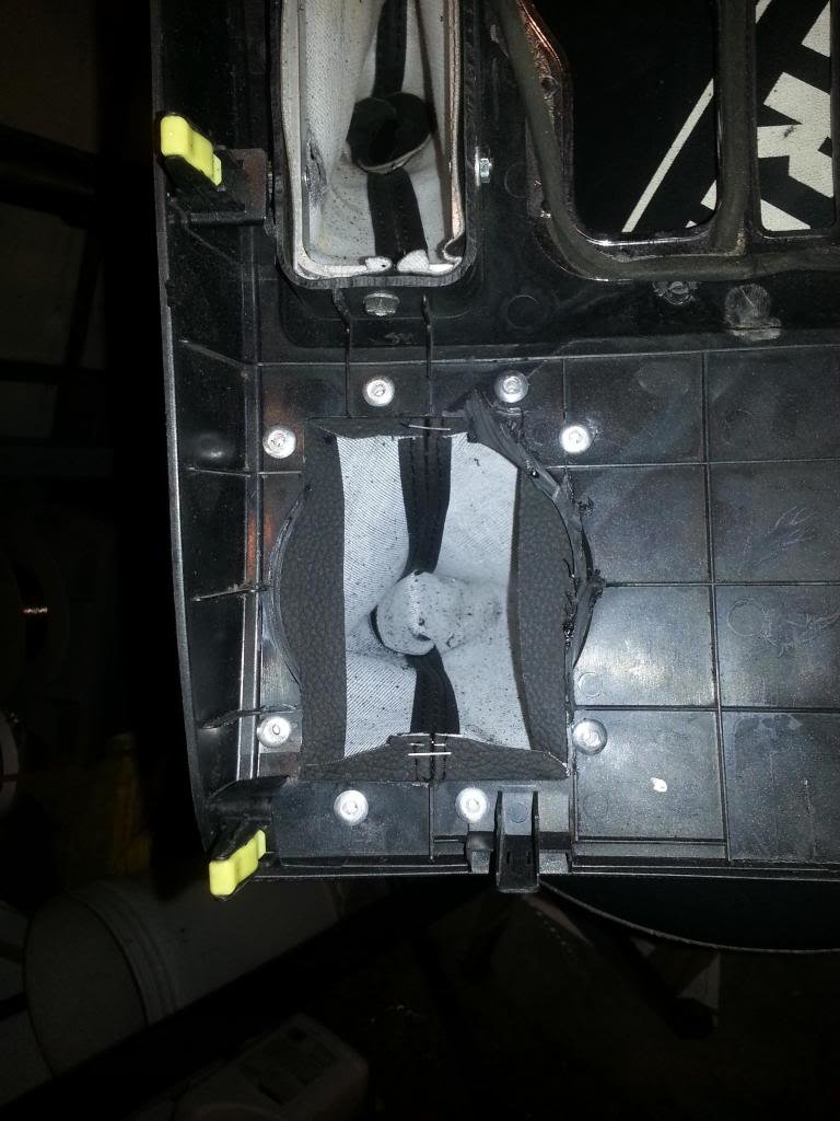

    Got a little done on my shifter boot last night. Cut out ended up being a little larger than just the cupholder though, so I had to come up with a different way of attaching the boot this time to still make it look nice.
    I ended up making a steel frame and putting it inside the boot, then wrapping the boot material underneath the frame, and riveting the frame to the top of the console, from underneath. Turned out good enough for me.
    Now I've just got to finish up the rubber boot at the transmission tunnel to seal out all the elements, and I'm done.
