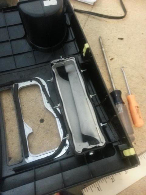

    Not sure what the console looks like. But by doing the boot like I did this one, you really don't need anywhere special, just cut a hole and add the boot mounted on top of any semi flat surface.

    Use the big cupholder on the right, and attach the boot like I ddi for the crawlbox shifter:
    If you got a boot with enough height to it, you could run a piece of it down between the cupholders too, attaching it the same way. Looks like that's about your best option.

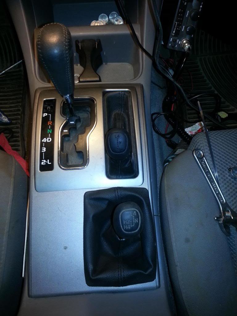

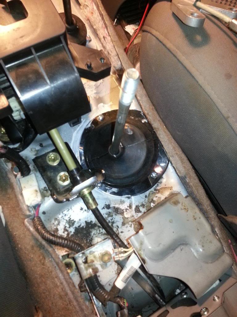

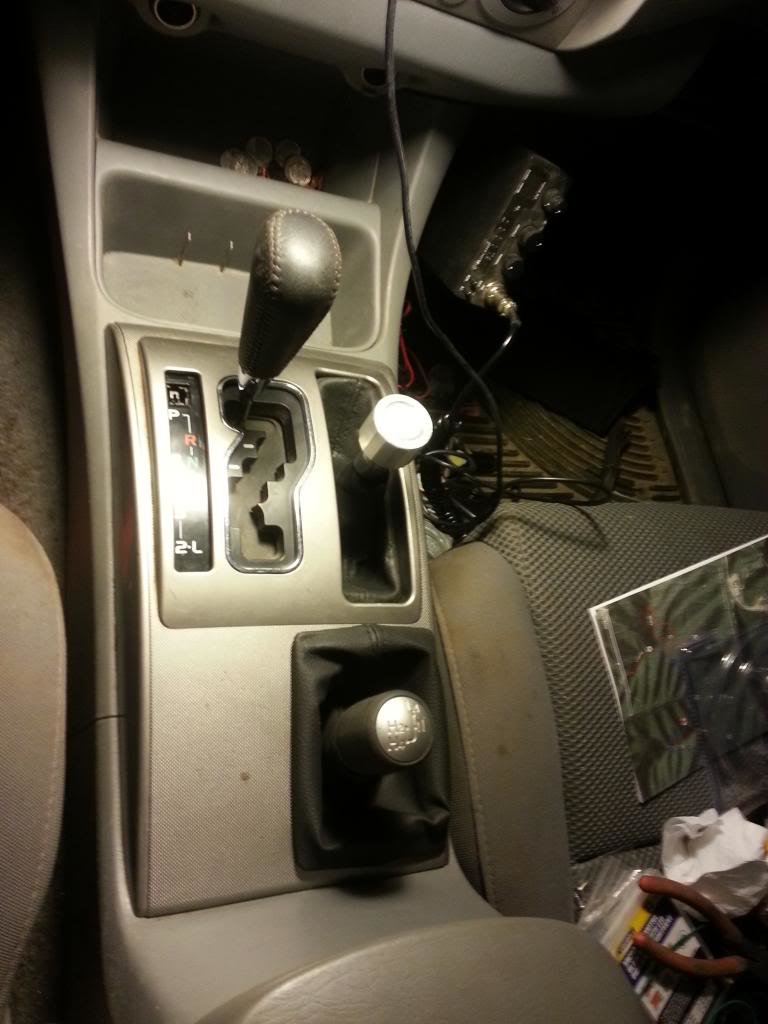

    Got the shifter all wrapped up on Saturday.
    Sealed up the tranny tunnel with a rubber boot from Jegs:
    With the inchworm knob on the crawlbox and the stock FJ knob on the FJcase:
    With the wife's Sequioa knob on the crawlbox and a stock yota j-shift on the FJcase:
    Also all dash lights work :D
    Don't know which way I want to go yet with the knobs...maybe I will get an inchworm j-shift and run the inchworm knobs...but I like the sleeper look of the yota knobs...

    I like the Toyota knobs but Eric thinks I should show off the bling...but the Sequoia looks awesome with an Inchworm Gear knob in it! :D

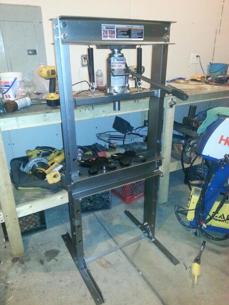

    New shop tool:
  17. Dec 4, 2013 at 7:10 AM
    #1077
    colinb17
    colinb17 If at first you don't succeed, don't try skydiving
    Jan 6, 2008
    #4127
    20,152
    Colin
    Charleston, SC
    '07 TRD Sport 4x4
    Build thread in sig... 4-link long travel
    i got the same press about 8 months ago when i was doing a wheel bearing. used it a number of times since. works like a champ. definitely one of HFs products that's actually worth being called well made.

    Back when I was doing IFS wheel bearings, I made a simple frame from some 2x2 and used a 12ton bottle jack as a press, but recently have had to do a few things that wouldn't fit in the frame.
    Plus...add a SWAG pressbrake kit and I can bend plate now :spy:
