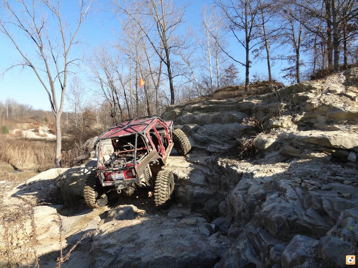

    no mods

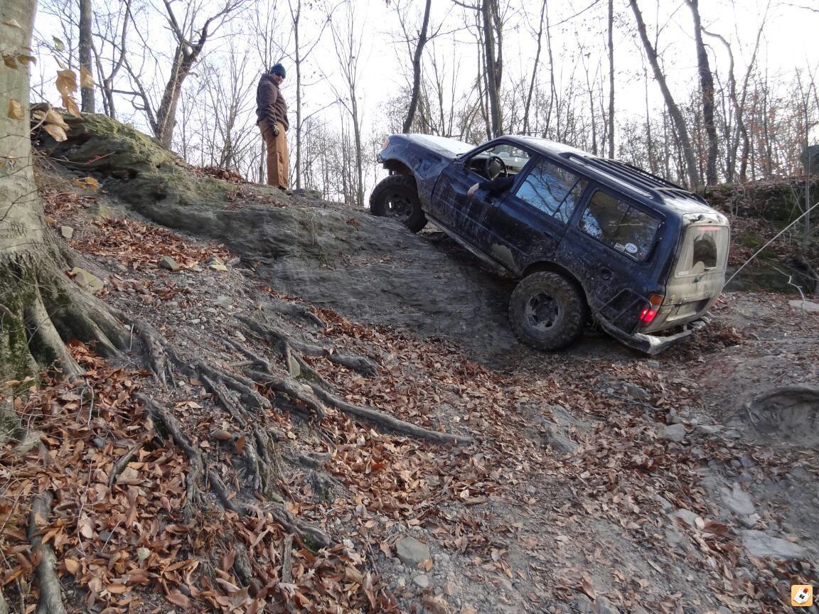

    Some stickers

    That jeep looks awesome as hell!
    Marks truck is alright too

    One hell of a trip!

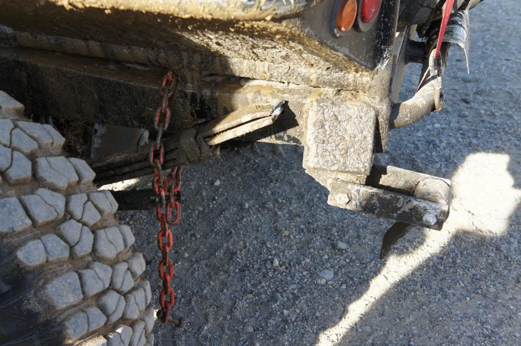

    any of you bring a welder on the trail?

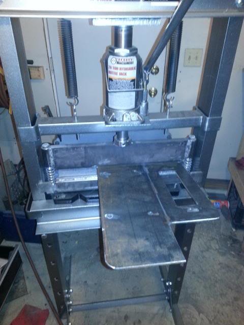

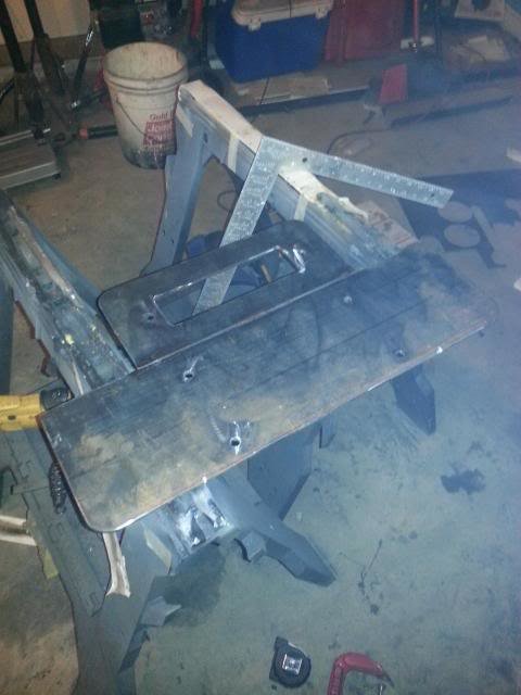

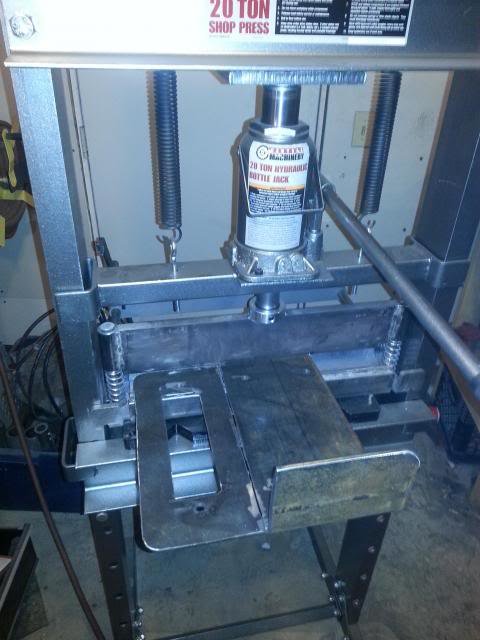

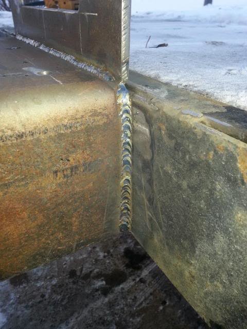

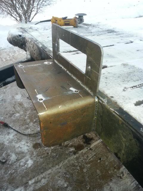

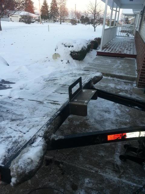

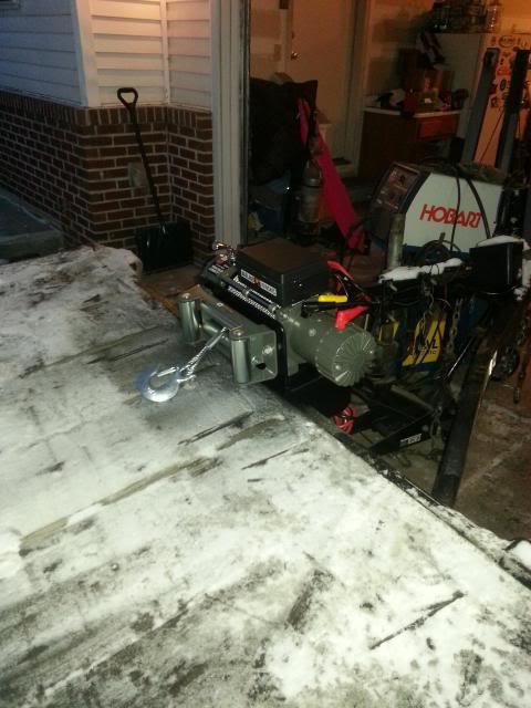

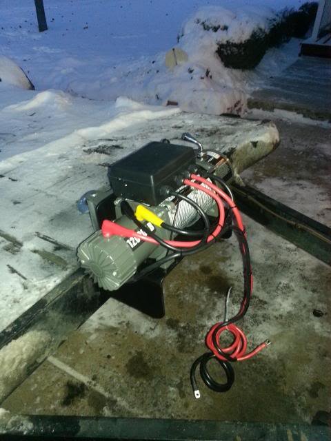

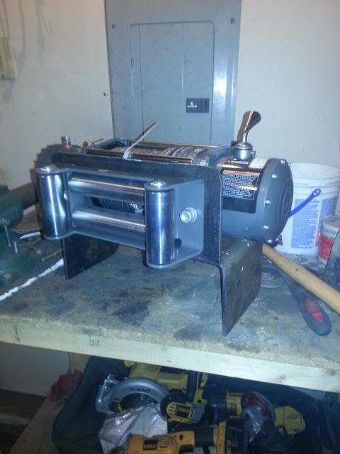

    Got the pressbrake all together and working...got a chance to give it a shot making a winch mount for the front of a trailer:
    Step 1. Cut some shit out of 1/4" plate and drill some holes in it:
    Step 2. Put it in the press:
    Step 3. Bend some shit:
    Step 4. See if it all worked:

    How's the Swag press brake? May be my next tool purchase.

    Not what ur thinking, lol. I like the pressbrake so far, but its not overly versatile.

    i bring an actual welder with me when i wheel. i was asking more because if any of yall had one, or did the battery trick, it would have been a fairly easy bandaid fix to get mark mark on the road home. just plate up the broken leaf and be on your way (cautoiusly)

    Way easier to just swap in another spring if its available. Otherwise using two batteries and some rod works fine for me.
