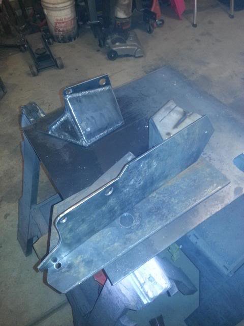

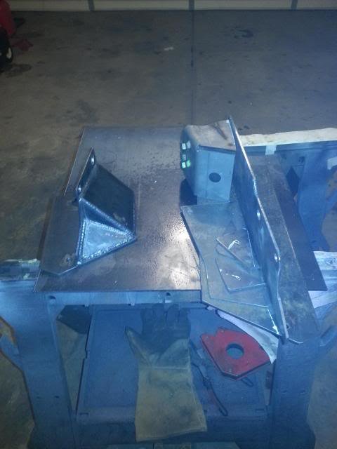

    Some bulletproof brackets coming together for Josh:

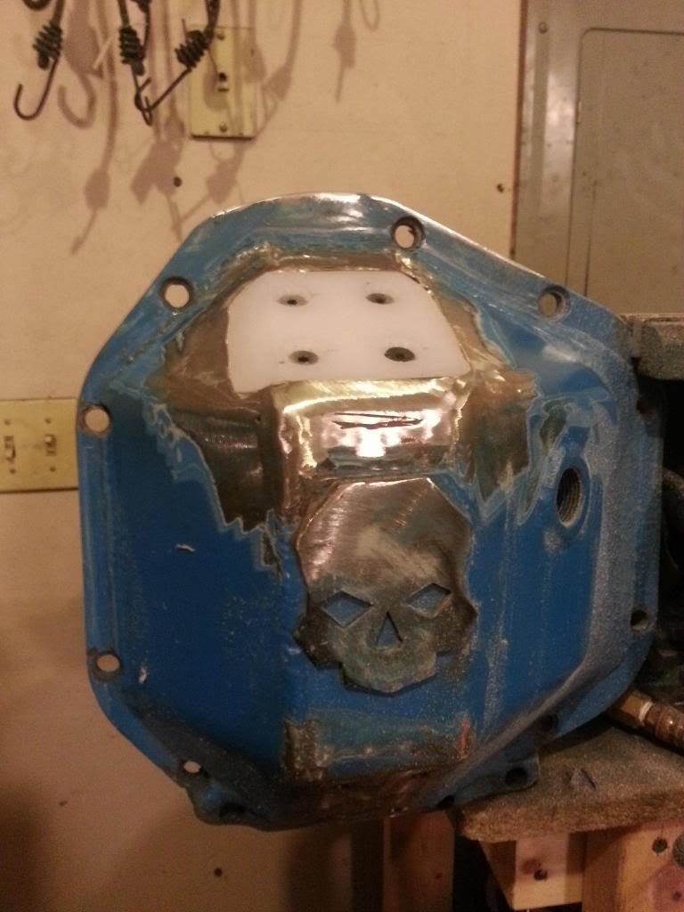

    Well the -13° temps are supposed to break by the weekend so I may get more time to spend in the garage.

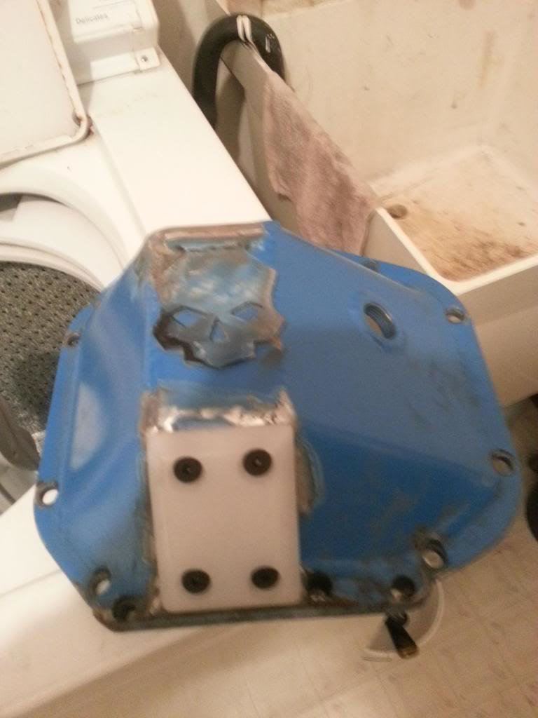

    In the meantime...I had gone on two runs now since the SAS, and the front diff cover is taking a beating. Looks like shit when scratched to hell and rusty, so trying to address this.
    Trying to help it slide a little easier on the rocks
    I am going to do something a little different on top of the cover where the ram connection to the tie-rod rubs the cover at times...stay tuned :D

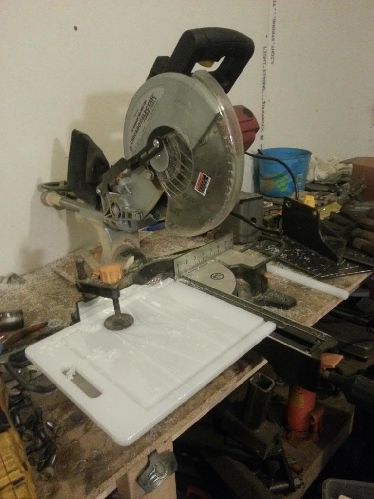

    Is that the same as the uhmw stuff or just a cheap fix? :D
    Does Jackie know??

    Wifey's gonna be pissed when she can't find the cutting board :rolleyes:
    you think the 4 bolts will hold up? both the heads themselves, and then resisting shearing off?

    Uhmw? Or is that a cutting board? Haha

    Yep we went out and bought a new one to cut up last night :D
    They are 1/4-28 Alloy Flat head Hex socket cap screws so they should hold up just fine. Also the head are countersunk and recessed 1/8" below the surface so they shouldn't get touched until it wears down quite a bit. Stronger than Grade 8 so I hope they don't shear off. :D
    Actually both. A UHMW cuttingboard :p You can tell by the feel of the material, but usually going by the price you can tell what you're getting. The $2 cutting boards will be just plastic most of the time. The $10 are usually UHMW.

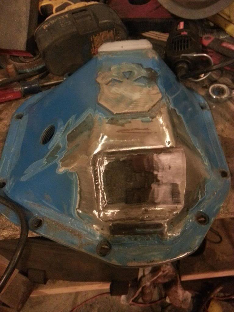

    Top of diff cover done.
    Cut out 3/8" plate and recess a piece of 1/8" making sure it clears the ring gear still.

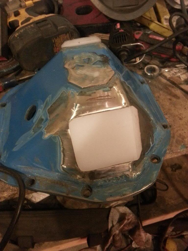

    Test fit some UHMW:
    Drill, countersink, tap:
    If you are confused as to why I did this...all will be revealed soon enough :D

    single bump stop off the diff cover! :goingcrazy:

    Not egg-Zachary...

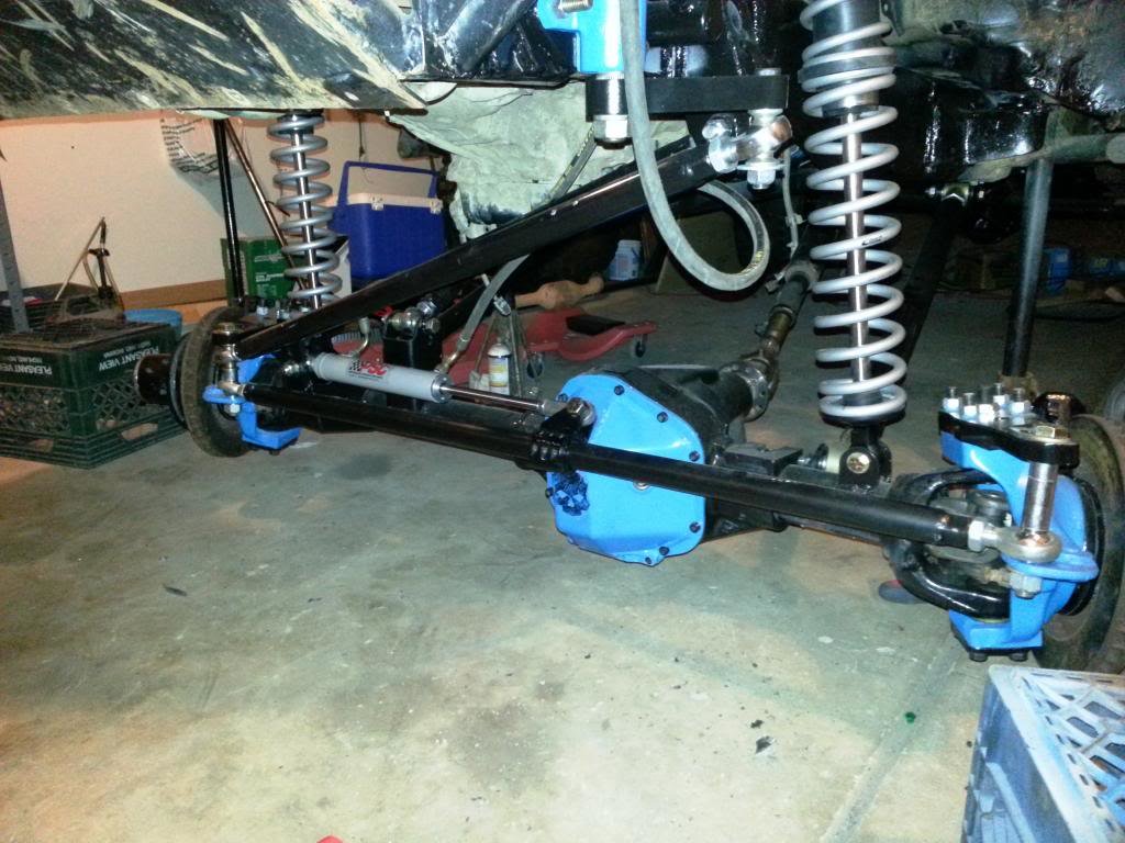

    In order to maximize my uptravel, the ram connection at the tie-rod is layed over toward the diff. Sometimes when I bump a rock etc with the tie-rod it rotates and scratches/gouges my diff cover.
    This should eliminate that and help it slide like butta :cool:
    Besides I had the cover off and wanted to customize it a tad before putting it back on so now its ready to go. Shot it in primer last night.

    this is in an effort to keep the steer ram paralelle to the tie rod, instead of rotating the clamp upward?

    Yep. Works best when parrallel, and wanted to keep everything low and tight to maximize uptravel. Worked fine as it was, but I want my stuff to keep looking Purdy this time.
