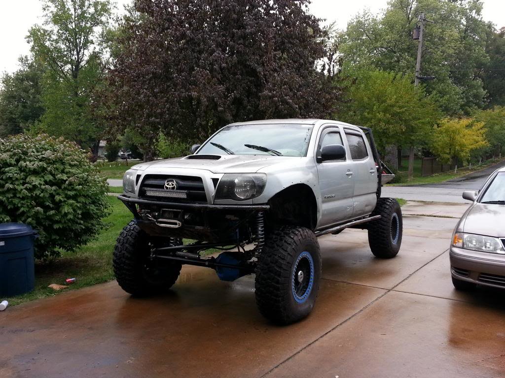

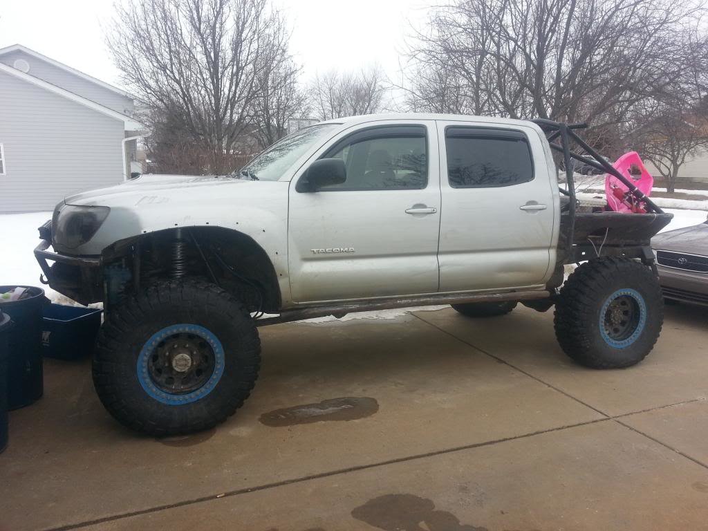

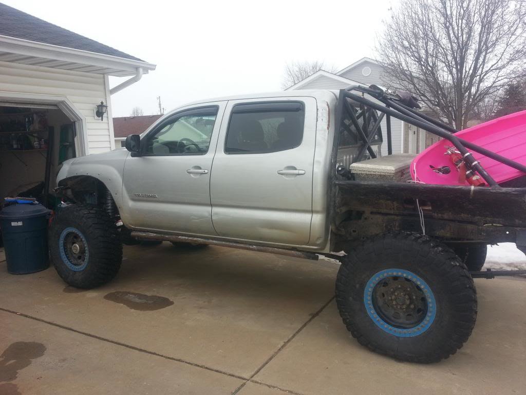

    OK here's a few I snapped the other night:
    Compared to:

    Huge difference. Didn't seem like it was that much when it was parked in the garage. :cool: Curious to see how the suspension does now. You gonna get bumps?

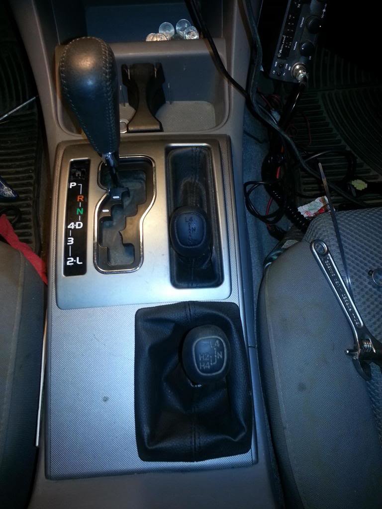

    Well, I don't know why (as far as usefulness), but I picked this up over the weekend...
    Got a deal on it. I will need to completely remake the shifters, but no biggee. Its not like the console was finished up already or anything...oh yeah its was :rolleyes:
