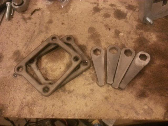

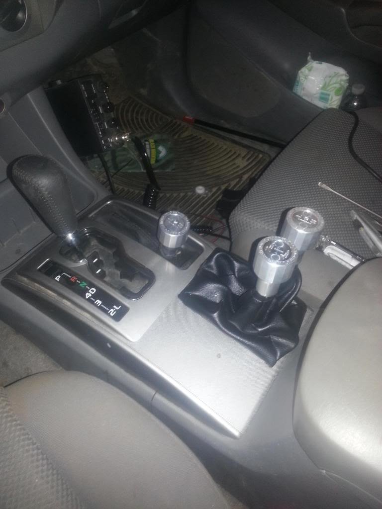

    Laser cut forks were perfect! Better be for the .005" tolerance I put on the hexagon for fitment :D
    Got one set for me, 3 sets going out Monday, and one set left...

    What are they for, mark?

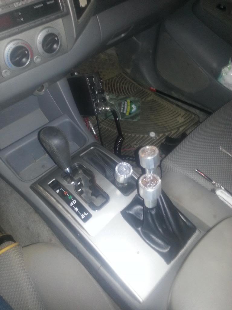

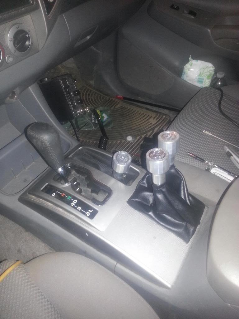

    Two-stage short throw shift kit for the Davez Offroad twin stick shifter :eek:
    Needed to reduce the throw so I didn't have to cut a bigger opening in the plastic console, as I had already cut back to the structure in all directions.
    Got the shifters done and paint is drying now. Finished pictars soon :D

    Turns the twin stick shifter into a short throw. :cool:
    On that note - I'll take the last set for mine. ;)

    Awesome work...
    Who do the cutting?

    Its yours. I can ship it Monday with the rest. You were just in time, these are going fast! I think I need to run another batch:eek:
    Some guy in MD from a machine shop. Great tolerances with a laser :cool:

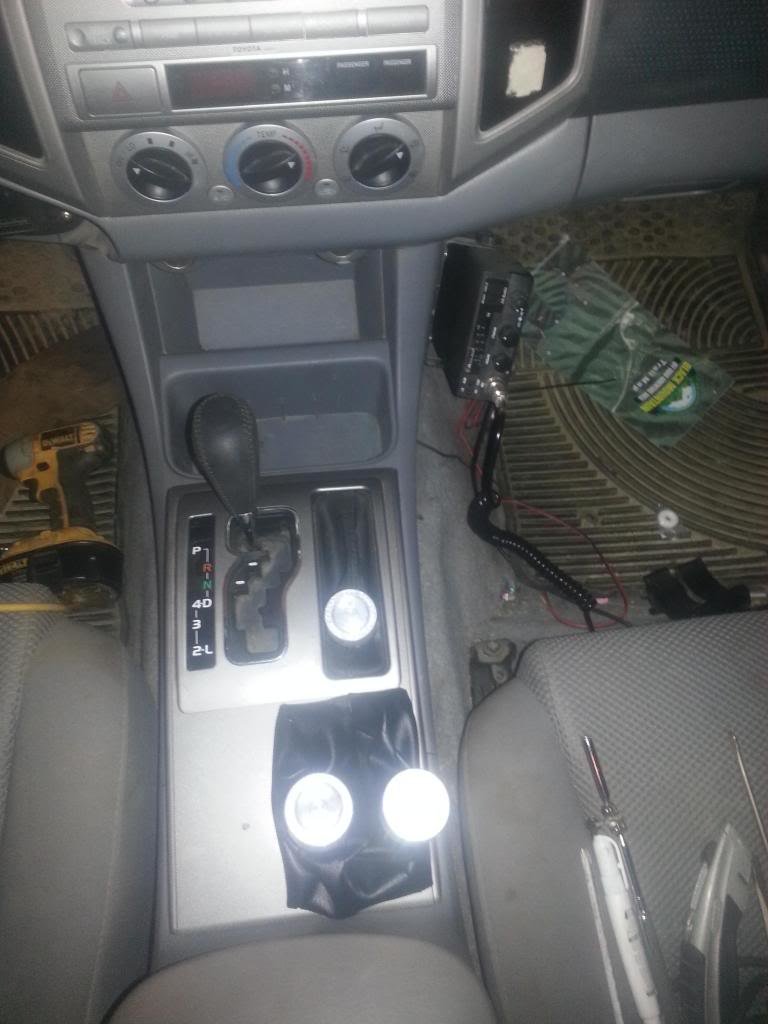

  10. Mar 15, 2014 at 6:37 PM
    #1250
    eborgie
    eborgie No Yotas Here
    Oct 18, 2007
    #3118
    3,660
    Erik
    Bellingham, MA
    2023 Bronco Sasquatch
    What shift knobs are those?

    Nice dude. Anodize those knobs black

    Inchworm gear billet knobs.
    That would be pretty slick...but I bet they would get hot in the summer!

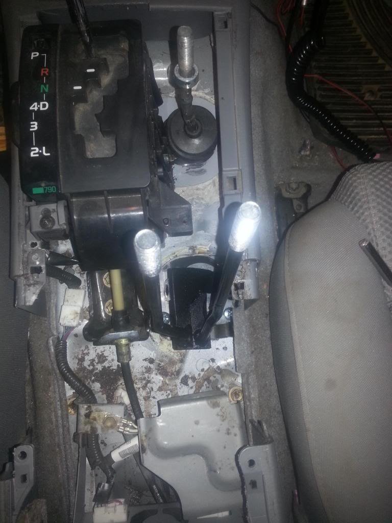

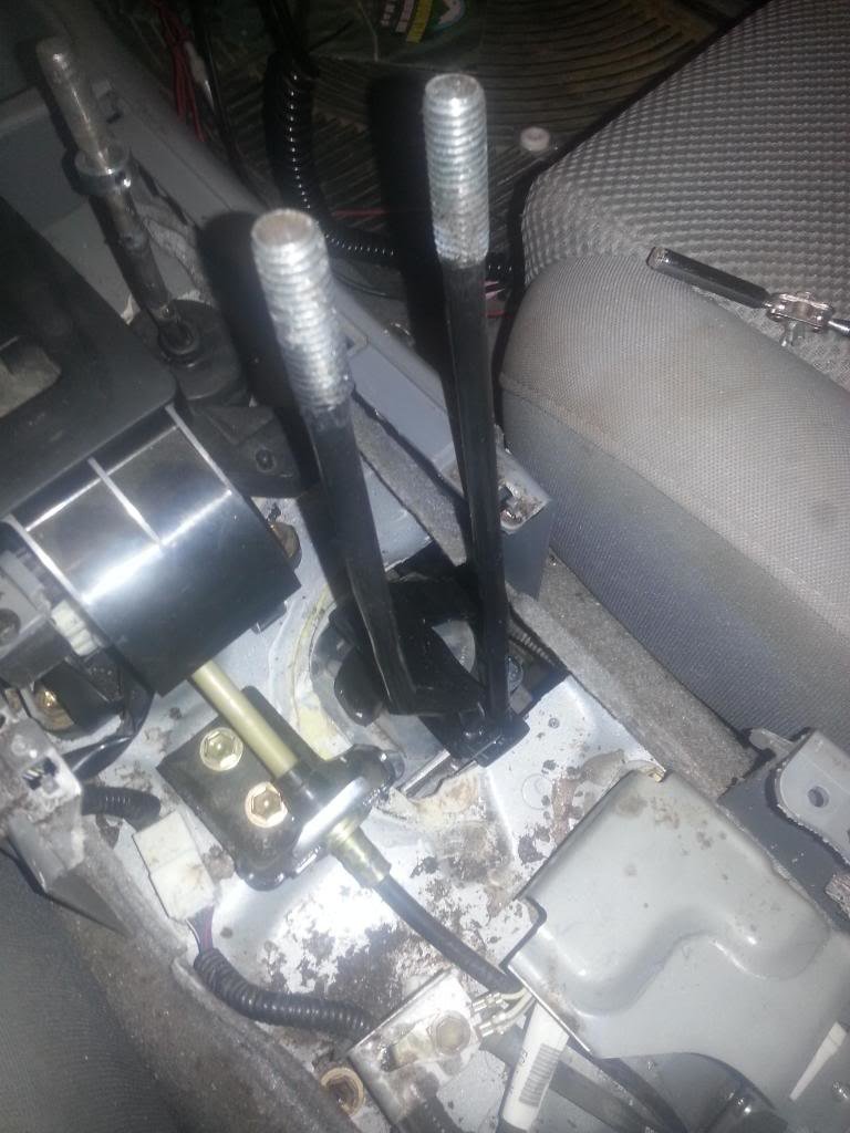

    Not sure if anyone caught it, but at the base the levers cross over each other. I did this to get the 2wd-4wd lever on the left, to keep the H-N-L lever for the t-case and the crawl box in line on the right :cool:
    Extra work but worth it!

    I was thinking that when you posted the previous pic of the setup prior to installation. Thats pretty fricken sweet! :bowdown:

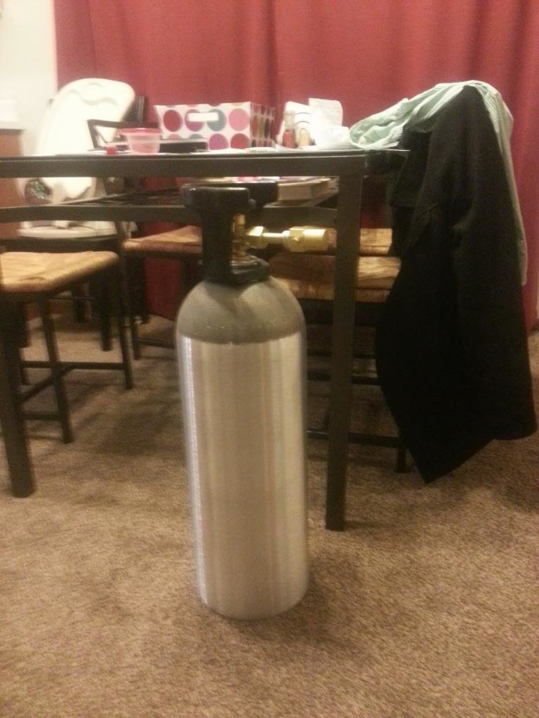

    20# Co2 Tank came in... little bigger than I thought lol :D
    And it doesn't fit in my power tank aluminum bracket either so I need a new bracket now. 20# tank is 8" diameter, 10# and 15# are 7" diameter. Anyone want a deal on an aluminum powertank bracket? $30 shipped for the $40 bracket!

    Possibly! Let me check to ensure mine is small enough... lol Any pics?
