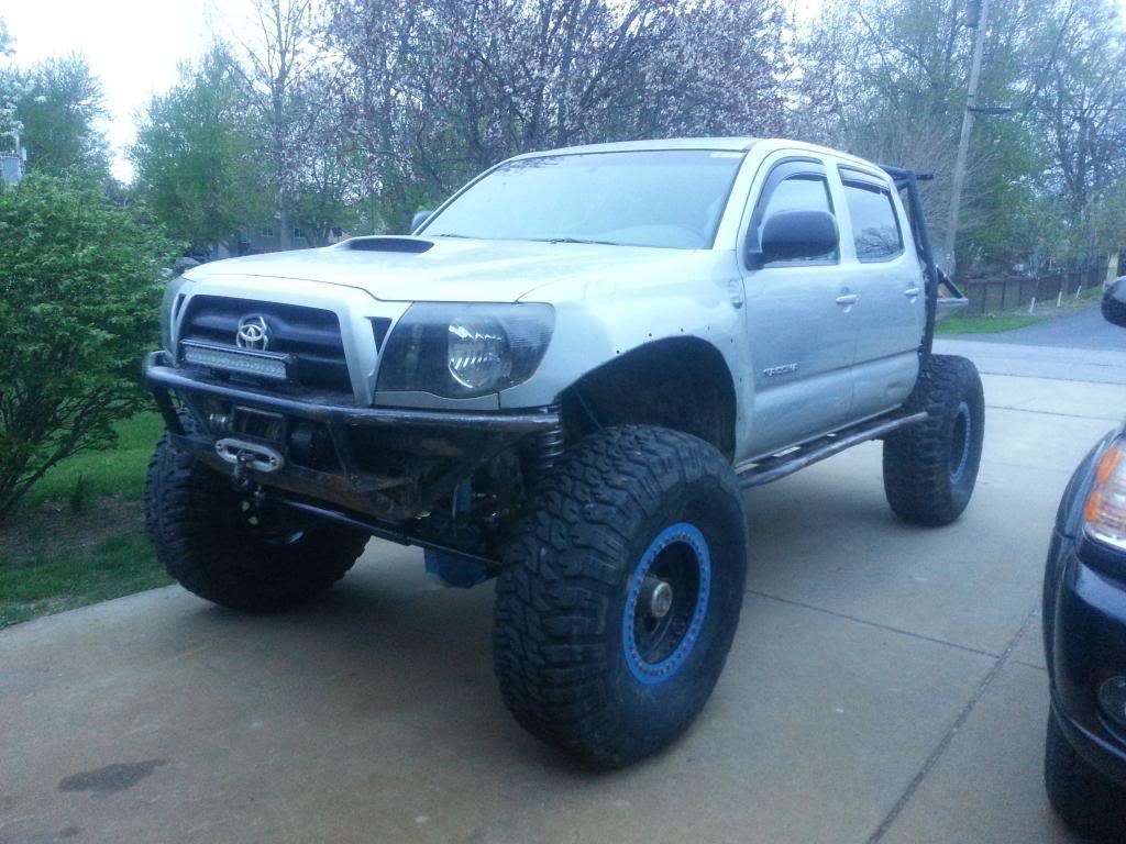

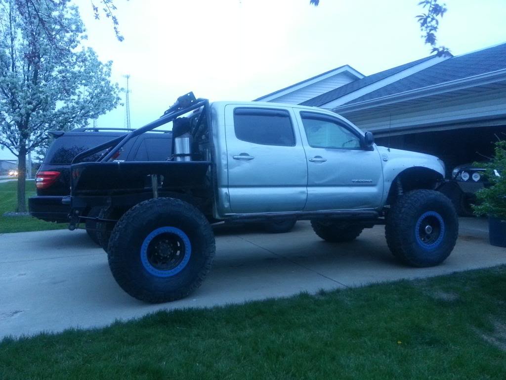

    On another note I finally got to take the truck for a drive with the 40's on it :D
    Nice and smooth all the way to 75 mph...rode nice! I have one slow leaker, so I must not have used enough bead sealer when I mounted it. Crap...39 bolts to remove and do it over! The DIY beadlock setup came for my spare yesterday too

    Need better pics on 40s! Ive been wanting to see this

    Tonight...I promise!
    It just looks right, no other way to describe it. However, after saying I would never go bigger than 40's...these just don't seem that much bigger than 37's now that they are on the truck and the 37's long gone :eek:

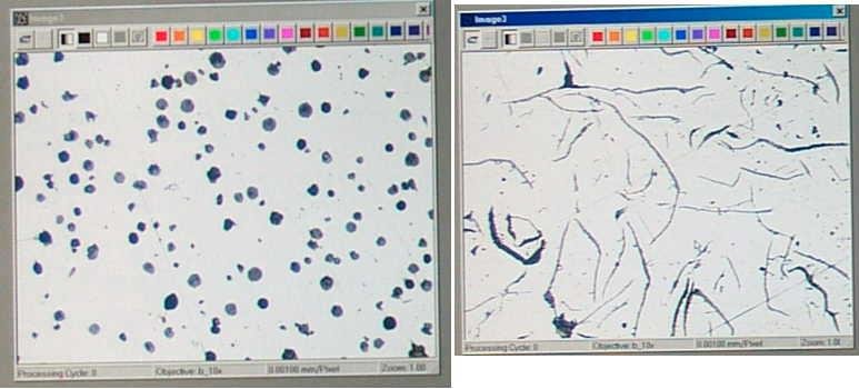

    I don't like playing devils advocate but the center sections on Dana axles are nodular or ductile iron, not cast steel. The grain structure of grey cast iron is what you want to stay away from or when it's more critical to pre/post heat and use proper wire/sticks. Feast your eyes...left is nodular or ductile iron and right is grey cast iron.

    You are correct. I didn't want to get that far into things here,lol. Nodular welds more like steel than grey iron does.
    Typically cast iron refers to grey cast, which really shouldn't be welded for a repair unless its the only option, and then proper technique, pre/post heat, and proper filler material are of utmost importance.

    Just for you, peaches.
    And frame height:

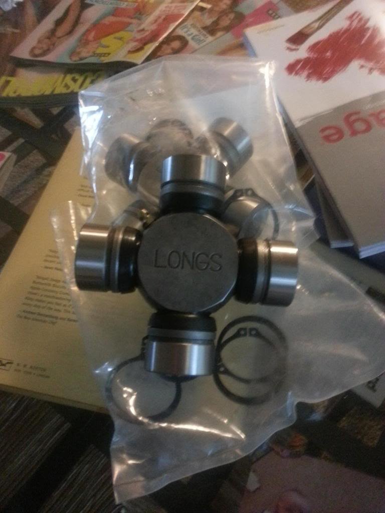

    Look what showed up yesterday :D
