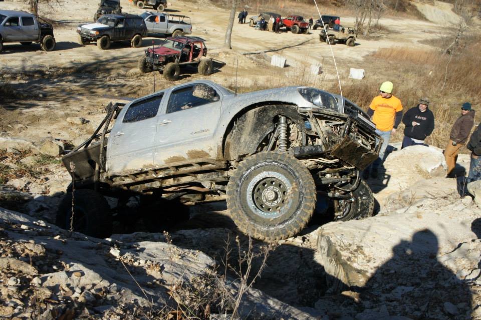

    I did come across this picture from wheeling last year, I don't know if I ever posted it. This was the where I broke my drivers side rear leaf spring.

    Hey I remember that day. I'm so glad you found someone nice enough to give you a spare leaf spring!! That would of been a shitty day if it weren't for that extremely nice person! :D

    Nah... some extra bailing wire and duct tape, and he'd have been good to go.

    No wonder it broke, that shackle angle is terrible :p

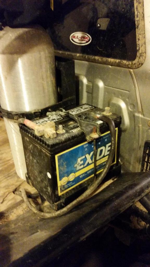

    Well after several more wheeling trips (2 over 1000 miles :D) there were a couple issues that popped up.

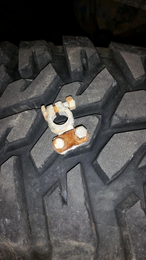

    When I relocated the battery years ago to the bed, I used a cheap ass clamping terminal for the 2/0 ground cable I used.
    Last time I was out the truck died and I had to get a tug out of a pretty precarious spot, and it ended up being a bad ground. So when I got home I soldered a lug on to the cable and used the stud terminal on the battery. This will all change eventually when I do a new battery setup, but for now it works.

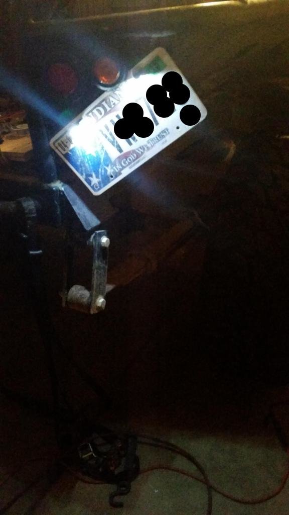

    I have also been driving around with no license plate lights so I ordered some of these from SuperBrightLEDS:
    Mounted up:

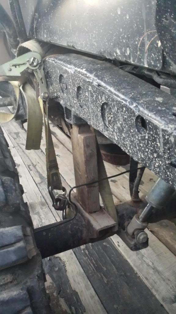

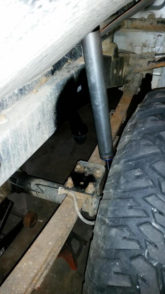

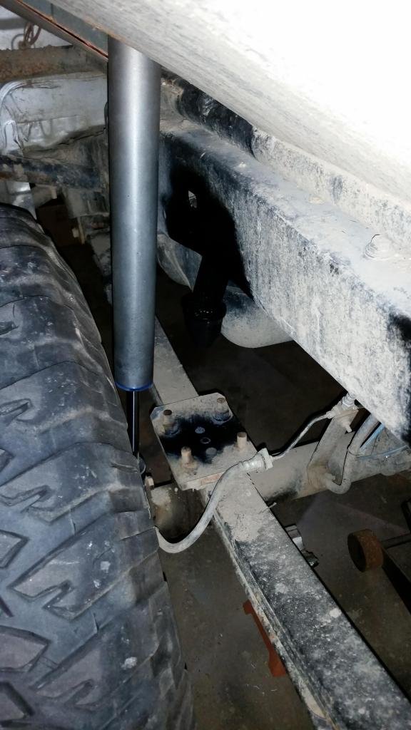

    I also never got around to installing rear bumpstops and thus blew out a rear shock again last trip. Got some used Fox's to replace the 7100's and had them rebuilt and revalved by DSM. Installed them last night and added bumpstops as well.
    20140825_221717_zpsd5c81b04_385498731b111dd7e7a0ece6468c896b221231de.jpg 20140825_221707_zpsc7479034_252ac8d72679e82cde21a663a200fda5b6ea16b8.jpg

    Someone shot up your tag... :(

    Ordered new springs for the front last week too. I went with a 14"-200# over a 16"-250#. I should be putting those on tomorrow, should be perfect this time around.
    Original:
    225#/300# = 128#/in combined rate
    -wasn't able to get my ride height where I wanted and maintain preload
    Attempt #2
    125#/300# = 88.23#/in combined rate
    -ride height perfect, but the upper spring is almost bound at just ride height and the transition once I hit the slider stop is rough (lower rate to high)
    Attempt #3
    200#/250# = 111#/in combined rate
    I am hoping for a touch firmer ride on the roads at the lower ride height, and the upper spring should maintain more free length at ride height, and should be a noticeable but gentler transition when I hit the slider stop.
