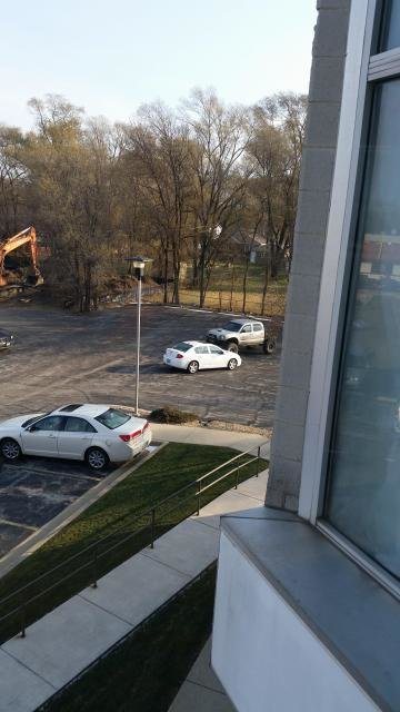

    Haven't touched the truck since I wheeled a month or so ago. Checked the truck last night and the battery was dead. Got it in the garage and straightened the tie rod a bit. Since I haven't driven it in a while I figured I would take it to work today :D
    Sure looks small down there.
    So after work I will start my mini-work-and-play adventure lol.

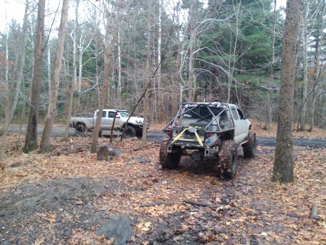

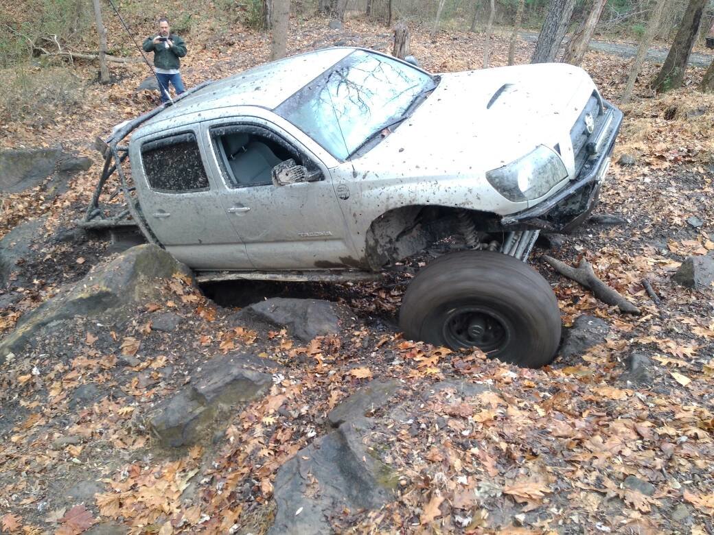

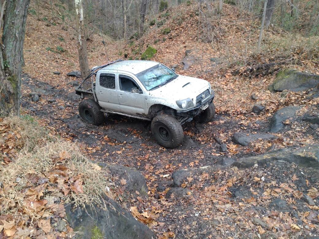

    Some pictures from today

    GET IT MARK!

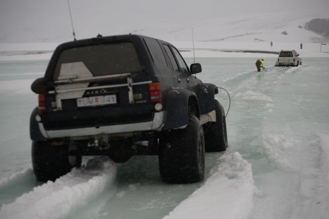

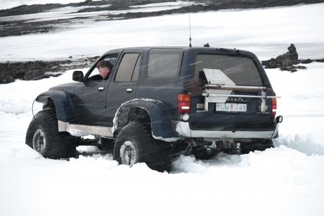

    Also met an interesting fellow recently. My work has put me in touch with him. Long and short of things he has a SAS'd 4runner built for his local terrain:D
    Best part is I may get to go for a ride when I am in Iceland next year!
    Not exactly my style, but you build for what terrain you have, and I certainly can appreciate all the work that went into this thing. And yes that an auto inflation system on the tyres.
    Some of his friends (FJ40 and Hilux):

    LOL
    auto inflation system? how does that work? have a swivel of some sort?
    interesting.

    Those arctic rigs are sweet. :cool:
    I'm not all about the balloon tires but you mod for what you wheel right? :)

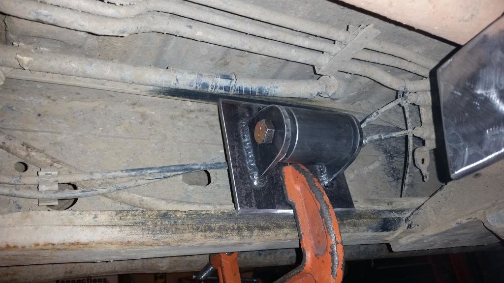

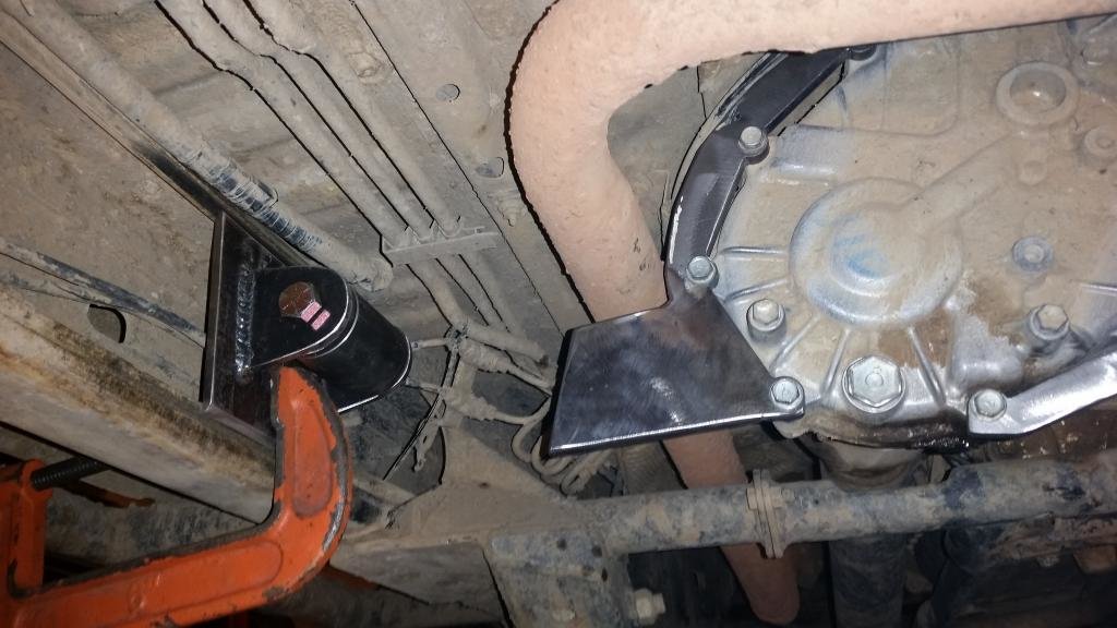

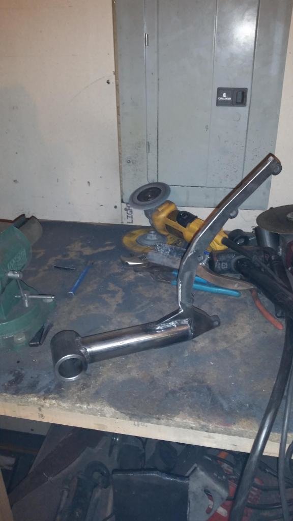

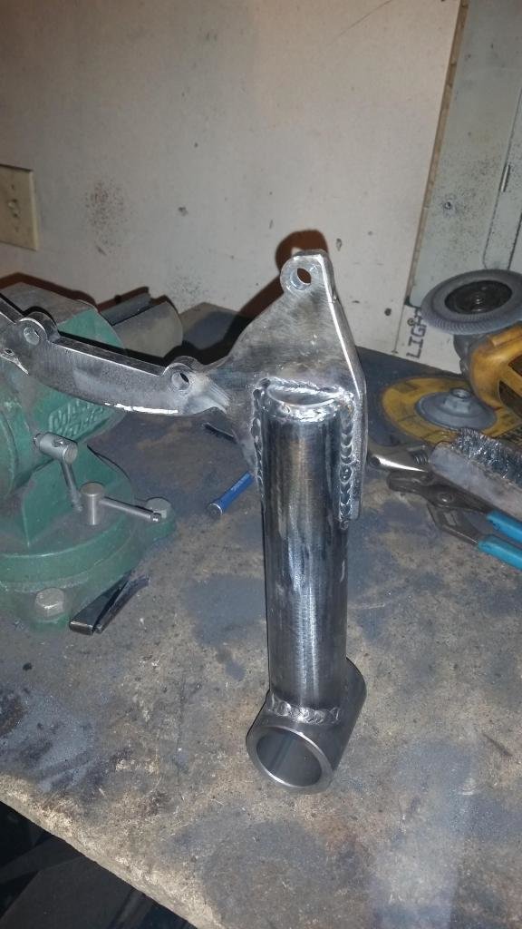

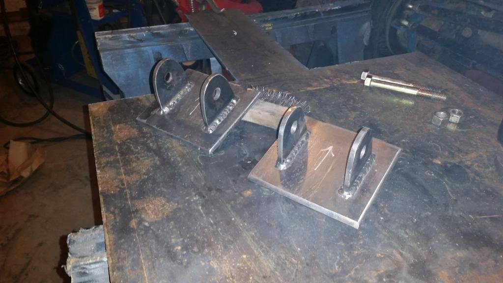

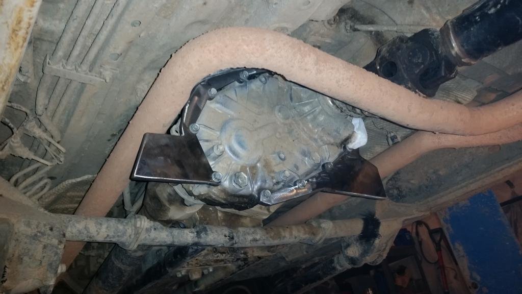

    Started with a FROR Tacoma case mount plate, added some more material to connect to.
    Made a pair of these:
    Looked like this:
    The frame is two layers of C-channel, so I made my plates a little small so the weld would bond all three together :cool:
    Looked like this:
    Then did the other side:
    Paints' drying then final install tonight :D

    that's sharp! :cool:

    surprised u went with that mount. Mainly since some people will say thats the most horrible mount ever and ur tcase is just ready to explode now
  20. Jan 2, 2015 at 5:43 PM
    #1580
    Supra TT
    Supra TT Supercharged Lifter
    Jan 3, 2011
    #48645
    7,226
    Eric
    Indiana
    2000 SAS D60 F/R Supercharged
    Supercharged on One Tons
    It is a secondary mount... His primary mount is still a custom made one with the 4x bushing mounts. The purpose of this mount is solely to stop extra rotation on the driveline causing so much movement the shifters are getting bent.
