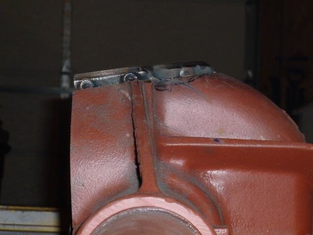

    So upon cleaning up the front axle and knuckles...I found this:
    Look closer:
    So I did this:
    1/4" Gussets cut out with my plasma:
    Gussets were MIG'd after a 400°F Pre-heat :
    And then were post heated and slow cooled afterwards for about 3 hrs. :D

    Forgive my ignorance, but is the preheating due to the knuckle being cast? In any event, looks good!

    Yes, they are cast nodular iron. Behaves more like cast steel than cast iron, but the preheating reduces the stresses induced from localized heating/cooling, preventing cracking of the casting.

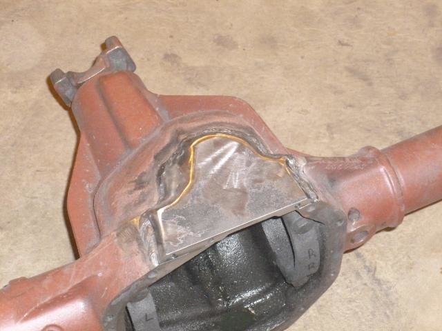

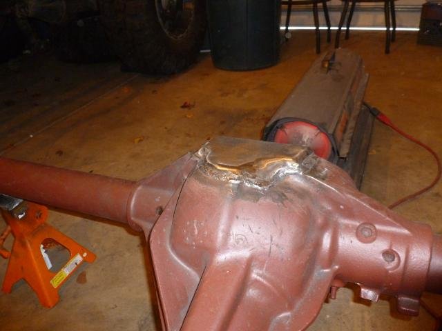

    Well I had some help this weekend (Thanks SupraTT) so I was able to get quite a bit done...
    Getting the housing ready:
    Shaving it:
    Preheating with the torpedo heater:

    Done. Preheated to approx 400°F and welded up with the MIG set very hot. Couple passes peening each one, very similar to what I did on my knuckles.

    Badass. Axle looks bent in that one pic...probably isn't but appears to be

    It's definitely the shitty camera man :eek:
