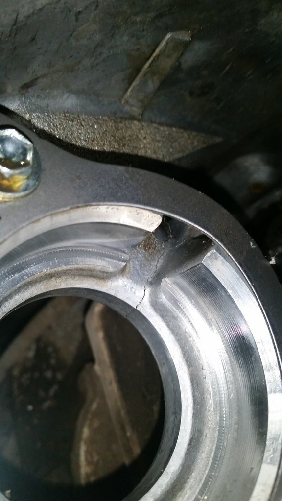

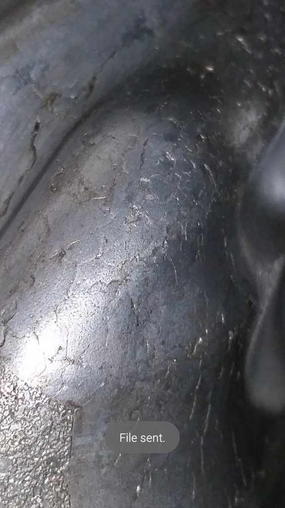

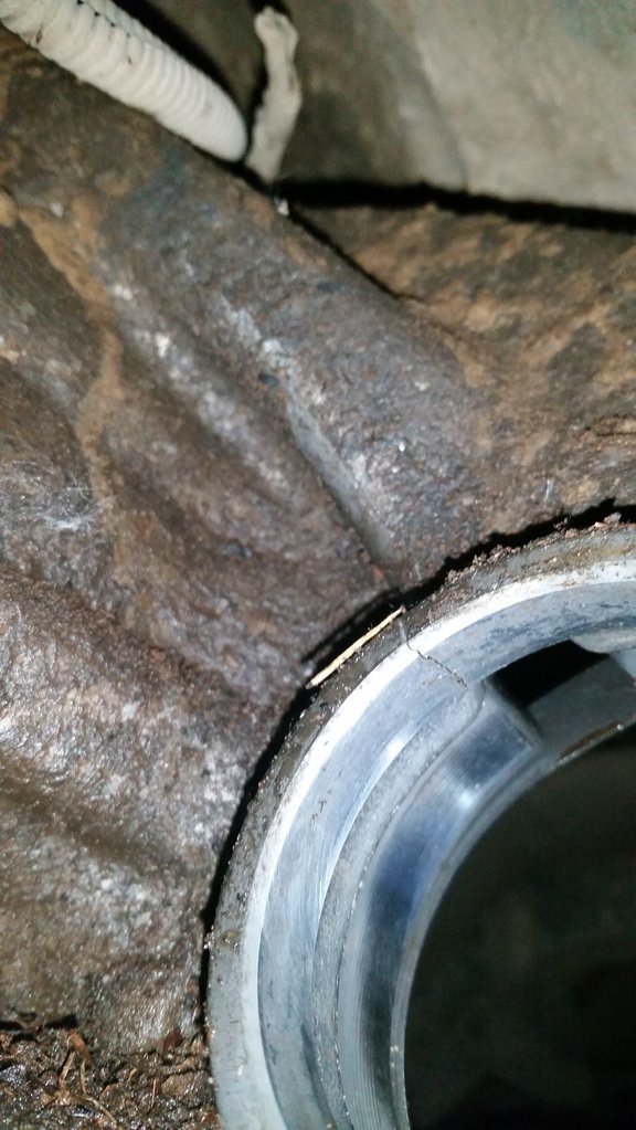

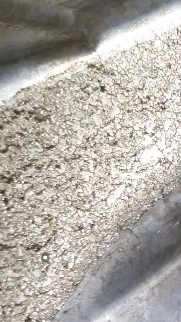

    Well last week I decided to dig into my slightly loose and always leaky front output on my FJ case. I pulled the driveshafts, the output unit on the t-case, and then the back half of the t-case. This allowed me to remove the front output shaft and bearings, and I immediately saw the culprit. I have a crack in my t-case, it goes right through the oiling groove and through the bearing pocket. This is undoubtedly the cause of both.
    Now the fun part...when I got this case shipped to me from a salvage yard, I couldnt help but notice the bad surface condition of the cast aluminum housing vs the one from my taco. It appeared almost porous, not a nice smooth casting. Having spent $100 in shipping already, I figured, it had to pass Toyota QC to make it into an FJ so it should be fine. Well folks, I will state for the record this case cracked because of a poor casting. It appears as if the AL was too cool when injected in the mold. I zoomed in on surrounding areas inside the case to show just exactly what I mean...
    These are the areas to the upper right and immediate left of the crack area in the second pic (zoomed in)
    Screenshot_2015-08-10-10-26-56_zps7ydcdq_177f33e472514b9b7c073e5a6cfe7424d279ef62.jpg
    Screenshot_2015-08-10-10-27-38_zpsqul982_10534e7ba01ecce27eaa3320e4d55b7d96ef48ee.jpg
    You can see porosity in the casting, and micro-cracks in the casting as well.
    Now I need another FJ case and have to twin stick that one anf swap them out. PITA. I was really hoping for bad bearings on the output causing movement and leaky seal :(
    Sure wish I could warranty what is clearly a mfg defect case.

    I'm pretty sure all the castings looks like that. Wish my J-shift tcases would fit your truck, I have like 3 spares in the garage now. I seem to bring one back every time I go to Denver. :anonymous:

    My taco case was smooth inside and out :notsure: Maybe this was the last one out of the ladle or min temp I dunno.

    May be a stupid idea, but do you think I could add material to certain areas (like around the front and rear outputs) of the tcase to reinforce it? Should be getting a TIG welder in a few days...
